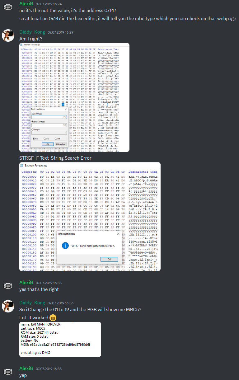

Hello, I need your help. I have some Roms on my flashcard which don't work. A simple workaround would be to change the MBC1 to MBC5.
Unfortunately I have no idea how this works.

Basically, while the Game Boy only directly supports game cards with up to 32 kB of ROM (in red and grey) (plus optionally 8 kB of RAM, in green), all interactions between console and gamecard are ultimately (attempts to) read or write one of these areas, so clever people back in the NES days (if not earlier) thought of adding more electronics to allow sliding these 32+8K windows over larger capacities, usually by accepting writes to ROM addresses (that would normally do nothing) and interpreting them - and these are called mappers!
Since they're not part of the console itself, there can be a pretty much unlimited number of different mappers (although luckily for emulator/flashcard/replica developers, in practice less than 10 designs have been used, unlike the hundreds on the NES!)
So, remembering that the goal of a mapper is to make the right data accessible in the right address at the right time (for example with a "write 4 to 0x1000 to make 4*0x4000 accessible at 0x4000"), converting to a different mapper would mean finding all those actions and converting them to the appropriate new type (for example with a "write 8 to 0x23A1 to make 8*0x2000 accessible at 0x4000"), but a simple find/replace of the corresponding machine code is probably unsuitable, because not only a match could accidentally happen in non-program data (like graphics/audio/level design), but also because due to indirect addressing modes, you cannot look at a single memory access instruction and necessarily know where it's pointing at...
With the help of a real topic related expert I learned how to patch and hack the games correctly.
You were absolutely right. The number of values to change are completely different. Some games had a maximum of 5 values to change and others like Kid Icarus had a minimum of 50.
My DMG-01 now starts these games.
