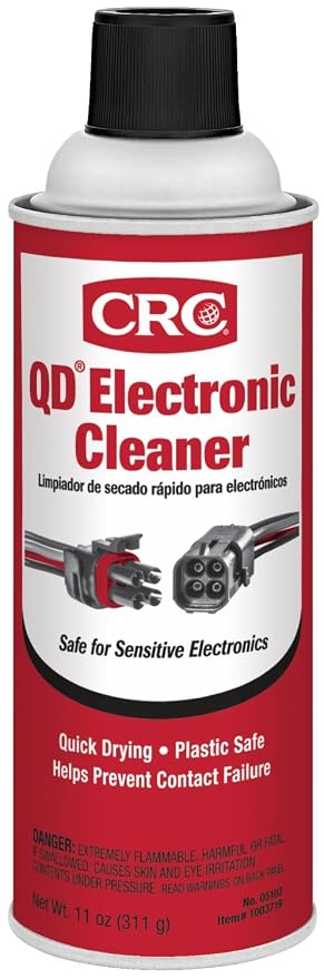

Hanafuda Well-Known Member Member Level 16 Joined Nov 21, 2005 Messages 4,029 Trophies 2 XP 5,866 Country Feb 22, 2019 #2 I'd use electronics cleaner. You can get it at walmart, or on amazon. I also use this stuff to clean the microswitches on GBA-SP/DS/3DS shoulder buttons when they start fritzing.

Hanafuda Well-Known Member Member Level 16 Joined Nov 21, 2005 Messages 4,029 Trophies 2 XP 5,866 Country Feb 22, 2019 #4 Davidistheboss21 said: Awesome thanks so much!! Click to expand... Make sure you buy the regular cleaner spray, not the stuff that says, "with lubricant." The lubricated stuff has a light machine oil mixed in with the cleaner, intended for moving parts, not PCB's. Reactions: Davidistheboss21
