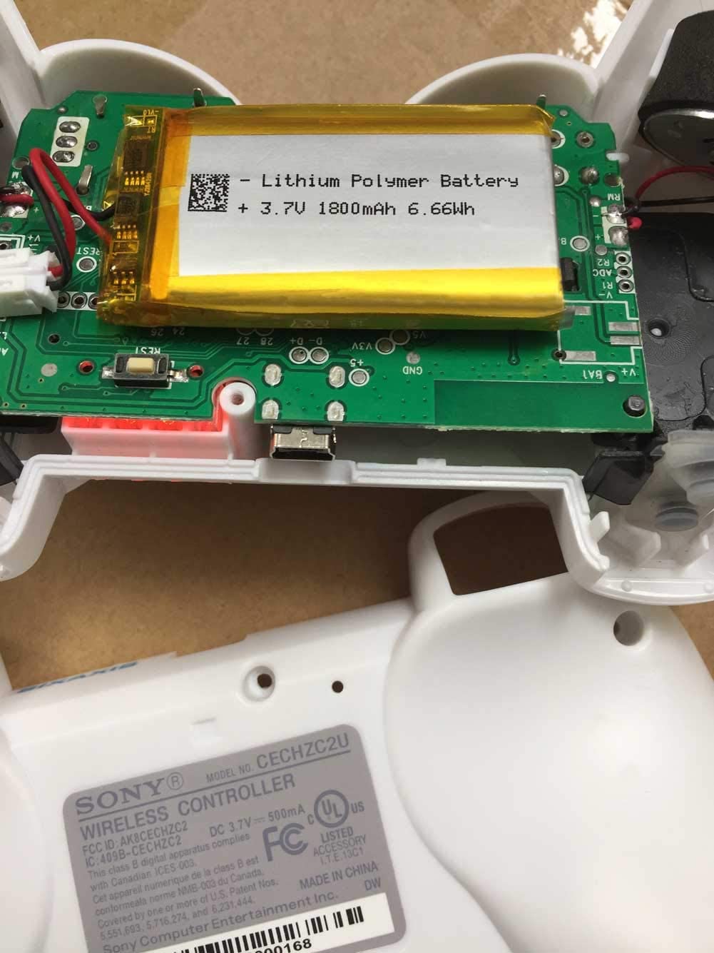

Battery Size: 603450
Battery Connector: 3.5mm or 4.5mm

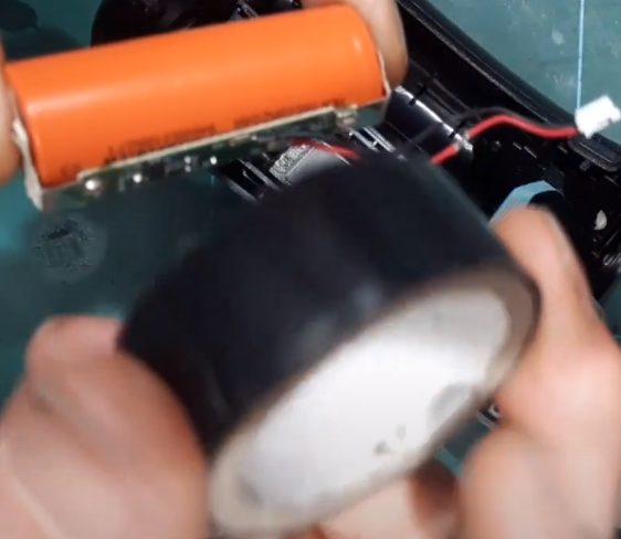

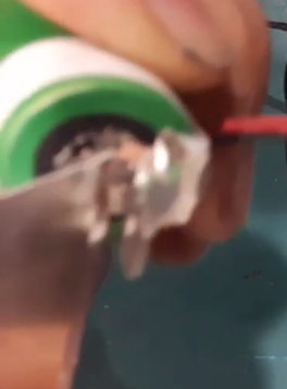

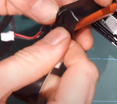

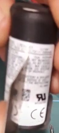

Battery Size: 18500 flat top + electrical tape
1. Cut open casing, remove
2. Pry off weld spots
3. Tape (+) and (-) to battery
