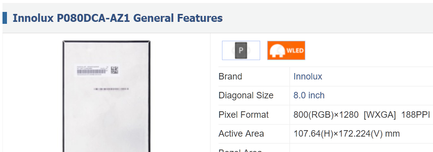

an example of an ORIGINAL panel:
you can see physically is 1280 * 800 so really desn't matter the physical pixels, count what signals the controller send to it.
