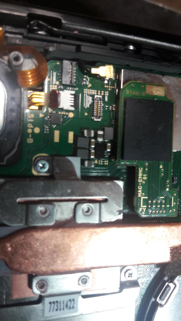

You have forgotten an important step, you must unlock the connector before removing the ribbon cable .
And don't use sharp tweezers.
