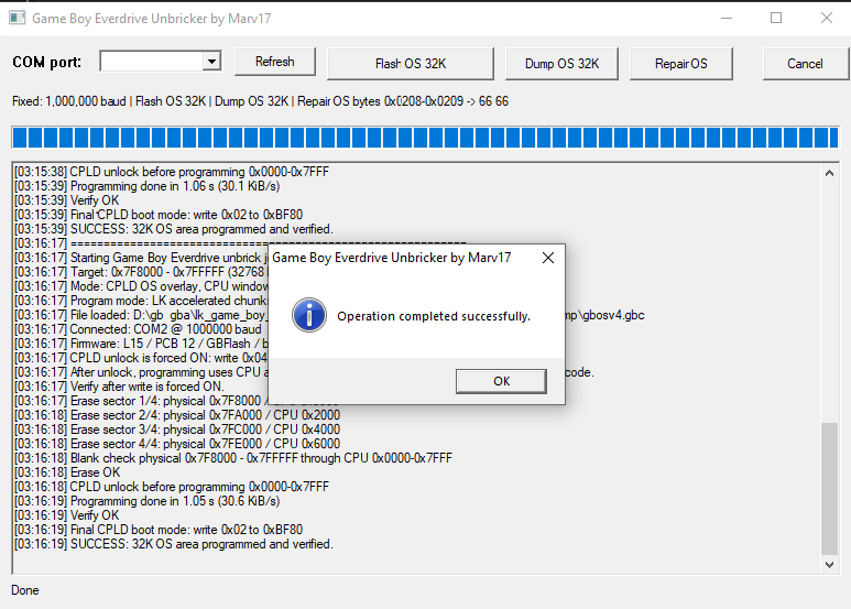

marv12345 was me , i recently make a tool for fix is in 2 sec with gb flash / joey jr / gbxcart with Lesserkuma firmware
its possible to dump os , restore another full os too , it work with all clone even old jack diy

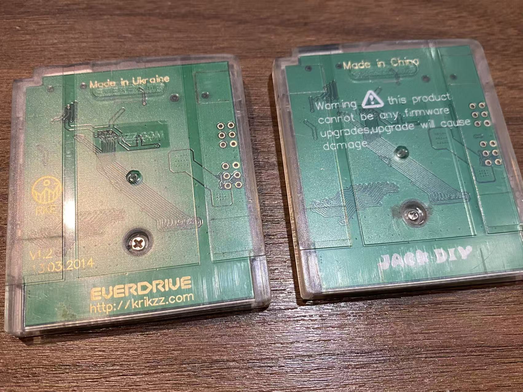

Same design as the original V1 EDGB flashcarts. These use an LDO regulator which doesn't cause the Game Boy to reset when hot-swapping cartridges, it's only the "low-power consumption" models that are affected; with the way these are designed, in terms of being switched-mode, these consume more power causing the console to reset automatically.
Here's a photo that shows what the board of the V1 looks like:
This, including the original Jack DIY clones, can be unbricked with this method, and many others which share this same design. Others on the other hand, cannot be unbricked via hot-swap, to which you need to desolder the flash chip and use an external programmer. If I had more time to fixate on classic Game Boys then I could think of a fix for later Chinese clones, but if you had bricked your own clone, and that you don't have a way to recover, then better be safe than sorry.
