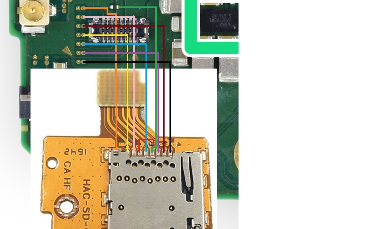

Sound like your SD card flex is damaged/missing pins, that why it is in one bit mode/slow mode.
Open your switch, reseat your SD card connector if you got a v1.

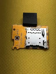

You need to open up your switch to check if you got a missing pin or not, if you got missing pin you need to replace the SD card flex,
This is what I got. My switch is old. The rail screw 1 side is stripped and the screwdriver I got wont unscrew it.
But I can get access to this and take it out but can't get any further into it.
It doesn't look like any of the pins are missing. Could be a bad sd card reader. Have you dropped the switch? I would try to put it back firmly and see if it is still in 1 bit mode.
