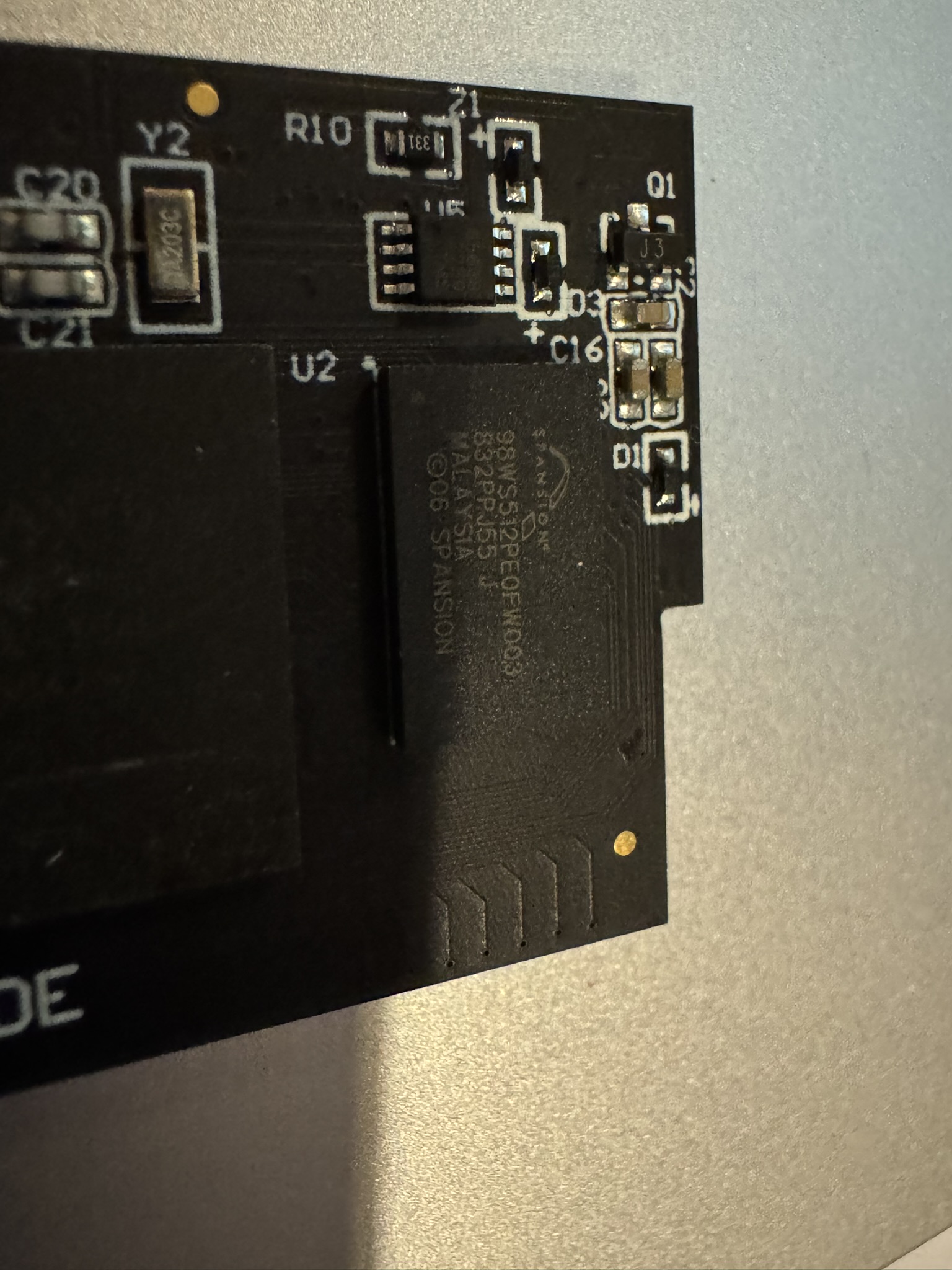

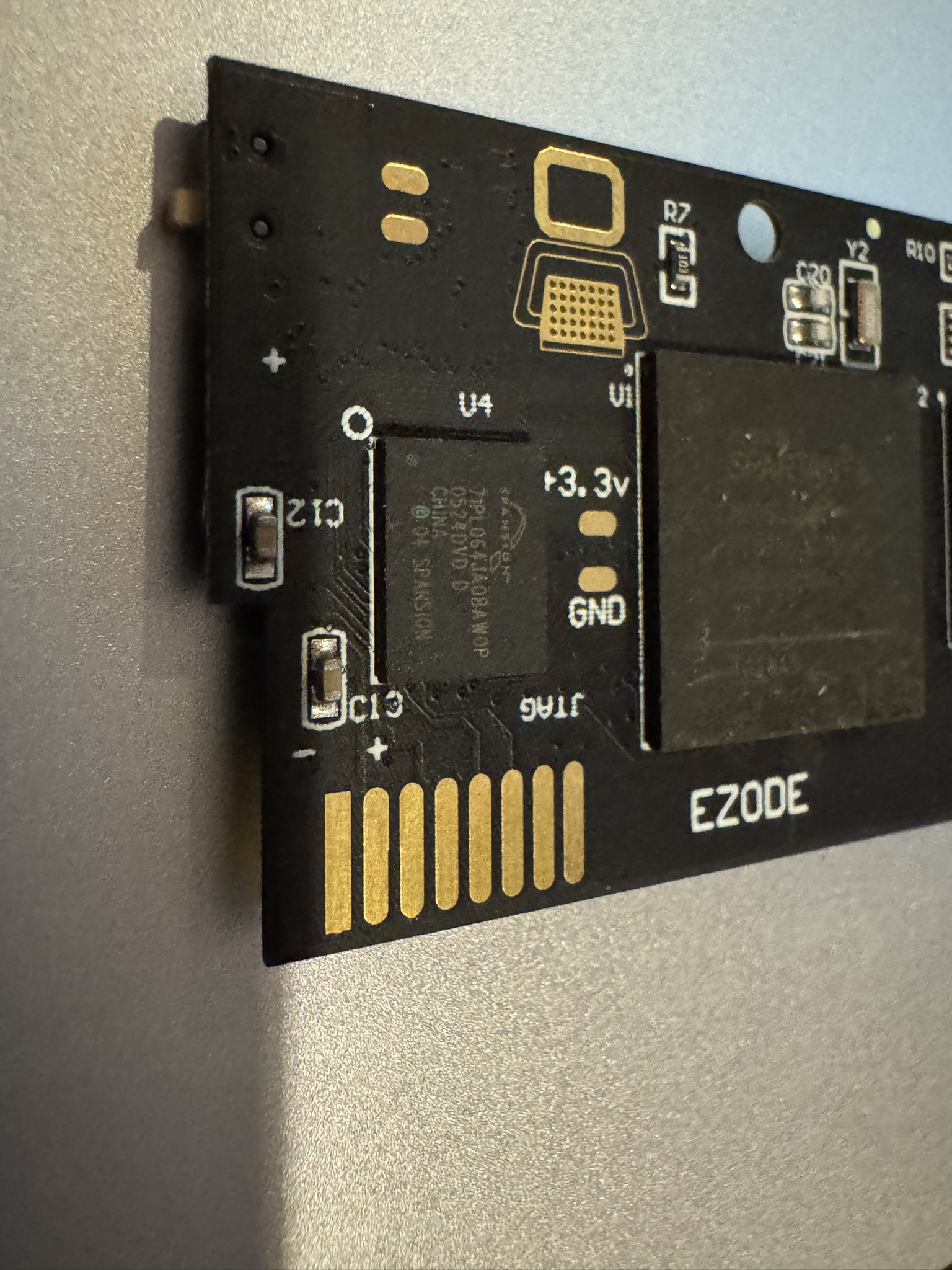

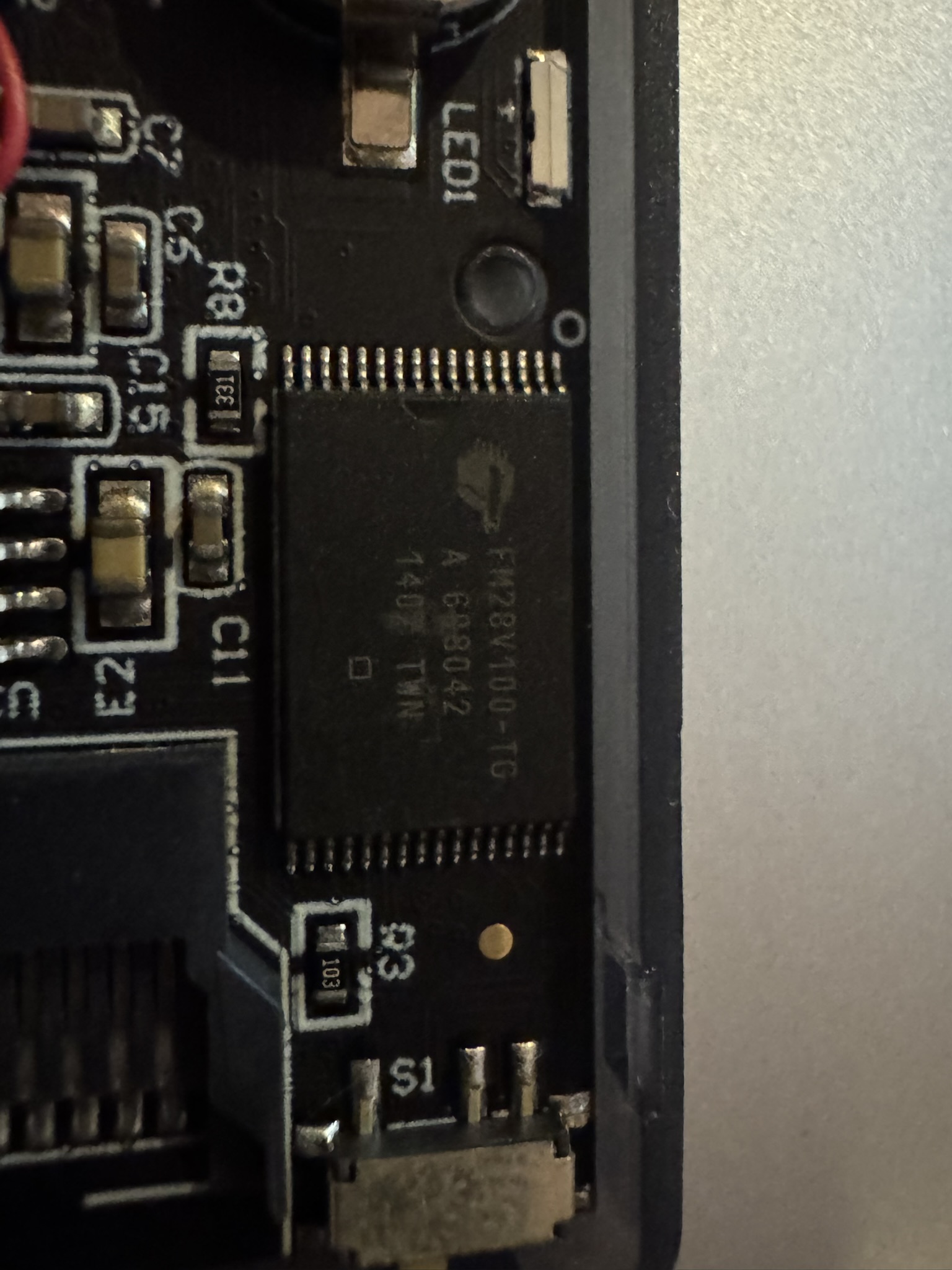

Yes the ROM's are clean. I̶ e̶n̶d̶e̶d̶ u̶p̶ t̶r̶y̶i̶n̶g̶ a̶n̶o̶t̶h̶e̶r̶ E̶Z̶F̶L̶a̶s̶h̶ O̶D̶E̶ a̶n̶d̶ t̶h̶e̶ p̶r̶o̶b̶l̶e̶m̶ w̶e̶n̶t̶ a̶w̶a̶y̶. I̶t̶ s̶e̶e̶m̶s̶ t̶o̶ b̶e̶ a̶ h̶a̶r̶d̶w̶a̶r̶e̶ f̶a̶u̶l̶t̶, o̶r̶ a̶ s̶p̶e̶c̶i̶f̶i̶c̶ i̶s̶s̶u̶e̶ w̶i̶t̶h̶ m̶y̶ c̶a̶r̶t̶. E̶v̶e̶r̶y̶t̶h̶i̶n̶g̶ e̶l̶s̶e̶ a̶b̶o̶u̶t̶ i̶t̶ w̶o̶r̶k̶s̶ j̶u̶s̶t̶ f̶i̶n̶e̶ s̶o̶ I̶'m̶ n̶o̶t̶ s̶u̶r̶e̶ w̶h̶y̶ t̶h̶i̶s̶ i̶s̶ a̶n̶ i̶s̶s̶u̶e̶. H̶e̶r̶e̶ a̶r̶e̶ s̶o̶m̶e̶ p̶h̶o̶t̶o̶s̶ o̶f̶ m̶y̶ c̶h̶i̶p̶s̶ f̶o̶r̶ r̶e̶f̶e̶r̶e̶n̶c̶e̶ i̶n̶c̶a̶s̶e̶ i̶t̶ i̶s̶ a̶n̶ i̶s̶s̶u̶e̶ w̶i̶t̶h̶ a̶ s̶p̶e̶c̶i̶f̶i̶c̶ c̶h̶i̶p̶ r̶e̶v̶i̶s̶i̶o̶n̶.
EDIT: Okay so I was a bit too optimistic. The files no longer say they are corrupted on the load screen, but I am still unable to save during/in the games for some reason. I'm not sure exactly why this is happening, and why the behavior is different between different carts.
