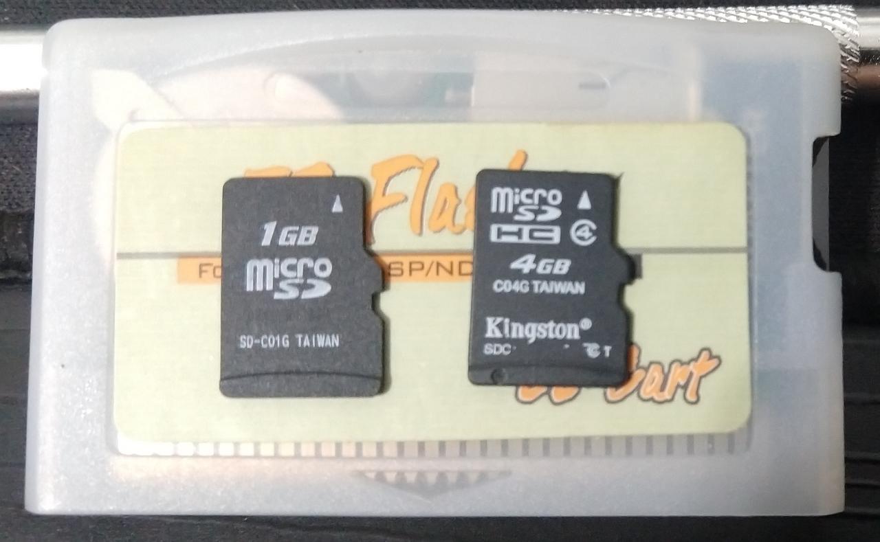

U only can update on up to 2GB card 4GB aka SDHC will not let u update
@Shadow#1

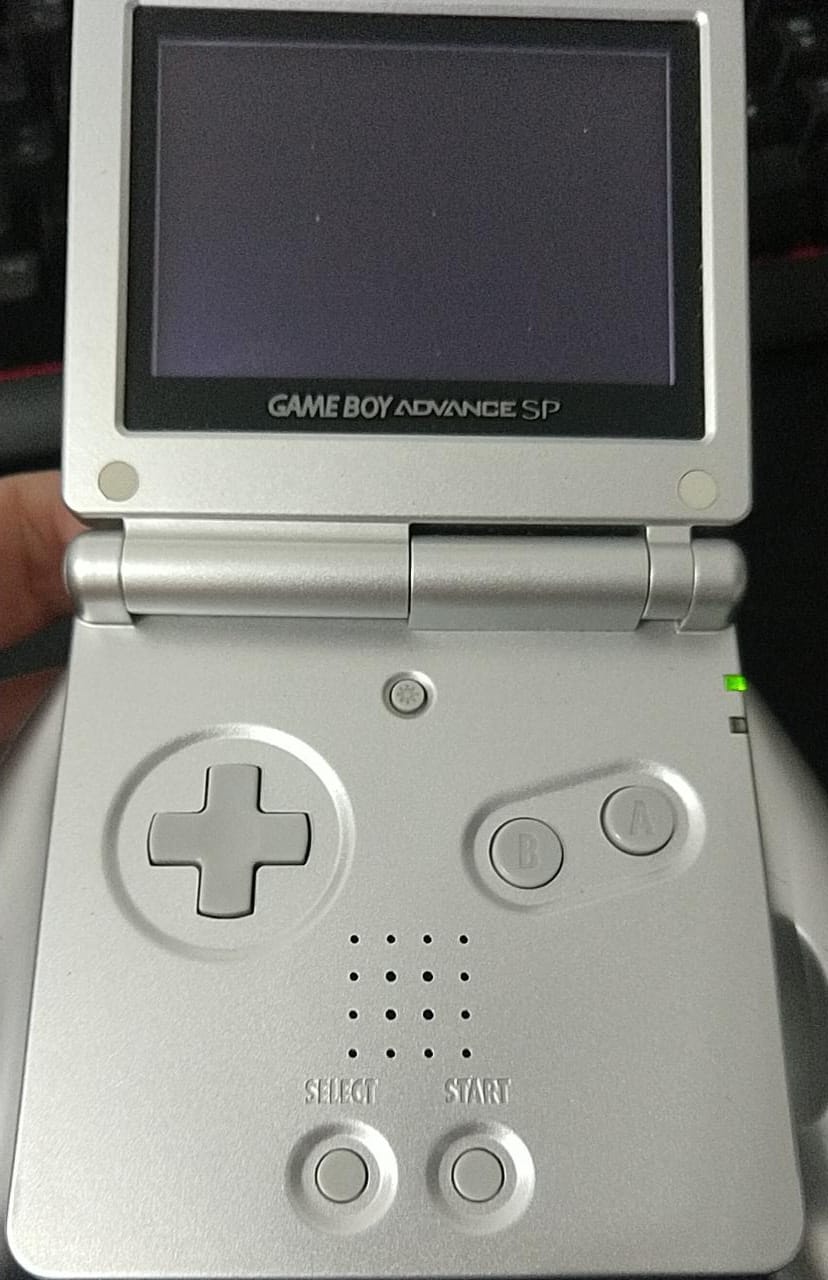

The 1GB microSD doesn't trigger any upgrade boot screen and
The 4GB shows me just a black screen
I'm sending two pictures: one showing my microSDs cards (1GB and 4GB) and a second one showing the black screen on my device.
Do you know what's happening?
