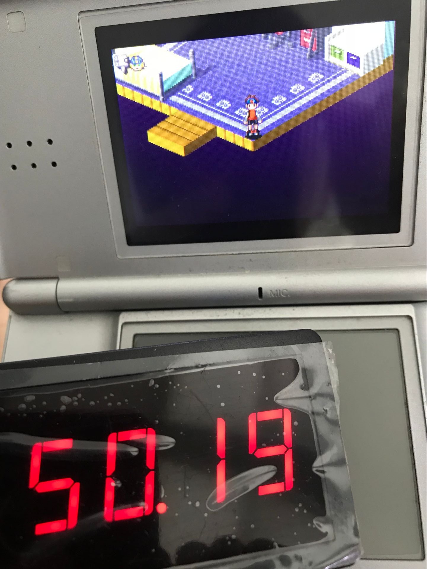

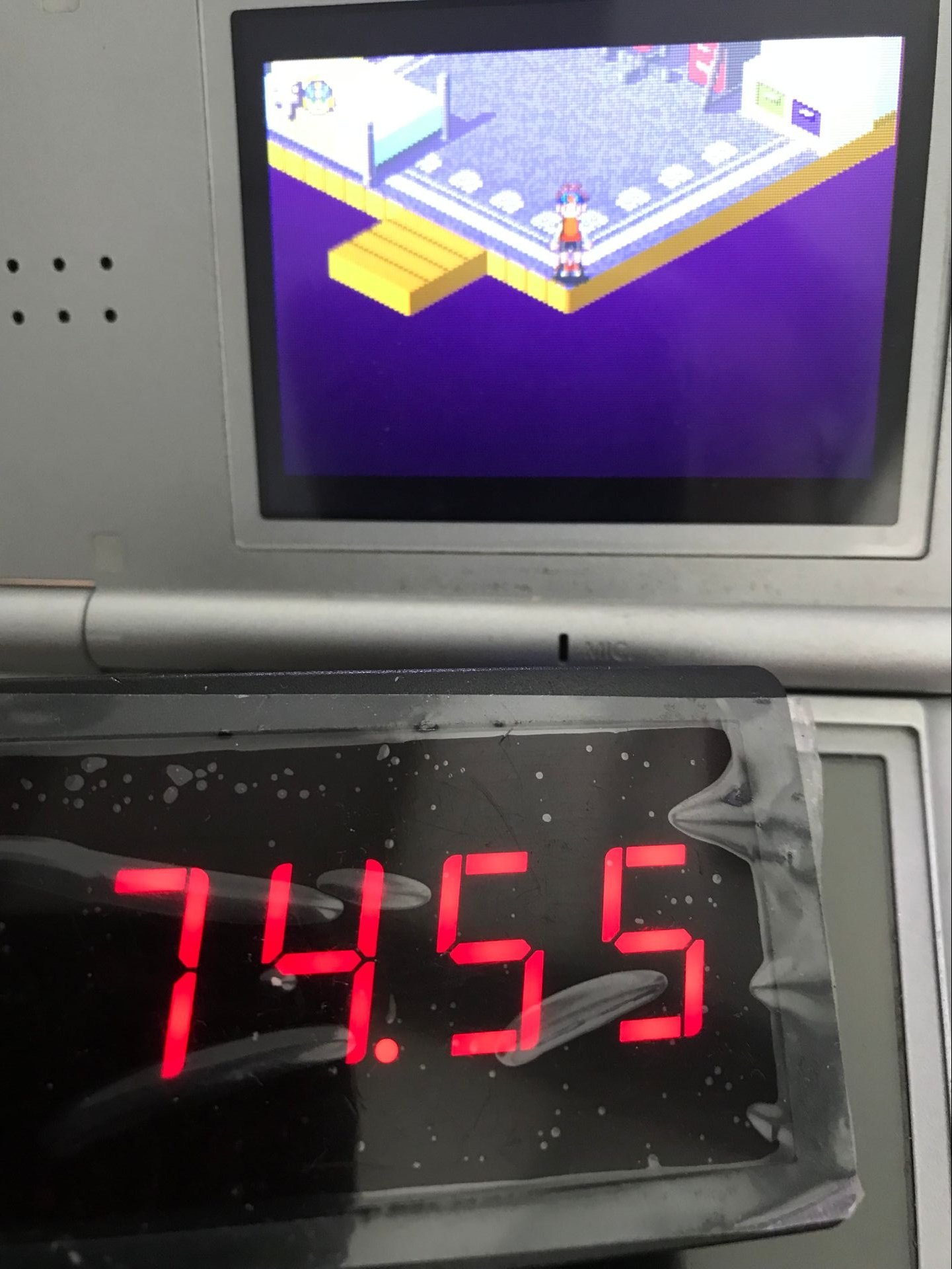

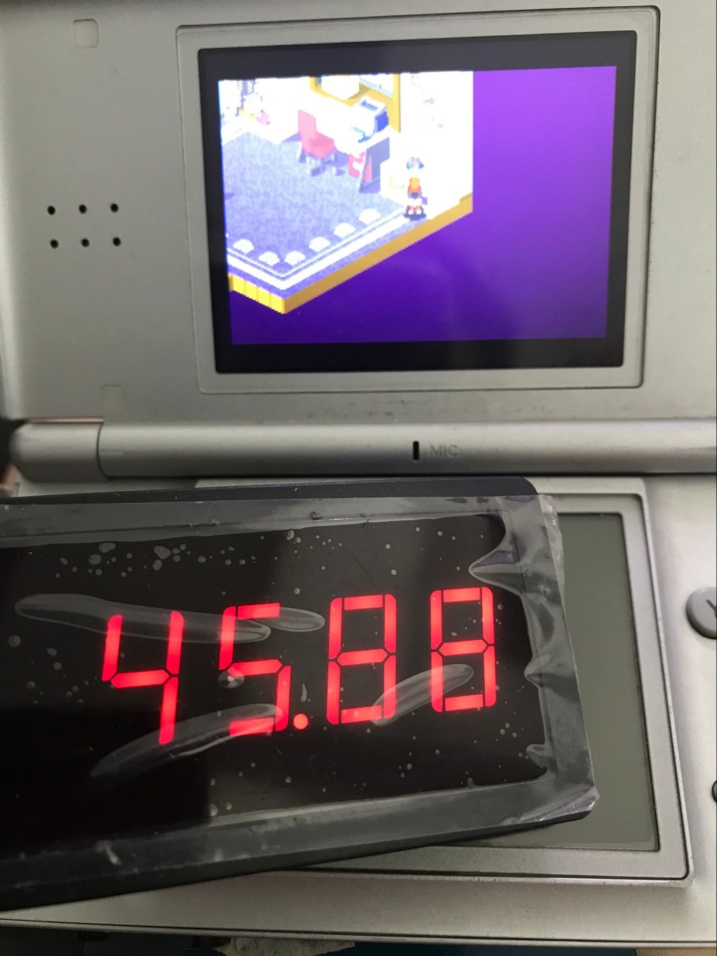

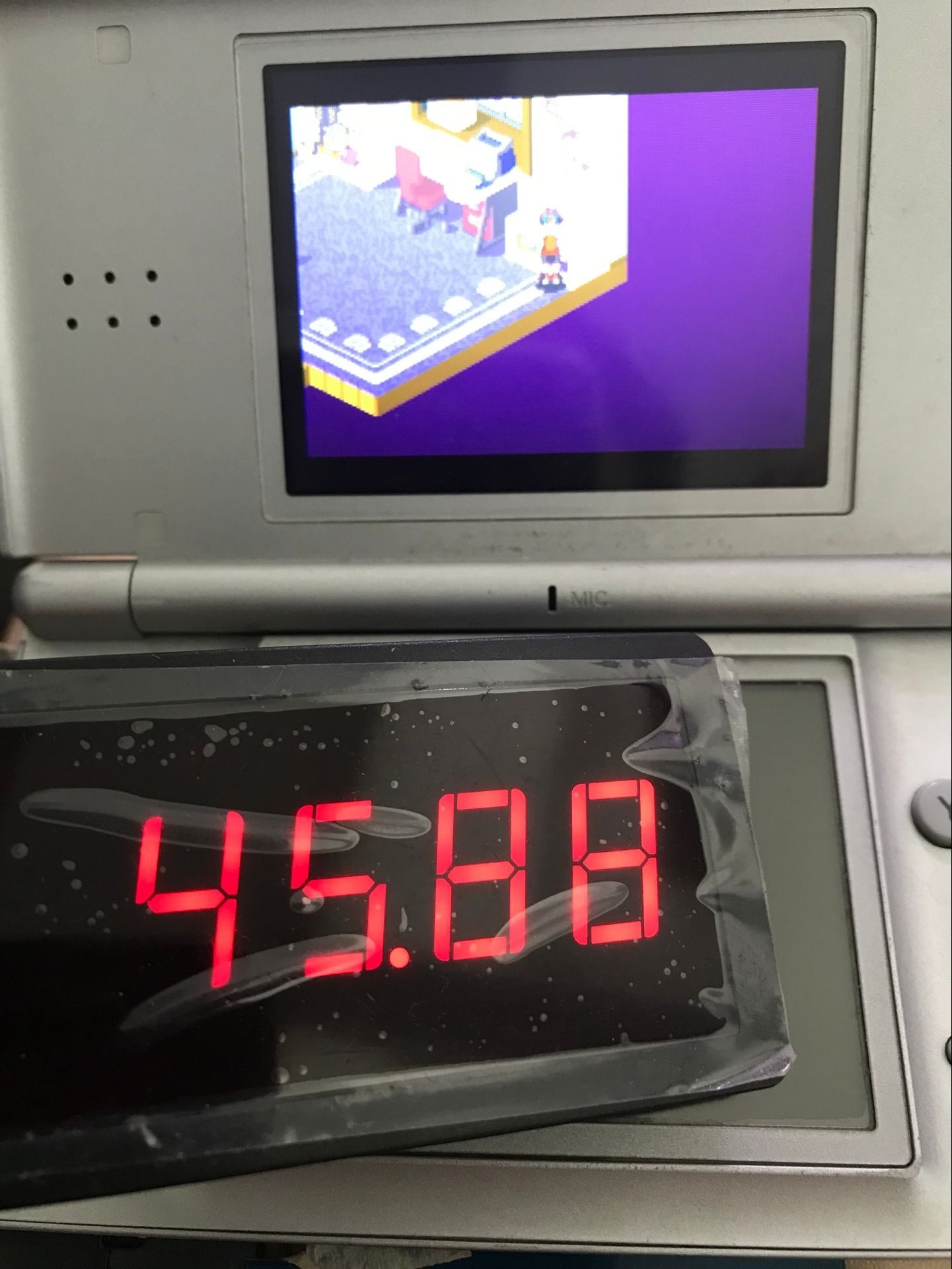

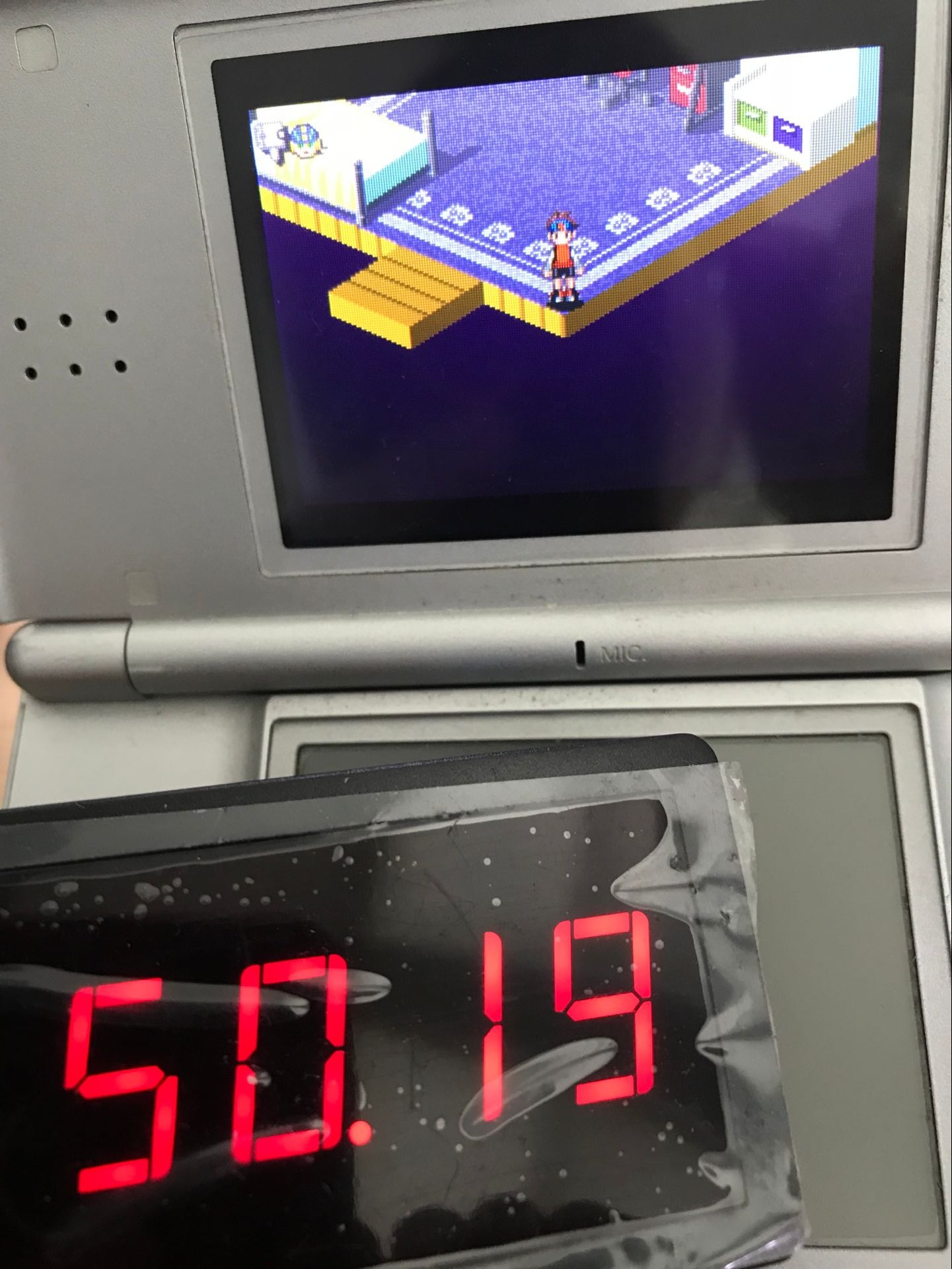

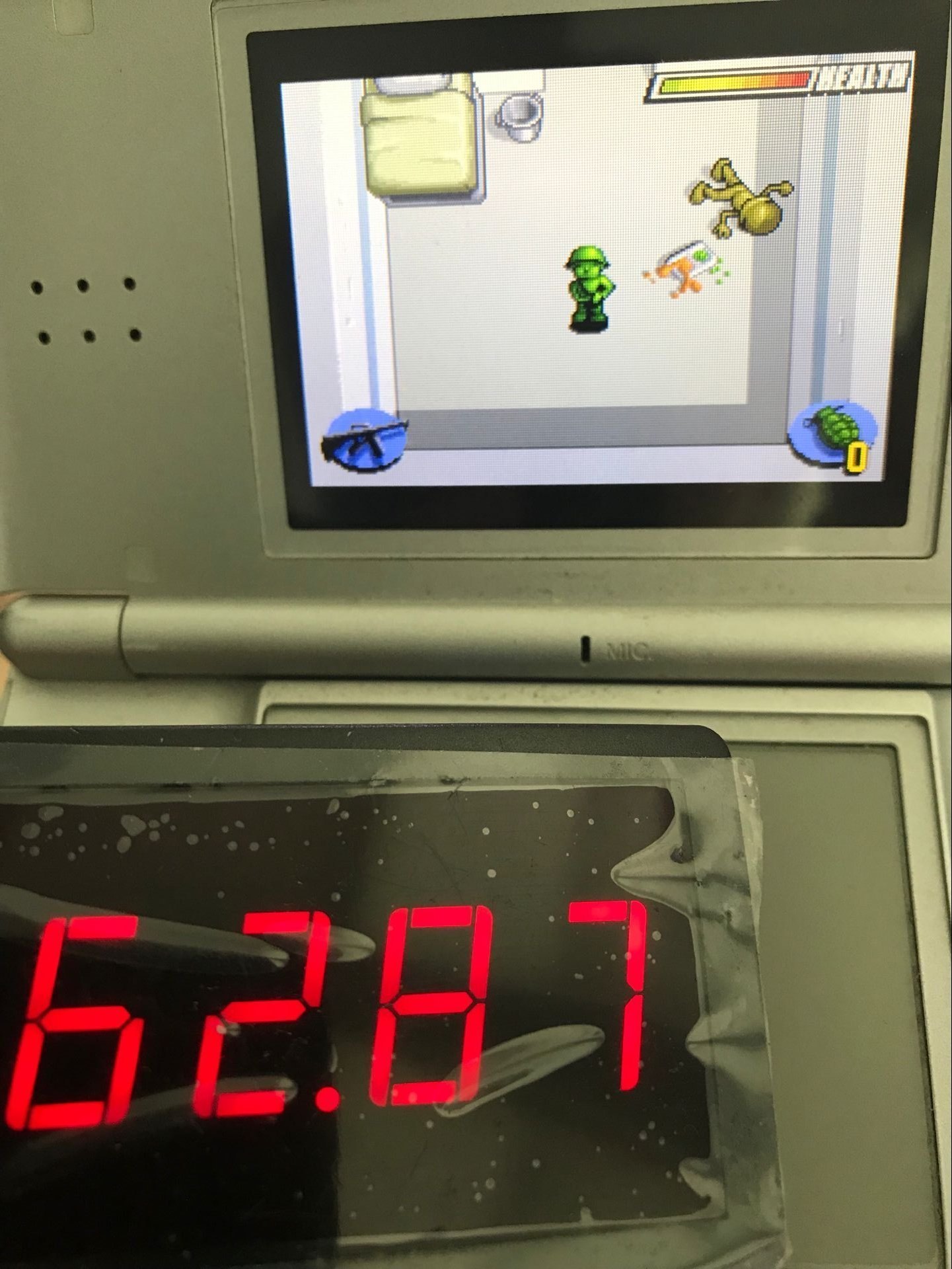

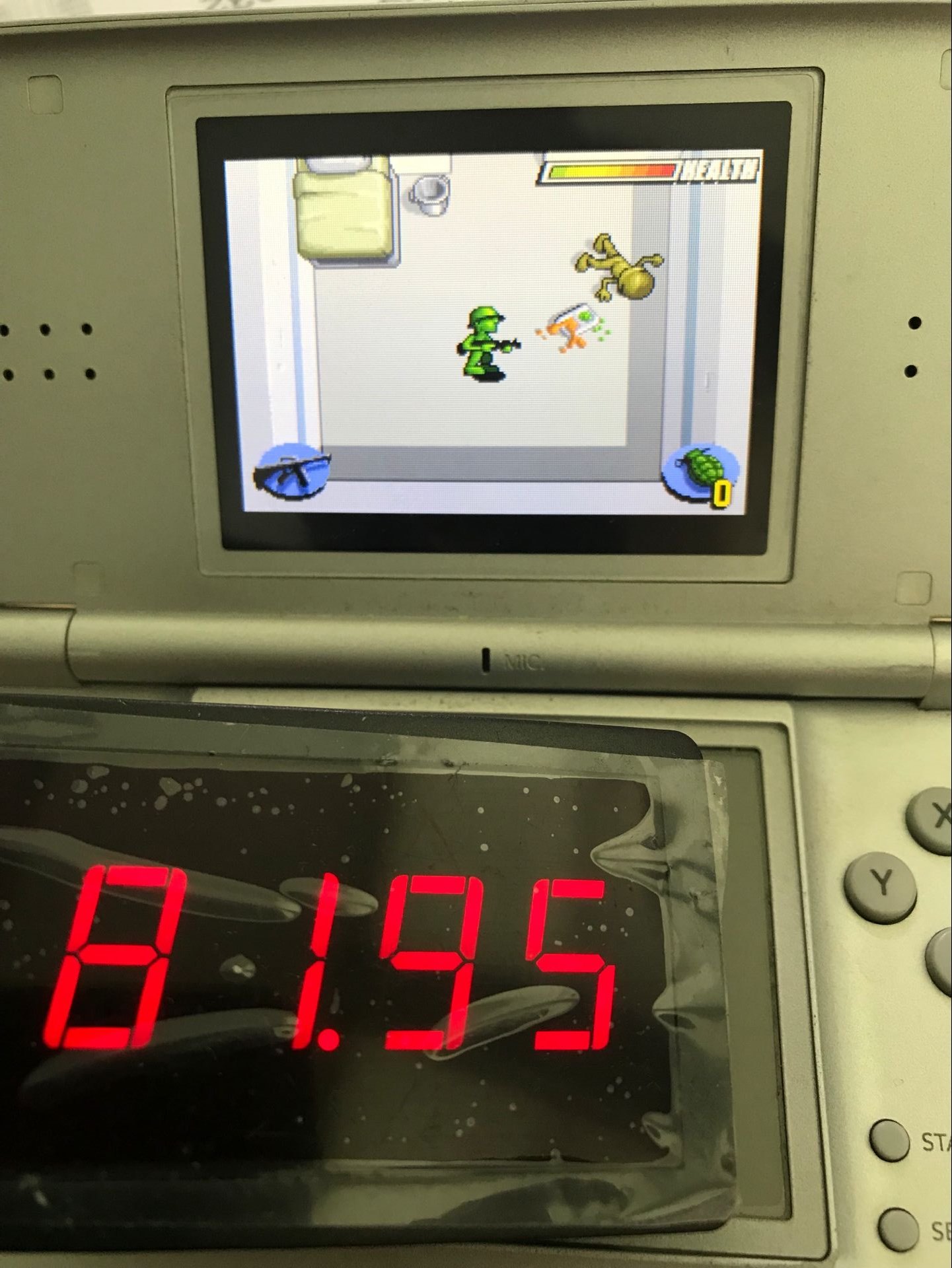

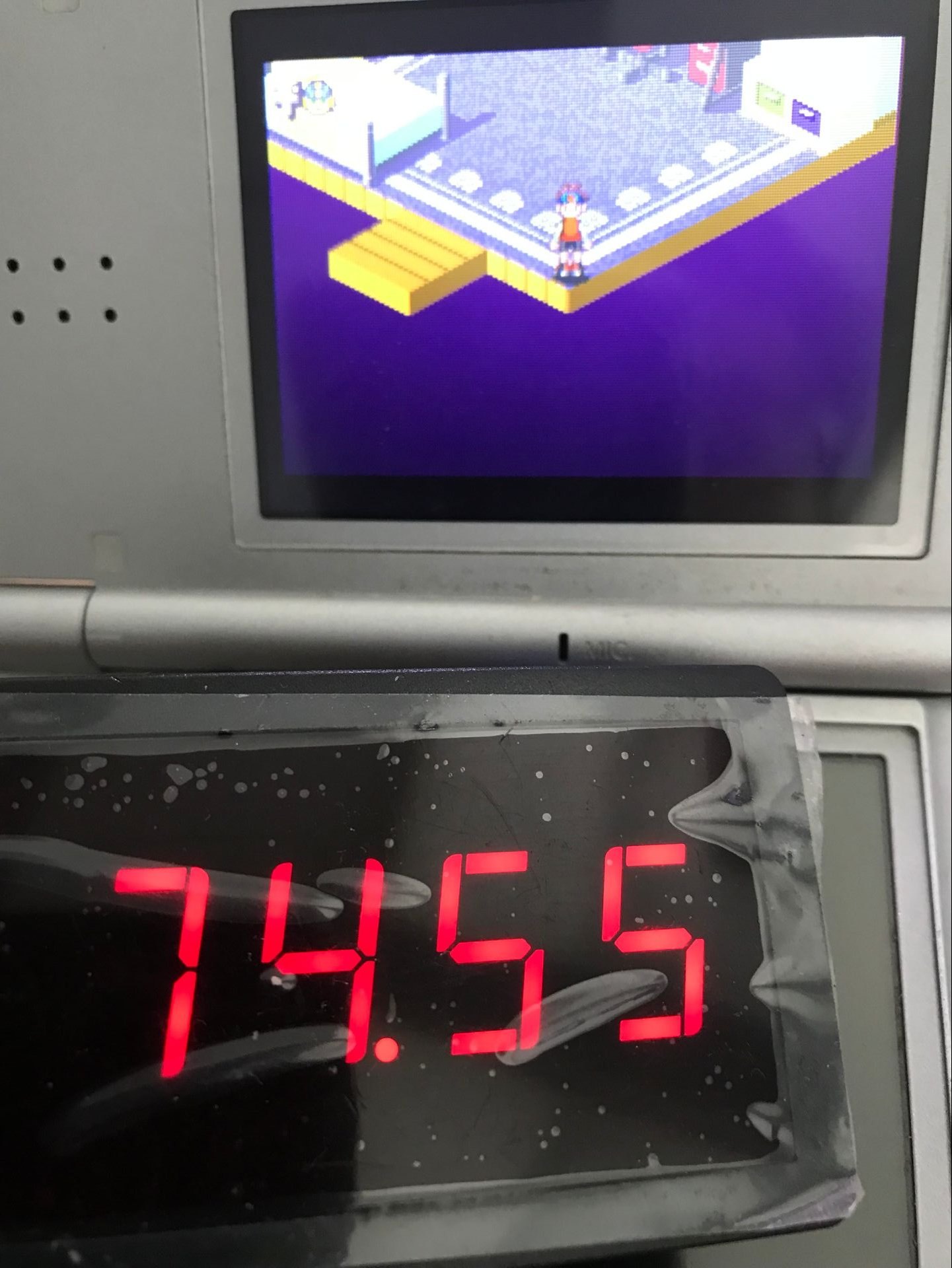

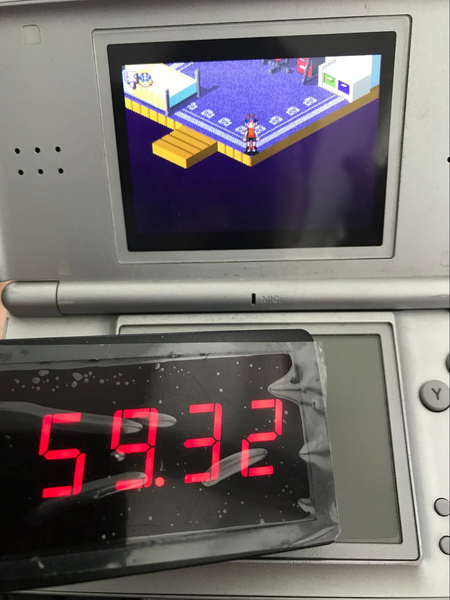

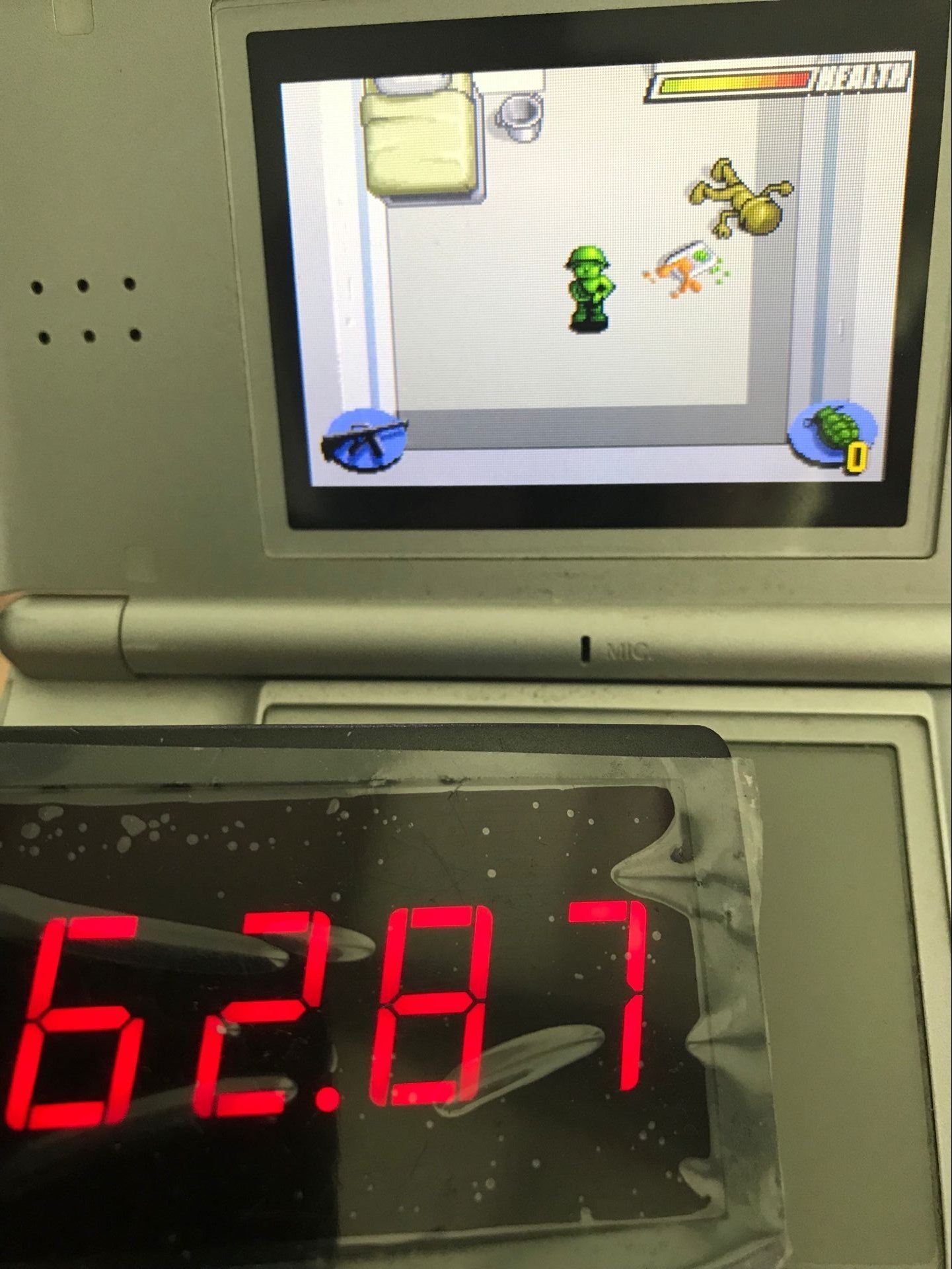

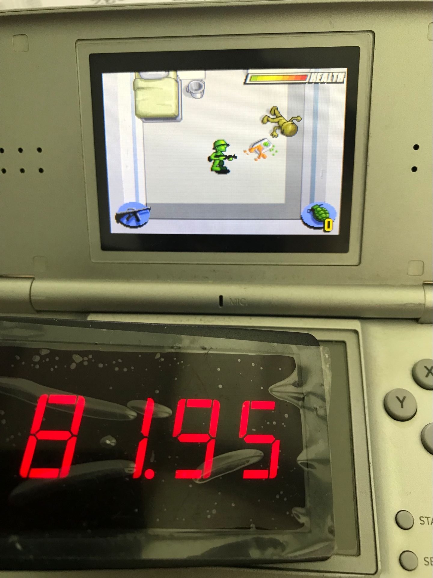

We'd added a new option in system to turn off the in-game RTC module. it can save more power.
We use a current meter to measure the card power load, not the whole console.
The different game has different power load.
Below image is firmware 4: 81.95 ma
Below image is firmware 5 test version with RTC module on: 62.87ma

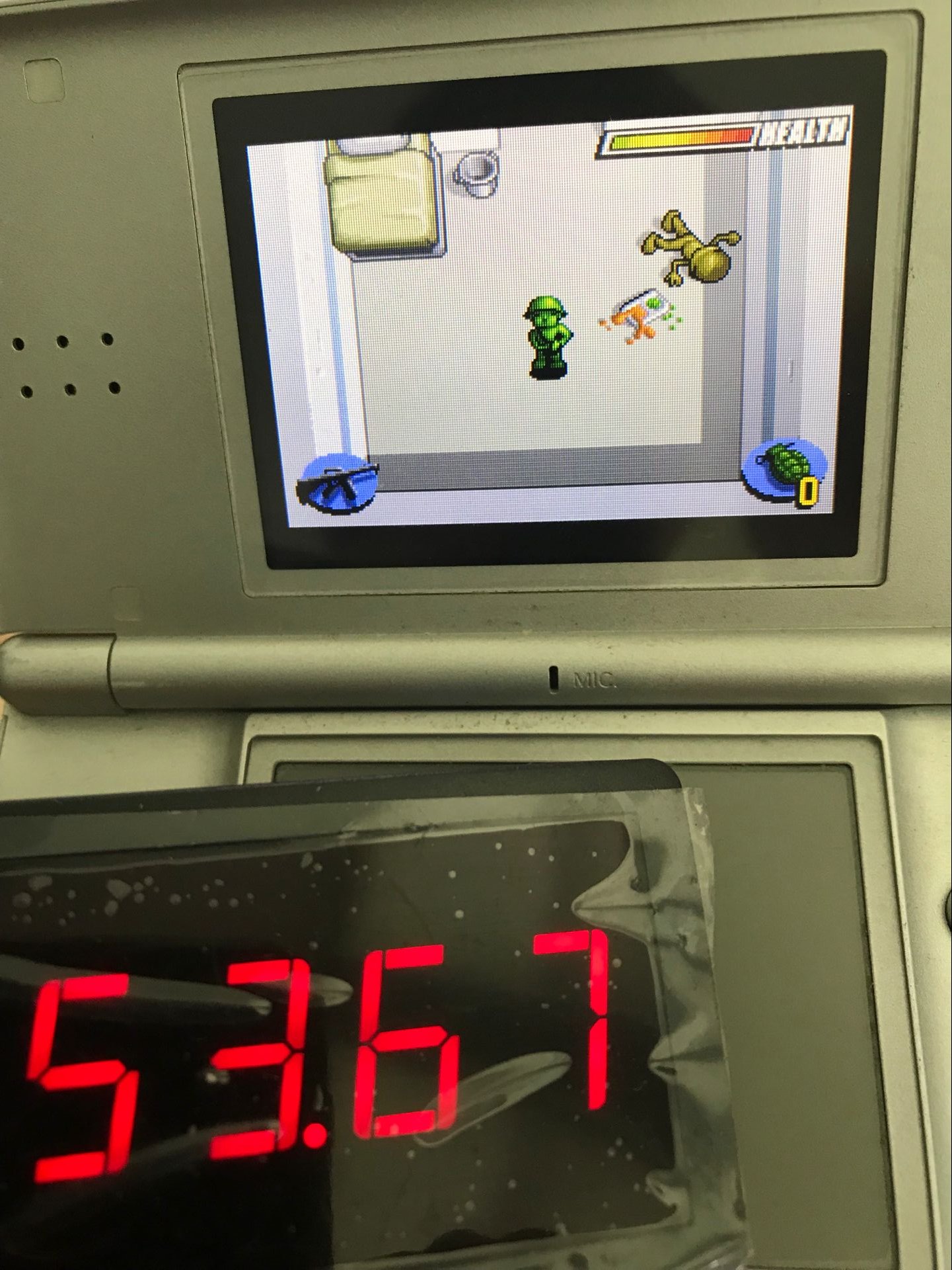

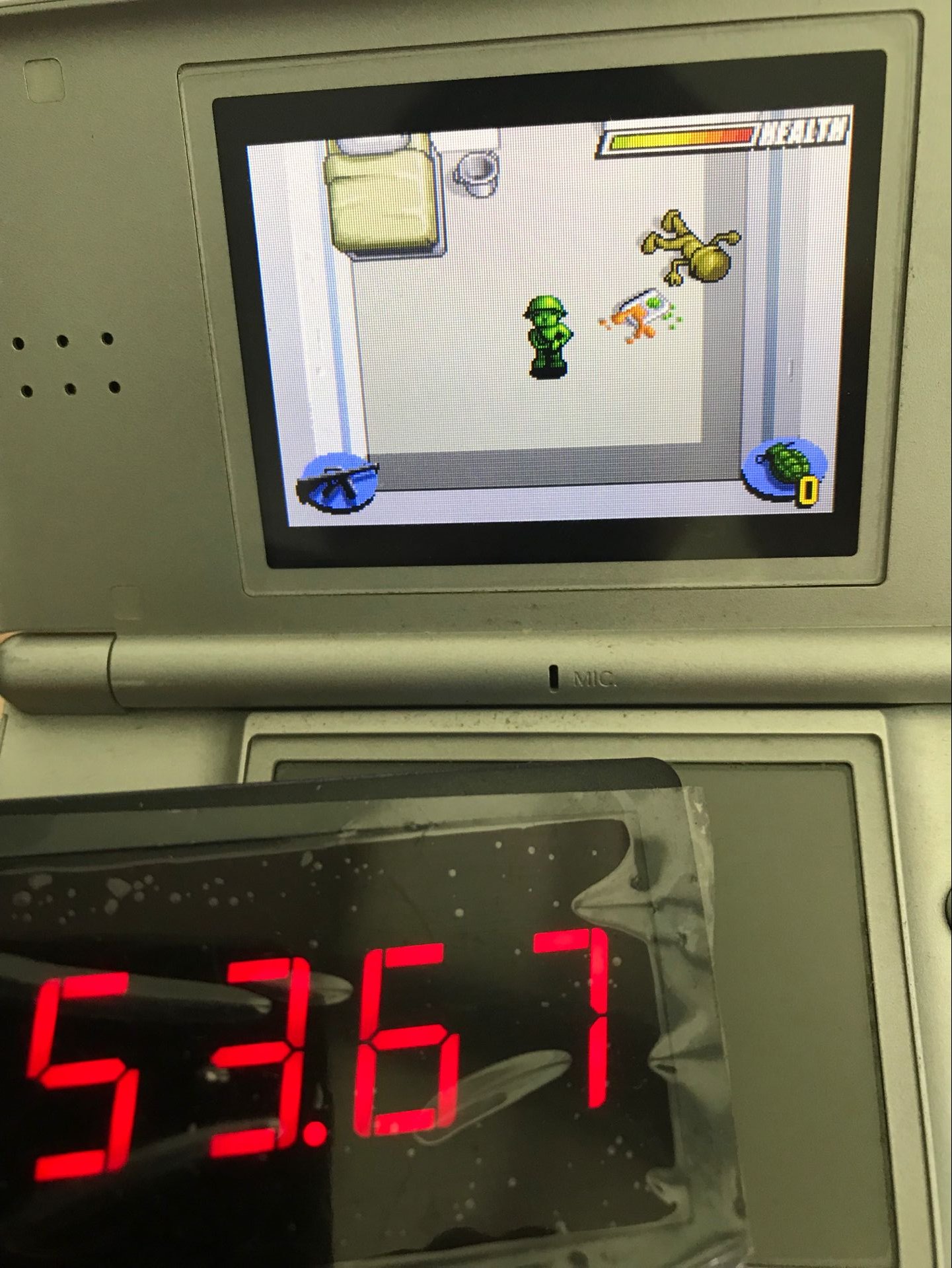

Below image is firmware 5 test version with RTC module off: 53.67ma
Below image is firmware 4(another game):74.55ma

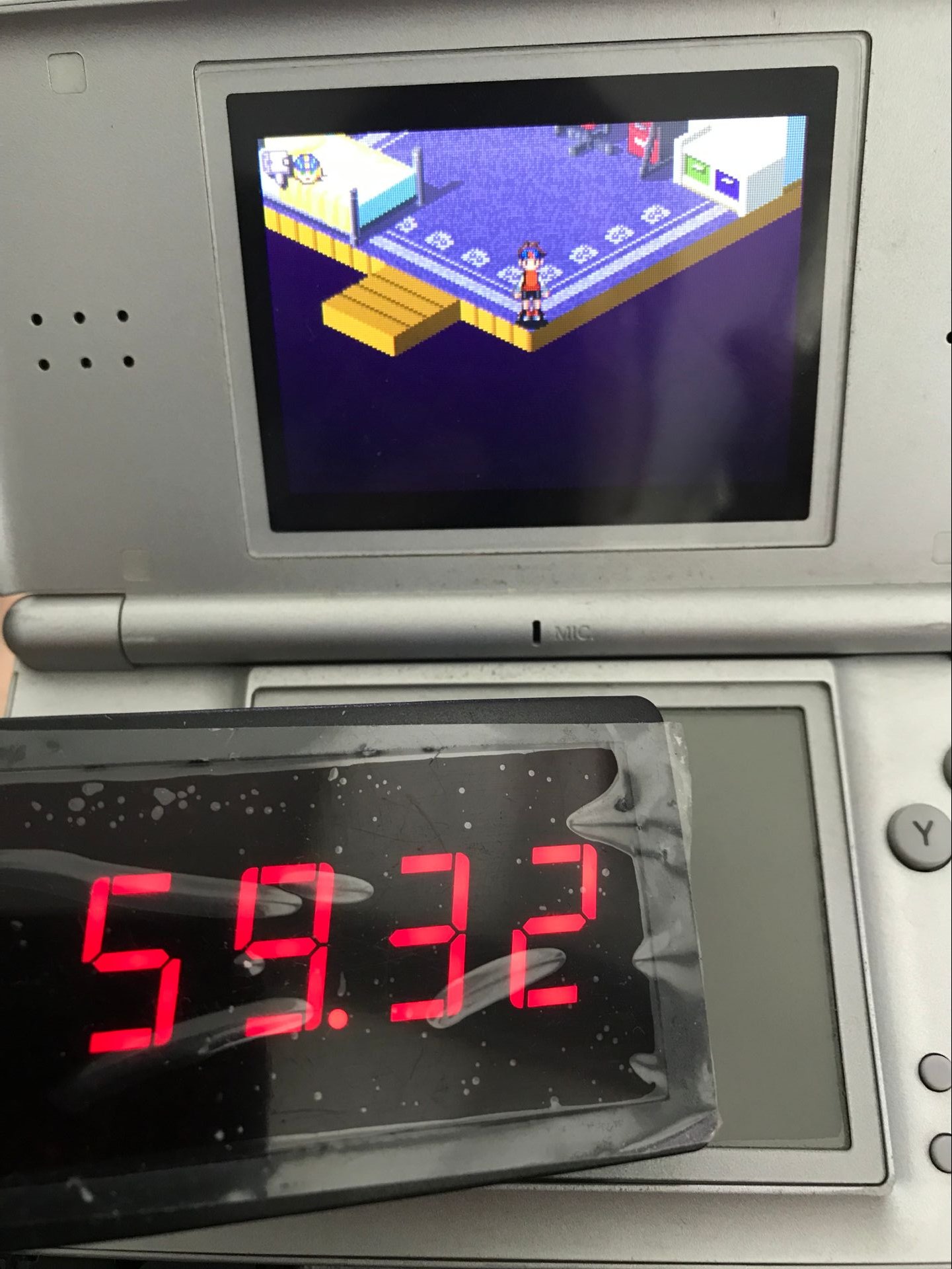

Below image is firmware 5 test version with RTC module on(another game):59.32ma
Below image is firmware 5 test version with RTC module off(another game):50.19ma
Below image is EZ-FLASH IV:45.88ma
It seems power consumption drop down 35% at maximum and very near EZ4. I don't know this result is satisfactory or not, but this is the best result that can be achieved with full performance, for now.

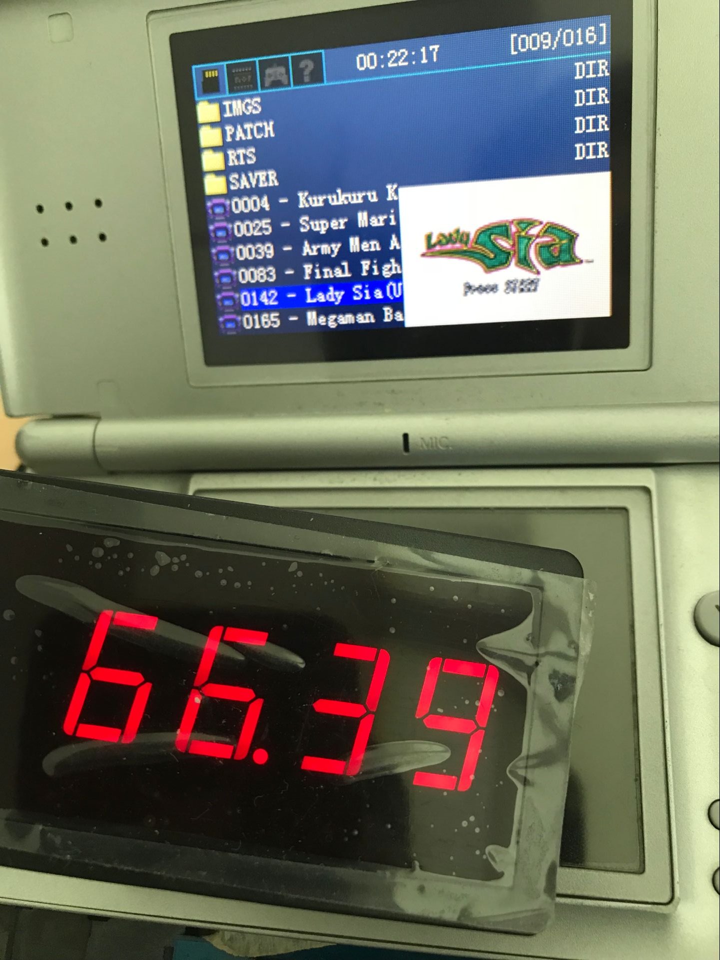

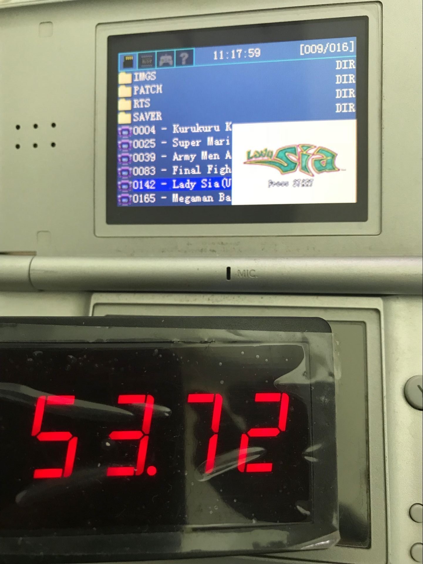

update two images
Below image is main menu firmware 4: 66.39ma
Below image is main menu firmware 5 test version: 53.72ma
