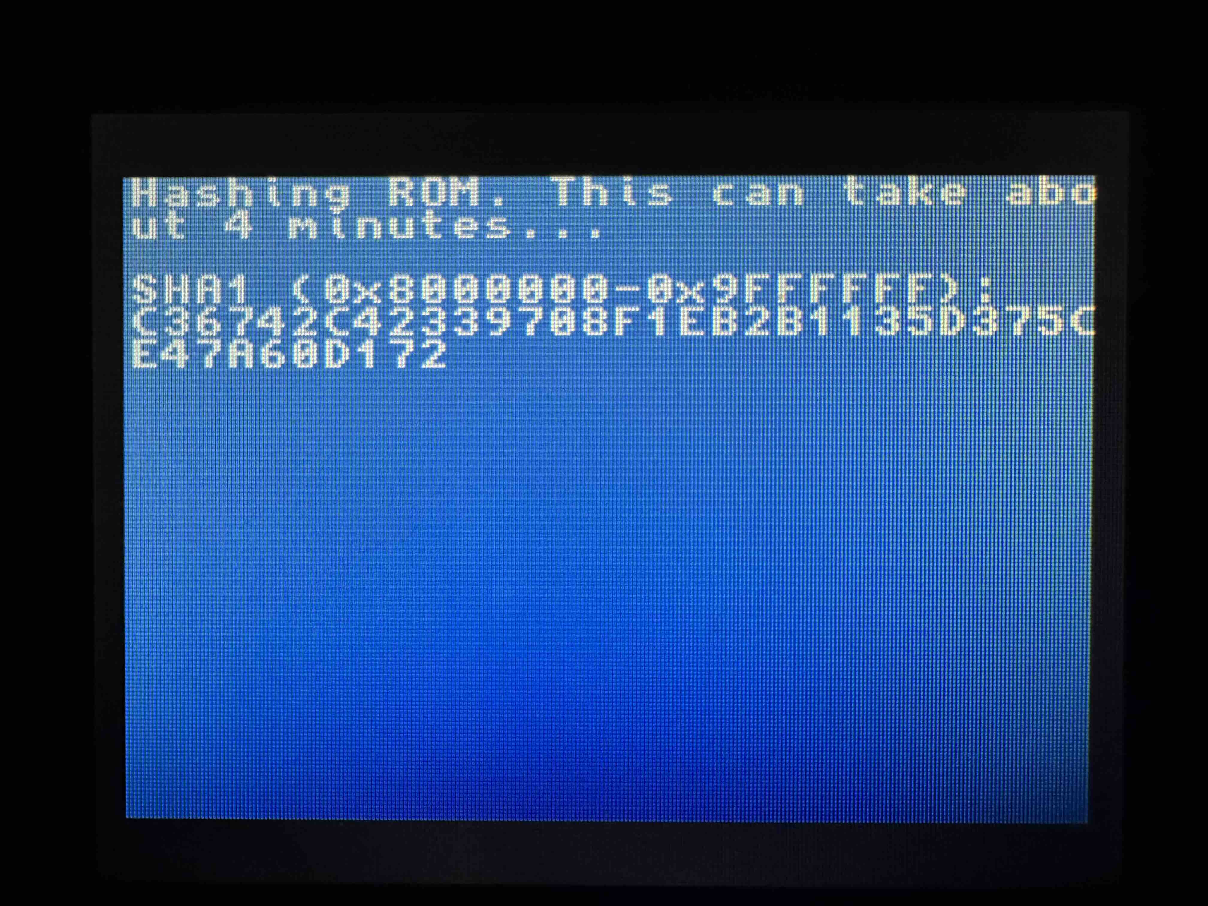

I ran your custom ROM test tool (clean boot mode A). It reports:
  • A completely different SHA1 than the filename and every time I rerun it, it has a new SHA1 hash. This is true even if I directly try to recompute the hash during the same boot of the file (press B then A again). The file itself when hashed from the computer has the correct SHA1.

The issue which looks like a glitched PSRAM, which is sometimes caused by poor power supply.
Try testing again while connected to the power source, or use a fully charged battery.
I’ve ran the test ROM on a DS Lite and a stock GBA and both exhibited the same problem of diffing SHA1 hashes. Both on almost fully charged batteries.
