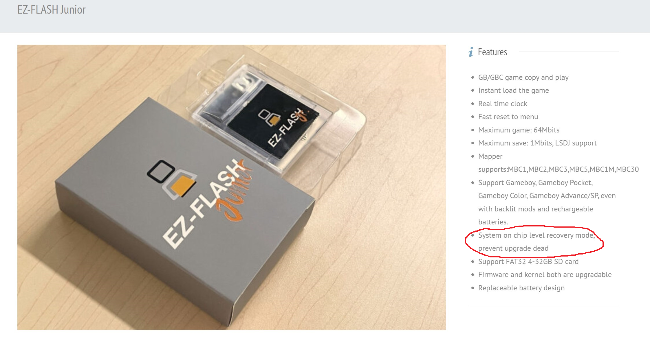

Hey @DrunkenMonk that's me again !
Thanks for the answers last time, after reflexion I would ask two more things:
-isn't fw the same inside all EZ-Flash JR ? (flashing the same than someone else wouldn't work in case of brick ?)
-and isn't there a recovery mode in the case you've bricked the flashcard ? (indicated on the website)
Thanks again, I'll probably proceed or not to FW upgrade depending of the answere :P

I had bricked mine before using one of the earlier FW4 test firmwares (isn't available anywhere anymore) and it was bad enough that the header was entirely corrupt and I couldn't boot the cart to any kind of state to allow recovery, but I'm fairly certain that brick recovery feature was implemented later and there is a chance it's now not possible to brick in the method I had before? It's a toss-up,
What I will say though is from my experience, the latest test-flight firmware does seem relatively stable and even reflashing the firmware multiple times I've not encountered a brick. Can only go over my experiences though and upgrading is always going to come with a warning when it's a test flight firmware. Even if EZ-Flash themselves have gone dark for over a year, who really knows if we'd get something anyone is comfortable saying is 100% safe.

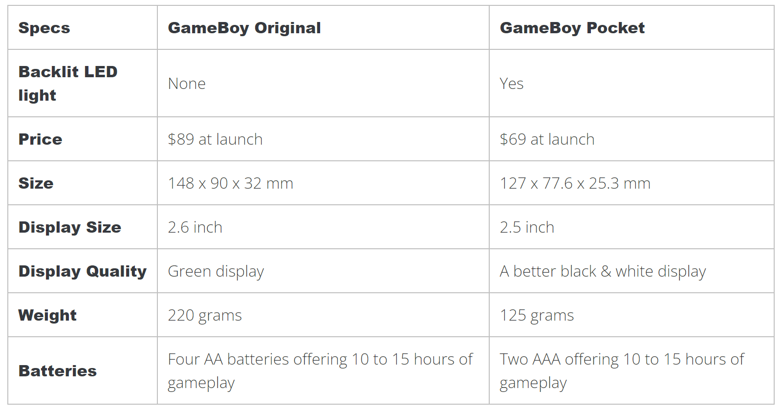

no. the pocket is my only gb device. what difference between the classic and the pocket can cause incompatibility? i don’t think its the power consumption. also with the min. brightness it freezes.

Idk, but it could be due to the console since someone else has problems to launch the EZFlash Junior itself with his GB Pocket (and works with a classical GameBoy)
Btw the guy got problems after upgrading to FW4, so idk which FW you run, but be careful since it could even break more things in your case
