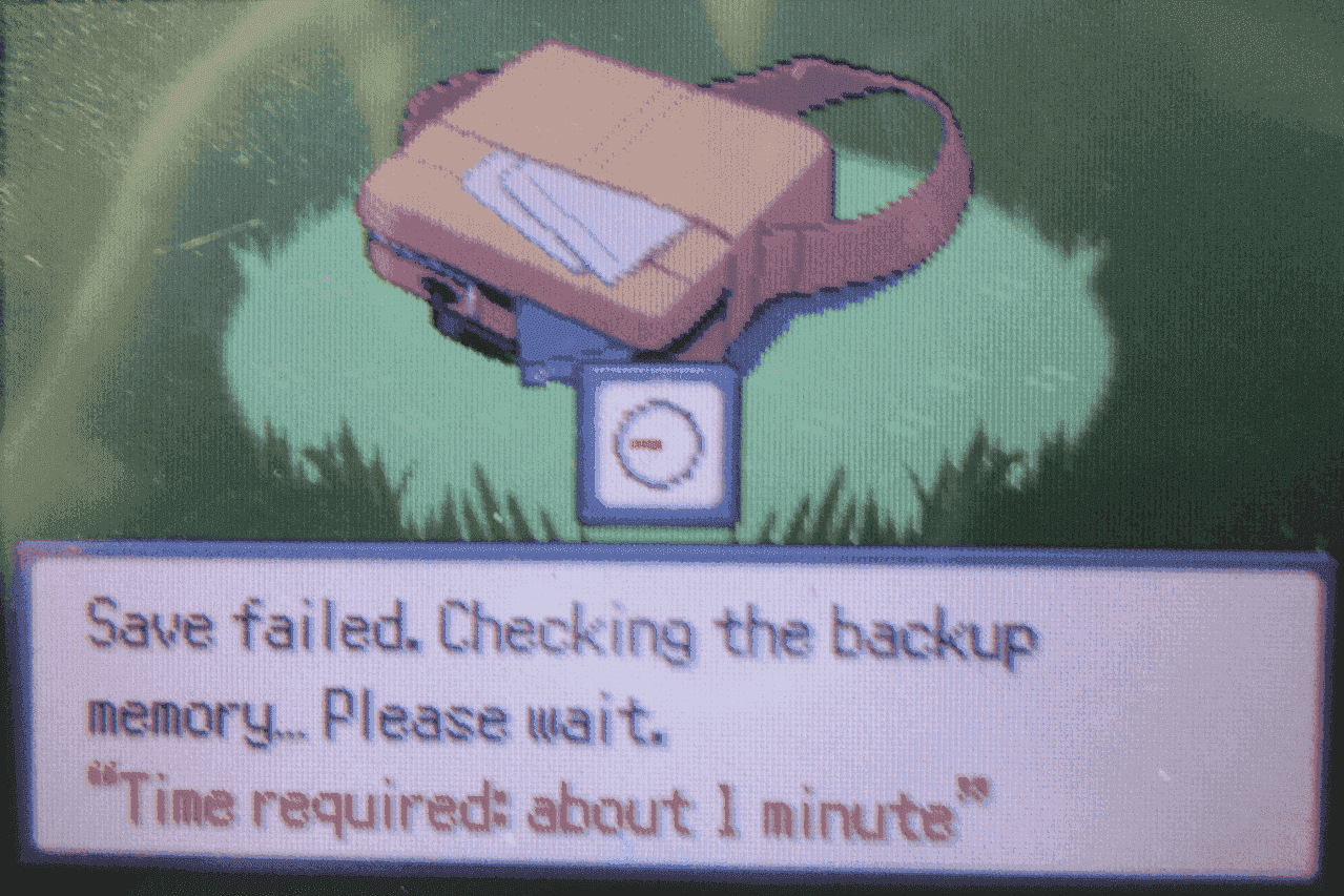

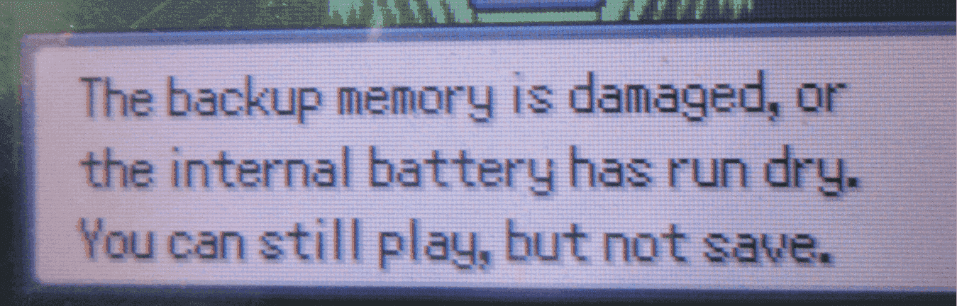

Hey everybody! I don't know if anyone else has come upon this issue, but it seems that my EZ-Flash has died. Literally! Here are 2 pictures on what happens if I save for a pokemon game. It seems to me the all cart is dead. Can it be fixed? Is anyone else having this problem? Thanks Tempers!~

Sure! Pokemon Emerald. Nope, just the normal game! It is a 3in1. Yes! I have like 30 games, and I realized about a week before it stopped working, the saves would load, but the area where it loaded would be pix-elated, or it wouldn't recognize the save!
Pokemon has long had annoying issues with saves like this, emerald being especially prone to things like this (it was unpatched for quite some time).
It might be that the save memory/battery has died too but ignore that for now.
Anyway does it happen with other games, did you change the software you use to manage your 3 in 1 if you start a new game of emerald does it do it there?

There isn't a software for it! It's an expansion to run GBA games! :) It's never happened before now! Also, I have Super Wario Land 4 ( I think that's right) And still no save! It erased the data that was on the cart!
Yeah but the 3 in 1, and every other GBA cart, does not have software to manage the games it runs. It might run straight from your flash cart but it would still be the DS flash cart loader handling it all.

I've always thought it was straight forward. If I needed to, I always used GBAXploader. Here's the cart I'm using!

we already know the cart you were using, you just needed to say 3in1..
in http://ezflash.cn/ the official website you can find the client tool for copy the games in the cart, it will convert and create the save on the micro sd\sd card... at least the problem with wario and a lot of games will be solved.. for pokemon i think you also will need a rtc patch but i think its optional..
