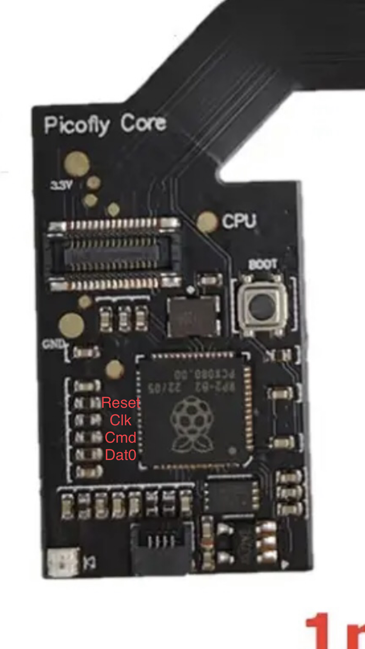

I just had this issue and I fixed it by removing the 47ohm resistor on the reset line and bridging the connection. I left the 47ohm resistor on the clk and cmd. And left the 330ohm on the dat0. Which is how it came from factory. Works perfectly. The chip in picture is the one I had got from AliExpress.
Never mind. It failed again. Time to swap out the dat0 and cmd resistors. Will report back.

I tested 100ohm Dat0 and CMd and 47 ohm clk reset, without success,I tested many other values that I have not written here, without success
Finally the solution for my Switch with Pico style hwfly was to change the emmc. (this emmc work good with real pico 2040 zero).
It seems that the picofly version "HwFly" is a little more capricious on the emmc.
Any updates? If swapping the resistors work I will try the same, if not I guess I have to install a RP2040 Zero
Update:
Swapping capacitors didnt worked, I got error 2002-5055 instead, and sometimes 2002-3540.
I now swapped the Hwfly with an RP2040 Zero and everything works fine.
