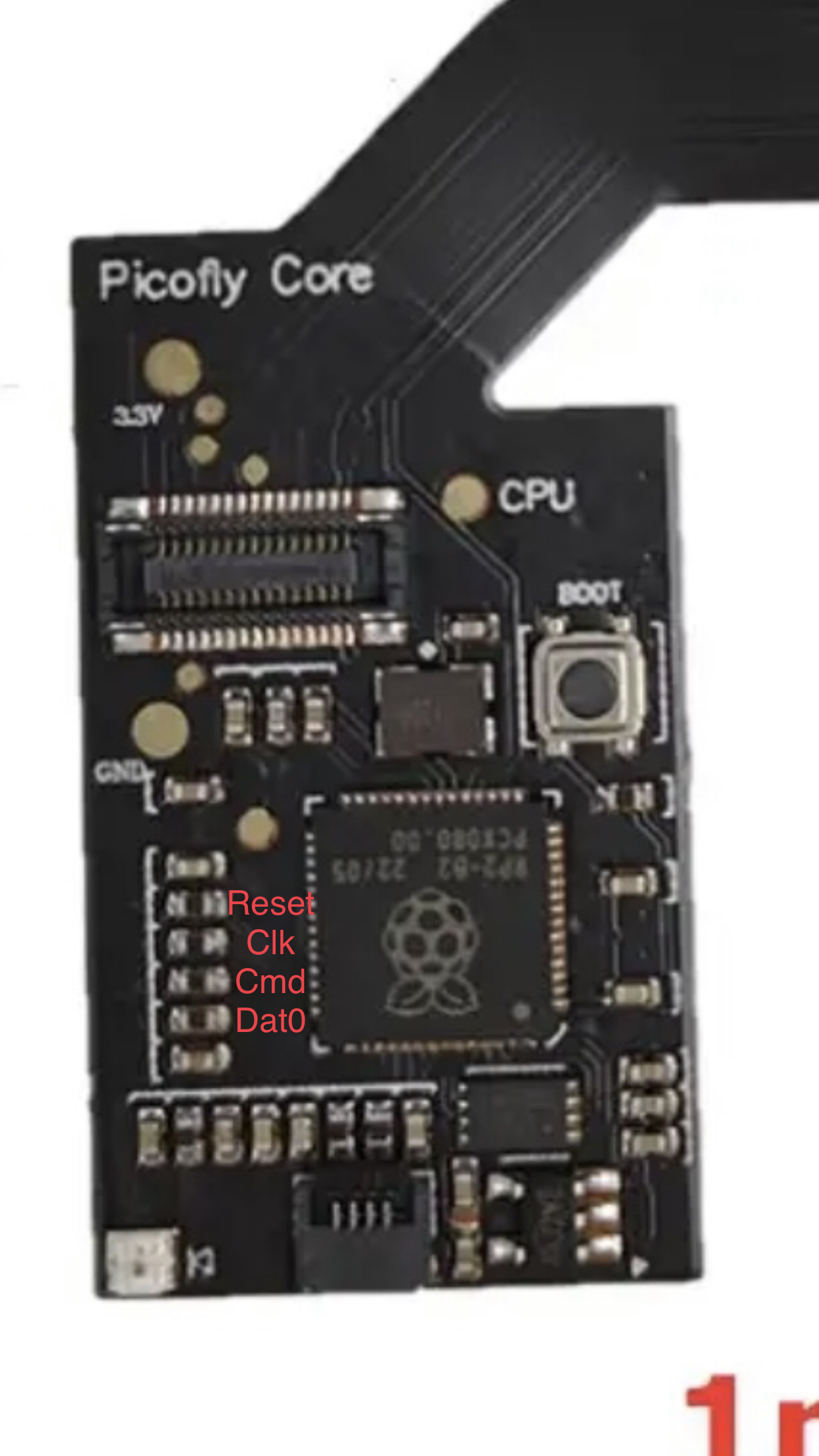

I just had this issue and I fixed it by removing the 47ohm resistor on the reset line and bridging the connection. I left the 47ohm resistor on the clk and cmd. And left the 330ohm on the dat0. Which is how it came from factory. Works perfectly. The chip in picture is the one I had got from AliExpress.
Never mind. It failed again. Time to swap out the dat0 and cmd resistors. Will report back.
I'm facing the same issue, reportin a table with the results. Waiting for experienced members to give some light about.
