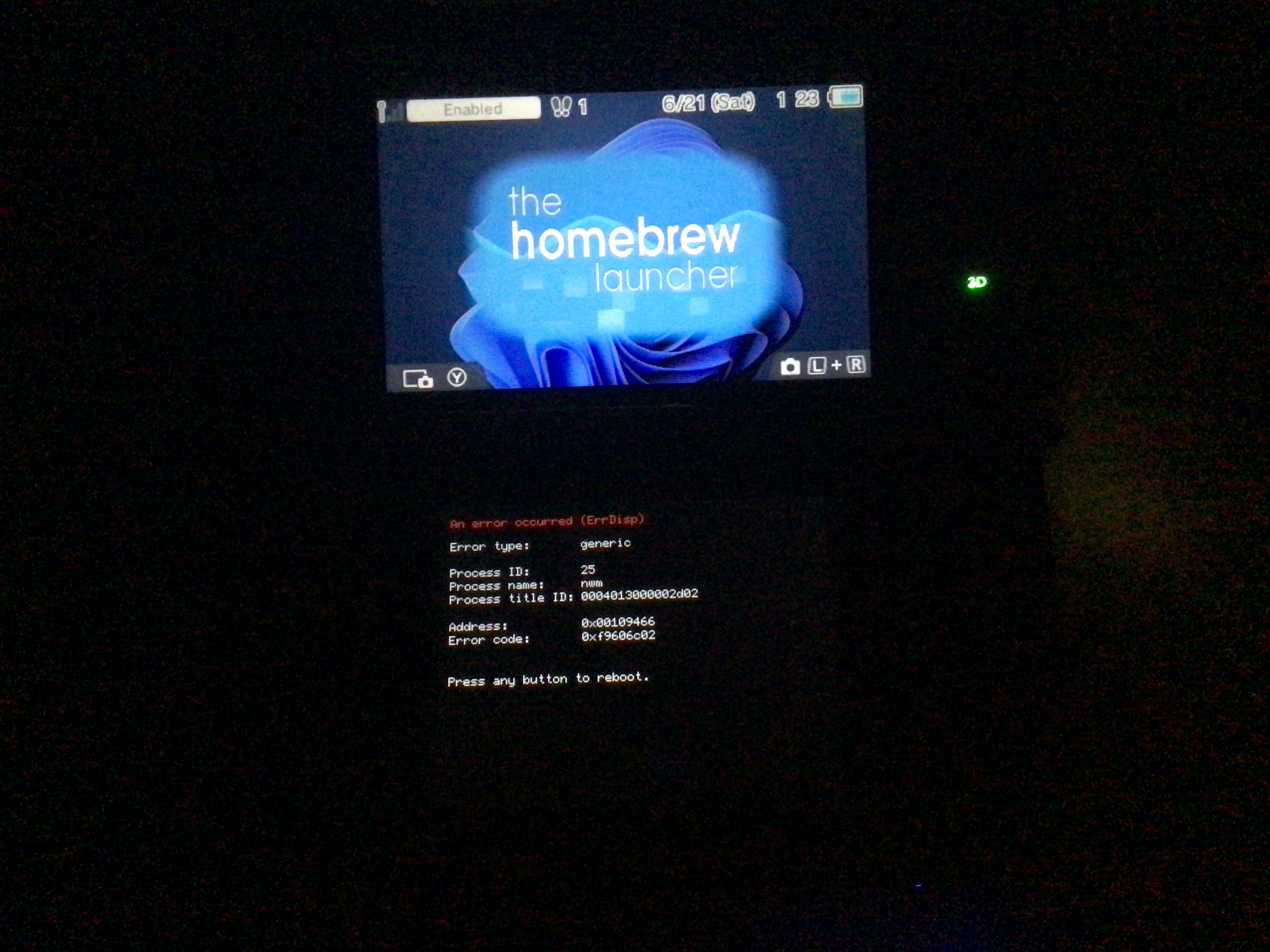

Today, my 3DS had problems. It just showed the ErrDisp when it boots to the Home Menu.
It shows
Error type: generic
Process ID: 25
Process name: nwm
Process title ID: 0004013000002d02
Address: 0x00109466
Error code: 0xf9606c02
Do you still get an error if you remove boot.firm from the root of your SD card?
(To find out whether it's caused by Luma3DS, or if your wireless module is corrupted or faulty.)
Reactions: zxr750j
The wireless module is faulty.
