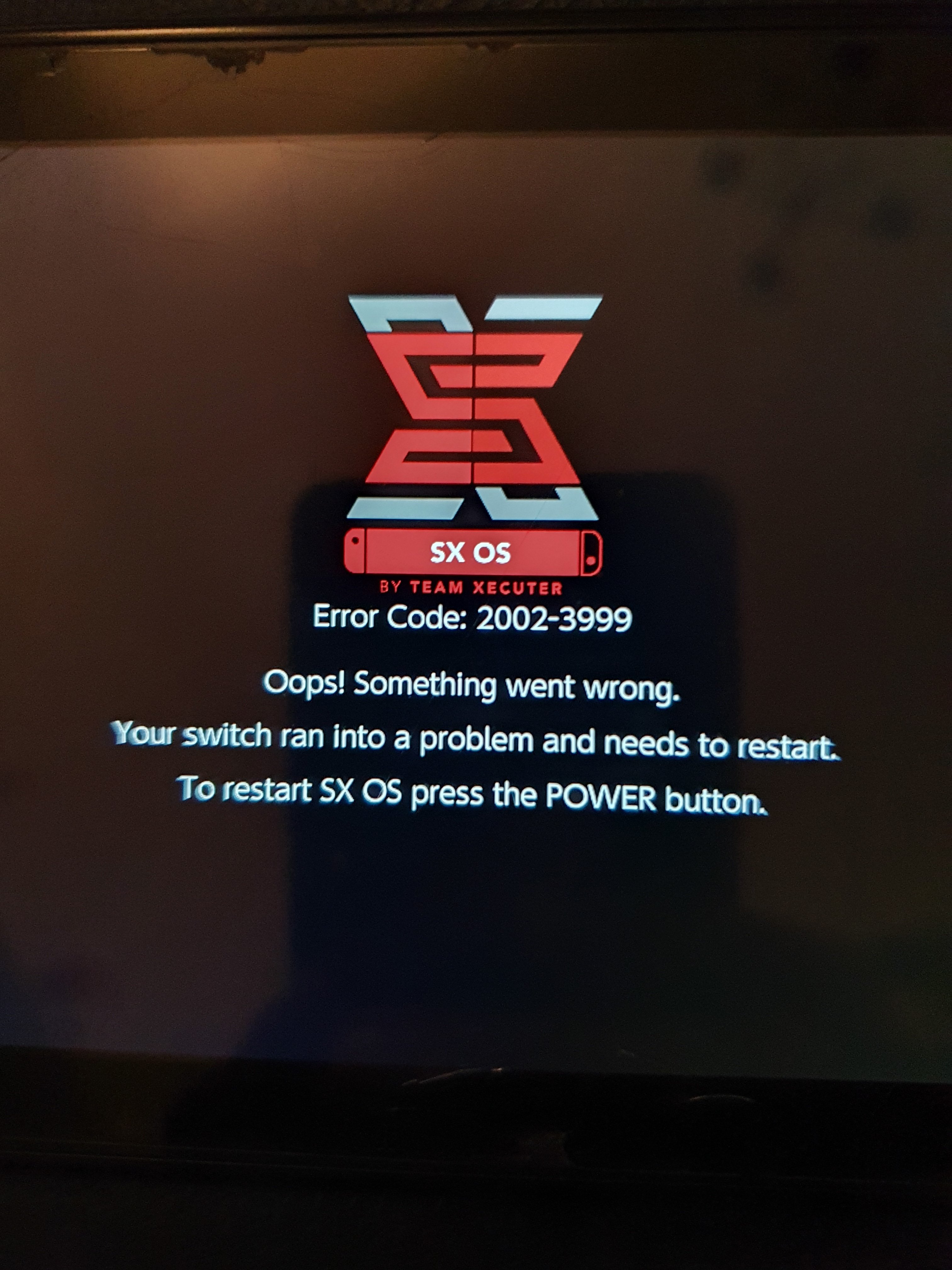

A few months ago I started getting an error on the switch - Error Code : 2002-3999. I read about this and it stated it could be the SD card or the SD card reader so I replaced the SD card reader and it seemed to work for a day but the error has come back so i'm in the process of replacing the SD card but having a nightmare! I have tried many different things as suggested but nothing has worked so far. I I tried to use Hekate to backup the old sd card BOOT0, BOOT1 and the Rawnand (emuMMC) but it gives me a file or partition not found so that didn't work (I even tried the "Fix Raw" as suggested but this was greyed out and also noticed that the partition was "disabled", I also tried using NXNandManager but didn't work either, I even tried another guide with HDD raw tool but couldn't get the rest of the unallocated partition to expand. Lastly, with all the plugging in and unplugging of the micro SD card in my pc, a message came up saying there was a problem with this disk and to click on it to scan and repair, so I accidentally clicked on it and it scanned and repaired the original micro sd card with my original Emunand, I really think since that happened it screwed up my Emunand as I now get the error above more often now. is this possible? and how can I revert back or repair it if possible?

To a certain extent. It does boot but then it comes up with this error, it has been happening more often lately....However, won't you just know it, I just booted into it and it's been stable for the last 5 or so minutes! Typical eh?? ha ha

However....I played the switch for a couple of hours and no crashes, I left it sitting for another hour and again no crashes so I thought great!! problem solved....until I picked it up and put it on the table and got the error code again! 2002-3999.
I think it happens when the switch gets a bit of a knock, has anyone else experienced this before? I replaced the SD card reader and i'm using a brand new SD Card Sandisk, could it be the pins on the board where the card reader attaches to?
