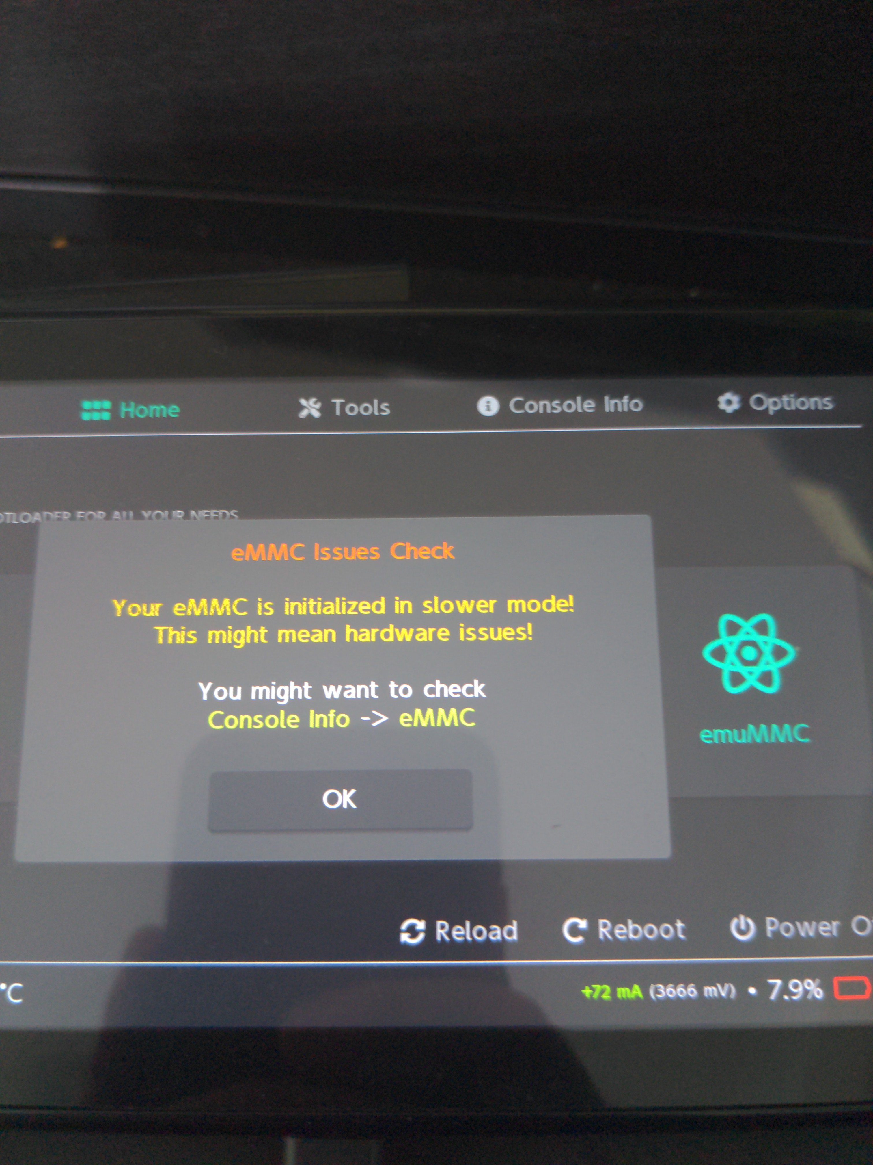

When I boot into Hekate, I get the following popup:
When I check console info -> emmc, I also get an error saying that "eMMC failed to init!"
Please let me know what else I should check, I'm really not sure where to start debugging this issue as I'm a bit of a noob still when it comes to this stuff.

Never seen this myself but it doesn’t look very promising:
https://gbatemp.net/threads/switch-v1-failed-to-init-emmc-known-good-emmc-also-fails.588419/
Boot into Hekate, go to Console Info and try to check the eMMC.
If it reports the same you most likely has a dead eMMC module.
You can replace it and recreate your NAND from scratch (if you don't have any backup) but the console will never connect to Nintendo again.

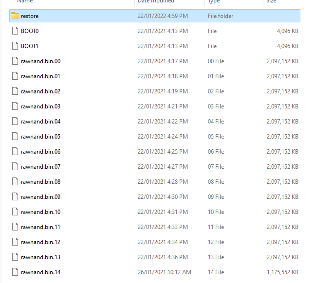

I also have this backup from when I first modded my switch:
Could I try using this to restore my emmc? Or am I misunderstanding the nature of the issue?

if you have backup, that is perfect, just order a blank switch emmc then restore the backup on it with hekate.

keep this! When you get a new eMMC chip installed you can restore everything to stock and still connect to Nintendo….most people are not this lucky.
