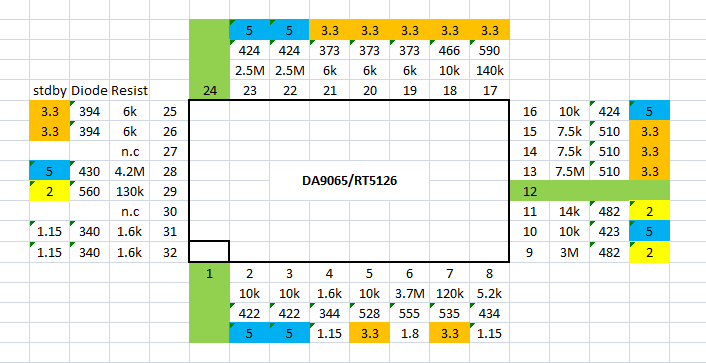

Hi, I have PS5 with EDM-010 and the console has a strange problem for me. First time No power at all and no other voltages than 5V, only 5V so no UART access. I've replaced DA9065 and have boot sequence than but console turns on with a blue light then off. Replaced DA9065 again and again have a boot sequence, this time console starts and working but when I start a game it's just turns off. Afterd that I need to replace DA9065 again to have boot sequence ( I have 2 extra chips and just put every time some of the others - chip isn't faulty - just make some like reset). Then I connect UART and see some power managment errors and see something fot the Bluetooth so decide to replace the Wi-Fi/BT module. After that again haven't boot sequence so replace DA9065 again. Then console start and works normaly. I played some games without problems, over 10 times turing on and off - working just fine everything. After couple of days played Fifa about 40 mins and console turns off. Now dead again with no boot sequence and has only 5V, no other volages and replacing DA9065 isn't working. So no UART acces because SB not powered. My question - did the SB turning on the rest power managment chips for other voltages 3.3V, 2V, 1.8V ? Should I replace the SB ? I have no shorts.
