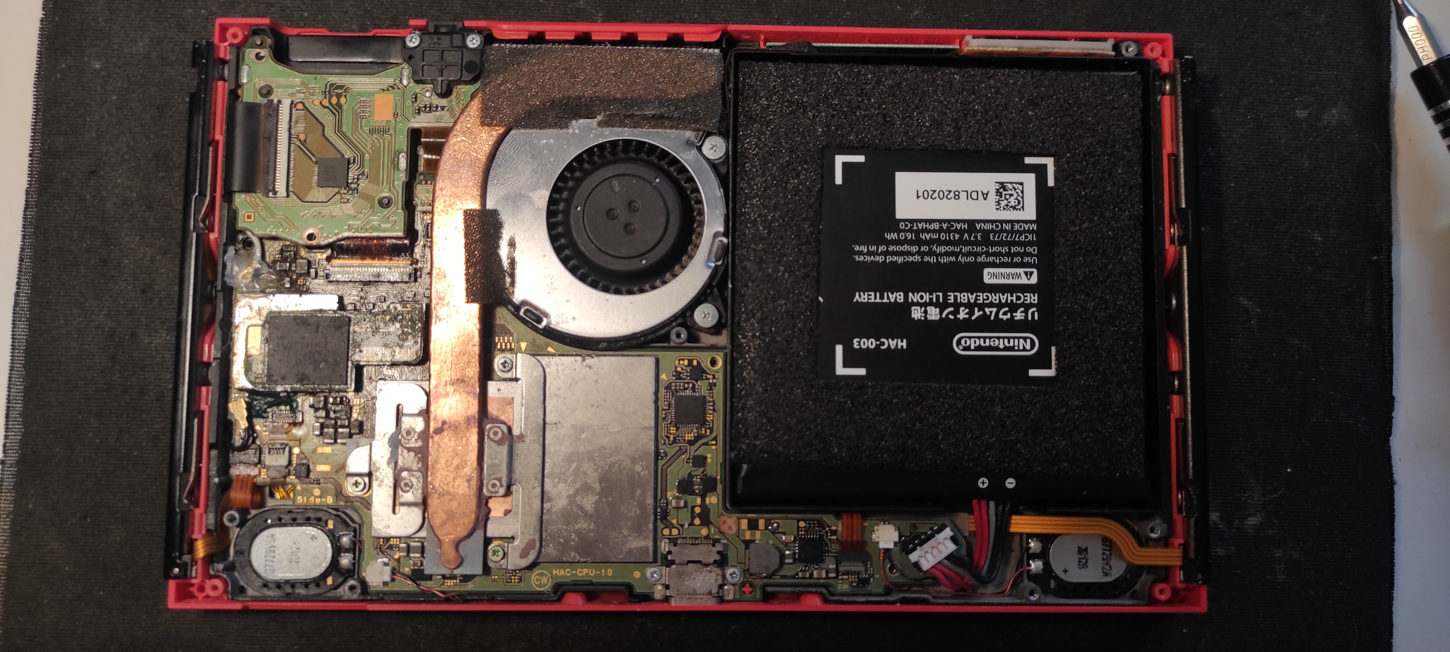

Thanks for the input guys.
I decided I would use the case for mine as it is a Mario one.
I cracked it open and it is held together with pure Hopium.
I've never seen a Switch so bad and still running!
Wow I can only imagine what my 1st switch looks like inside b/c I played 663 hours of XBC2 alone.
