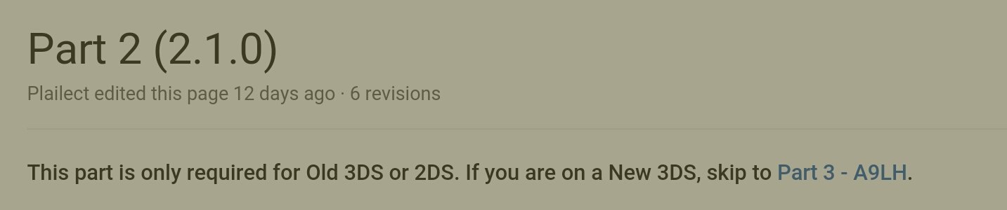

I followed the guide, up to the "Flash 10.4" step.
dgTools said "Done" on that step with 0 errors, but when I went to System Settings it still said I was on 11.1.
I don't know whether to continue the guide or to try the downgrade again.

Taken from Plailects Guide. You should be fine.

yeah, noticed that after I posted. That's what happens when I literally go line by line and don't think to check ahead.
Bad habit.
