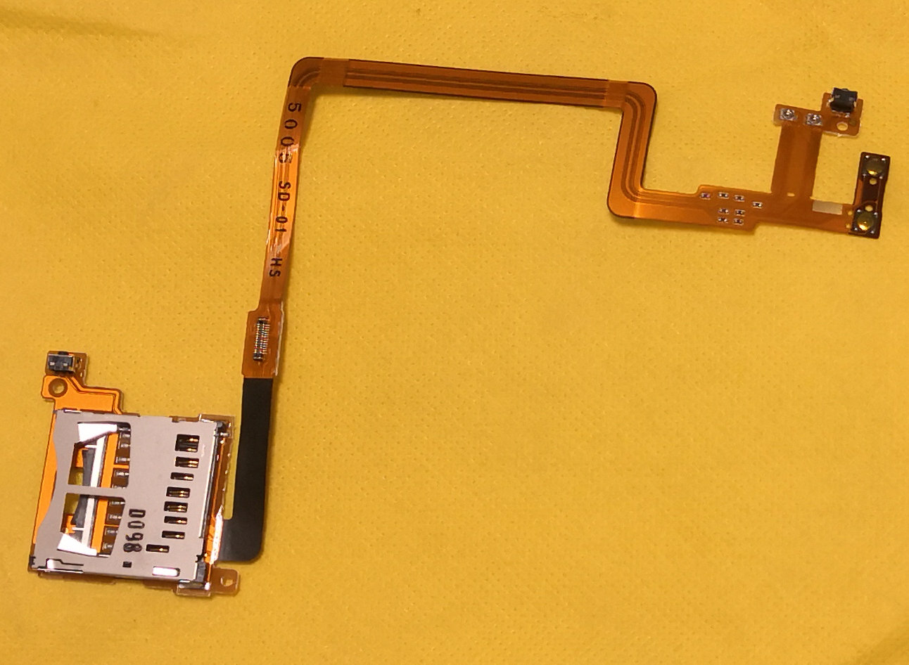

Cheapest replacement is obviously just the button/switch. Soldering it isn't easy. Tiny points. Easier (but more expensive) is the complete cable. A connector as easy to plug in as a connecting two pieces of Lego.
*Searches boxes*
Full spare part looks like this (assuming non-XL DSi model):
