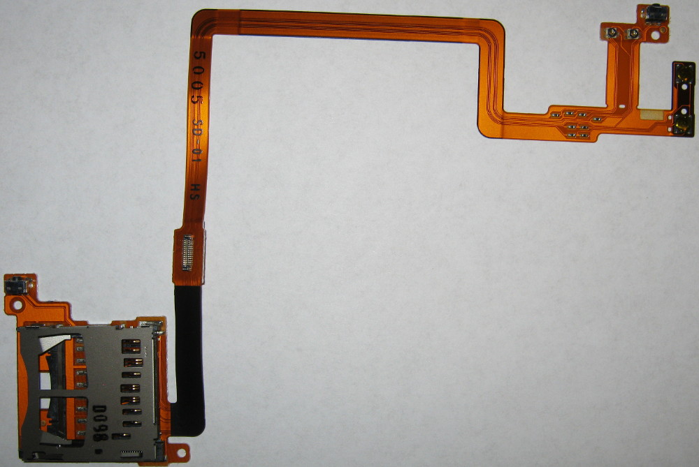

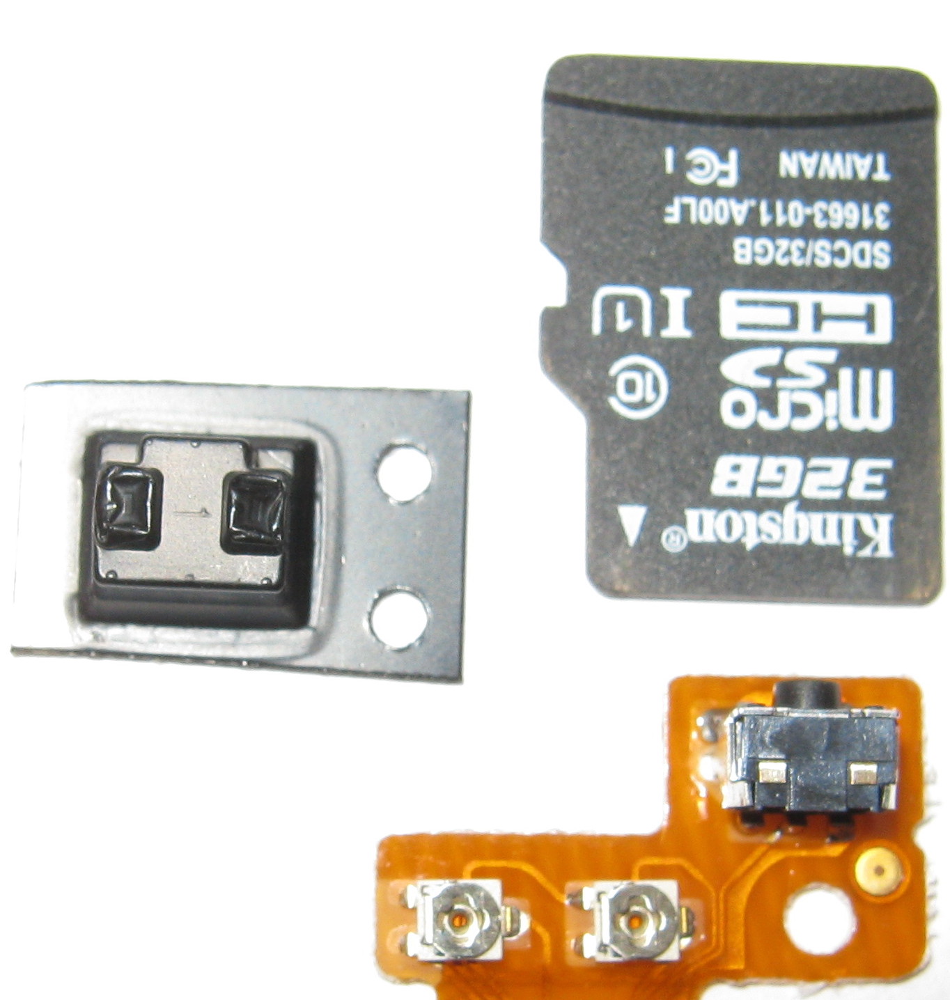

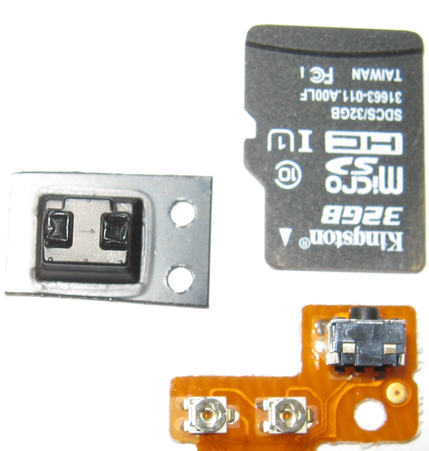

Not working shoulder buttons:
1. Cleaning method. You better be careful not to lose any parts…
2. Replacing the complete shoulder buttons, volume buttons and SD-reader assembly. Pretty easy but a bit wasteful.
3. Remove the above assembly and solder a new button in. The buttons come in some plastic I didn't remove for the photo. Picture for size comparison. Tiny points to solder…

Weird. Did you check all the ribbons and connectors? DS systems act strange when not all components are found.
