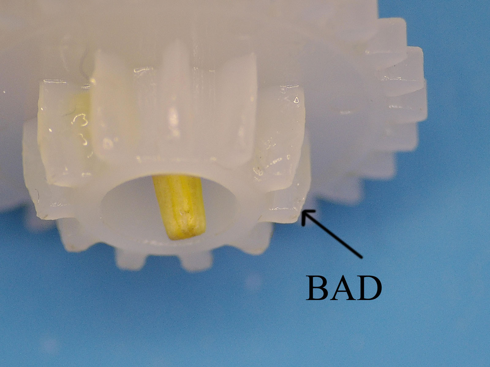

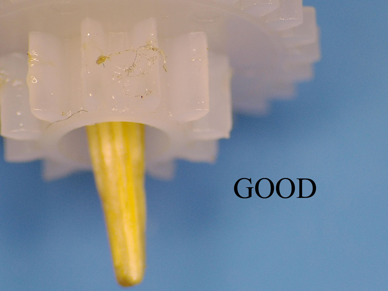

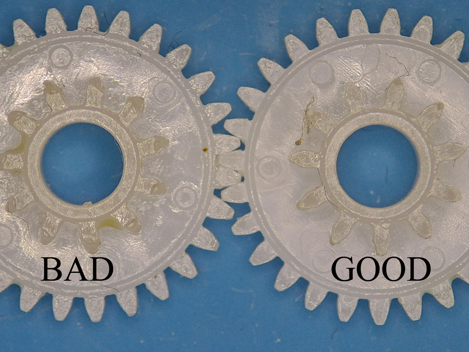

After a lot of parts swapping, i found the culprit.
On the right side of the drive, there are four gears under a white plastic mechanism. It's the biggest one, the one closest to the belt.
I'll compare it later with a working one under the microscope. Under the naked eye it seem fine.

If you find out what is the problem on the part please tell (and possibly upload a picture).

I don't know where to get a replacement gear.
Oh, looks like wear and tear... you should be able to find spare plastic gears in old DVDs

You sure is that one gear?
I had many pc cdroms, but i've throwed them a long time ago.
Yes, in my case it was that gear. I used one from a drive with the motherboard really corroded. But I plan to fix that, too, in the future.
