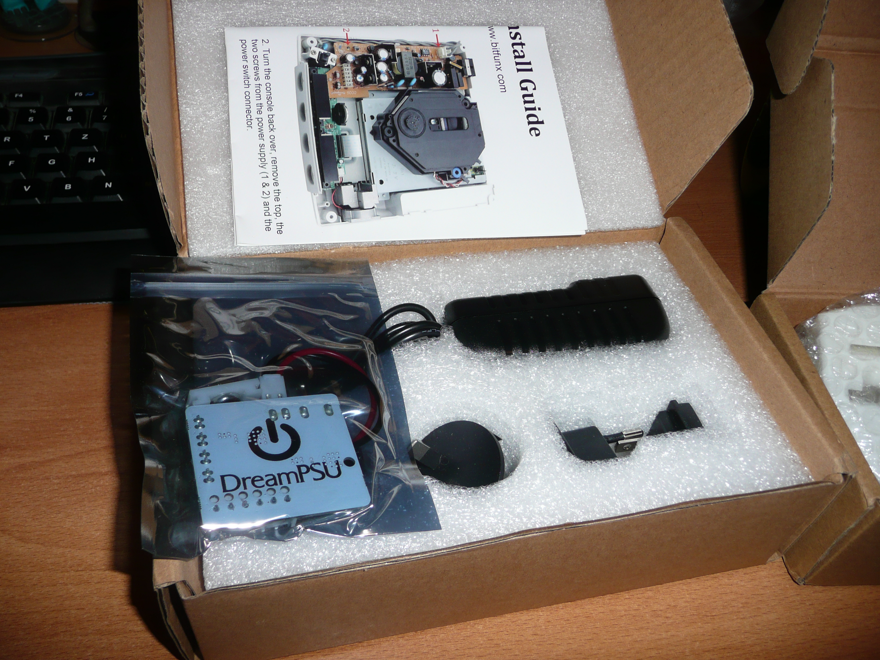

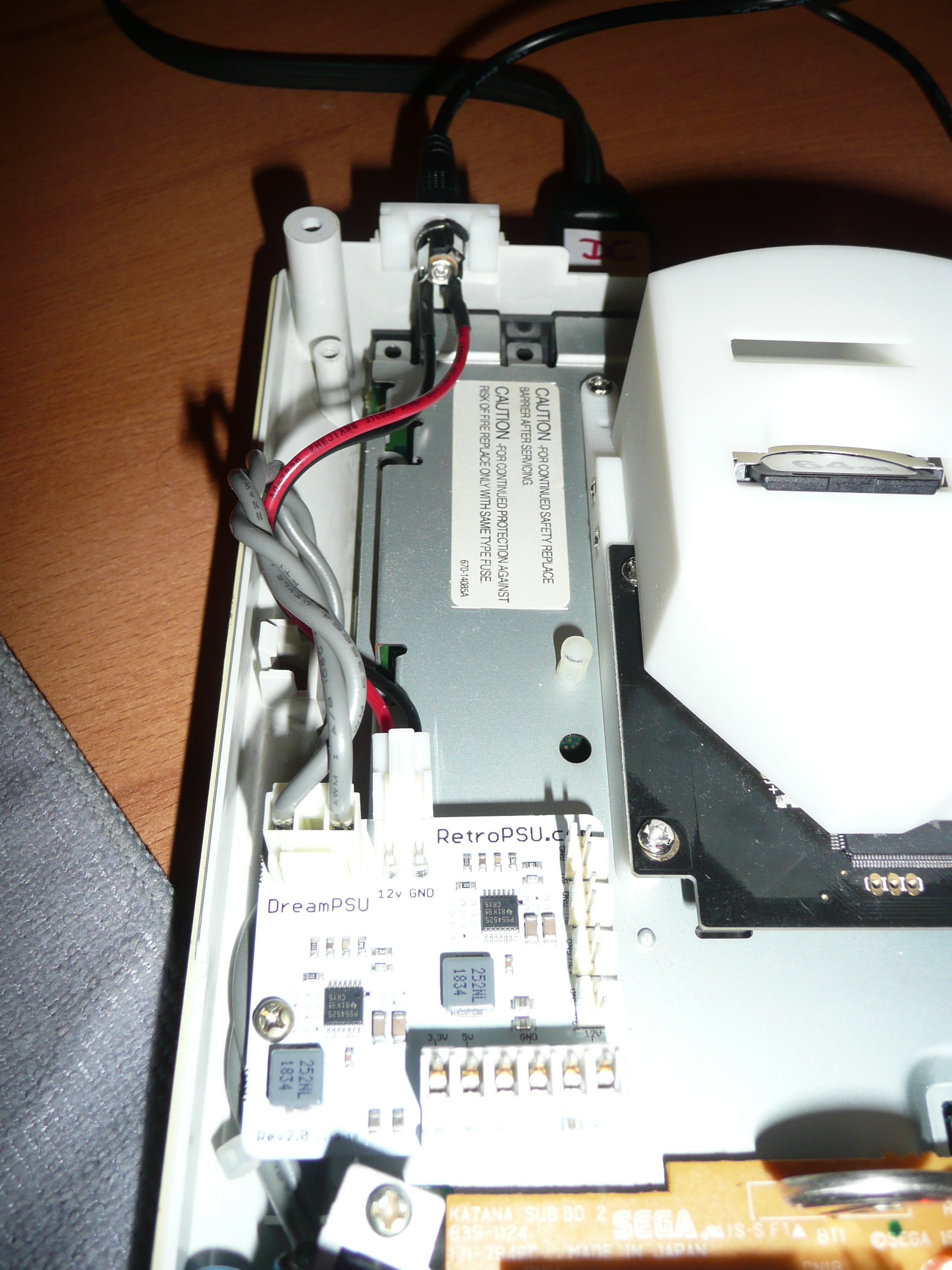

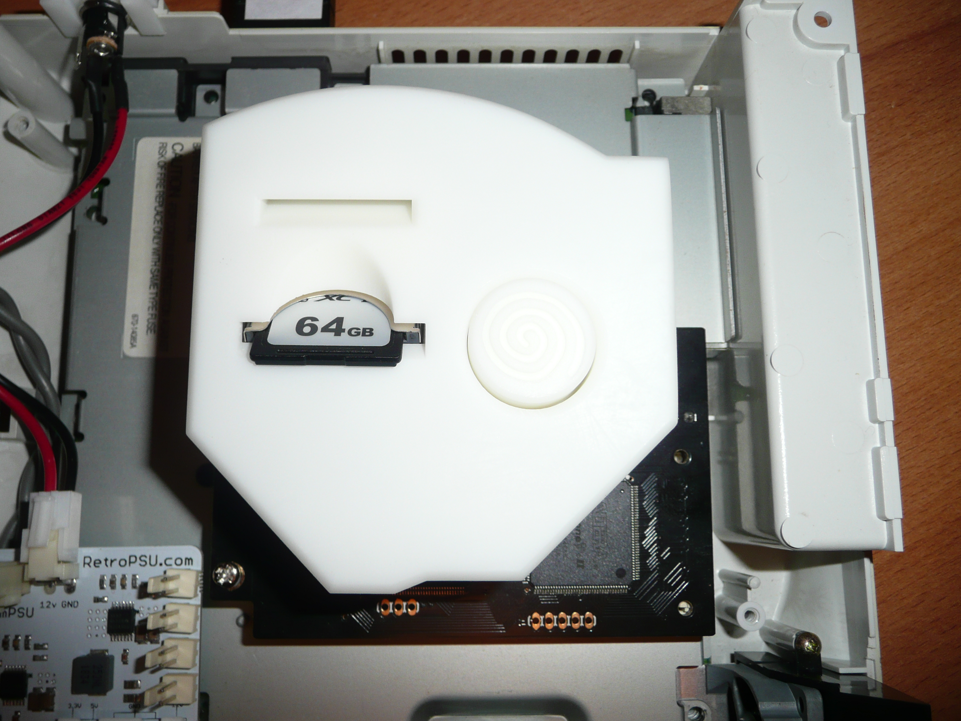

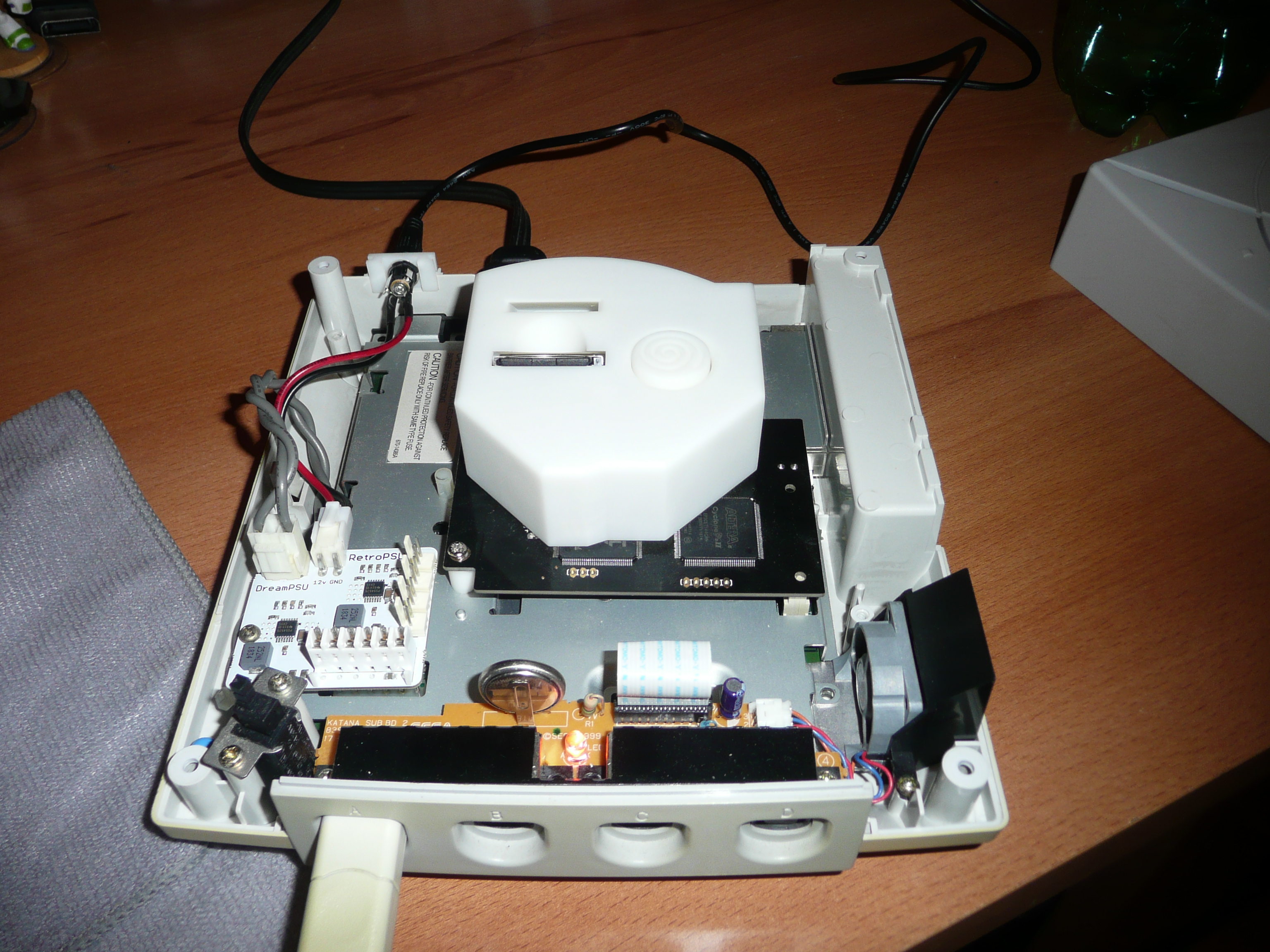

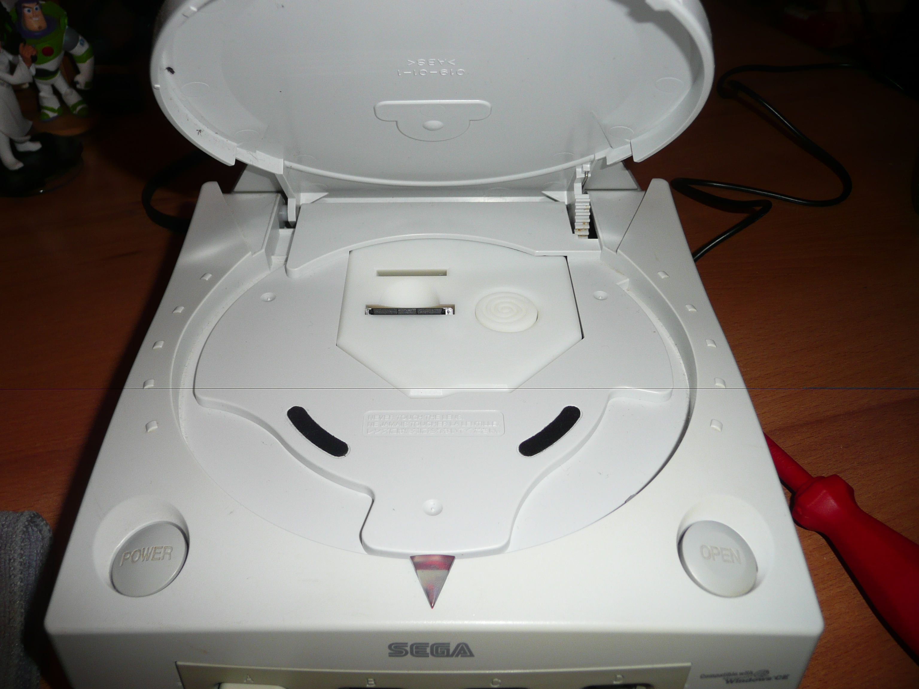

Now finished the little Modding:
Works great and guess what comes out the FAN Grid:
I think,there is now no need for the FAN Mod.I am very,very happy.cookie.gif
