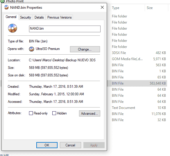

So, my exact file name is "NAND.bin" (without the quotes) and the size is 569 MB! I don't know how to upload the first 512 byte :/ I'm sorry about that
But here's a screenshot of the Properties of my file!
But here's a screenshot of the Properties of my file! View attachment 43163 View attachment 43163
569mb seems small for a NAND...I'm pretty sure they're at least 1gig but wait for d0ke to answer
I was about to say that I tried changing the extension to "NAND.BIN" all caps and it didn't work :(
I might as well be the unluckiest person when it comes to 3DS hacking LOL!
Sorry man, but if this teaches you anything it's ALWAYS make more than 1 NAND backup in case, I was just telling someone this yesterday too. However don't give up yet maybe d0ke can still save you we don't know yet
Yep that's way too small even for old 3ds.
Well crap :( Maybe! Gotta be hopeful haha!

That is a computer program, decrypt9 is perfect for making backups basically never fails just make 2 of them and you'll be sure to be safe.
The reason I think Marco had problems is probably because his sd was almost full when backing up his NAND, with decrypt9 it will start the backup and if it runs out of space it will fail...but it will ALMOST look like it completed. It says error or wtv but if your not paying attention it could just look like it completed. And it leaves a partial NAND backup on sd, maybe @d0k3 can add some red writing when it fails? Or maybe delete the partial NAND backup if failure.

The others are right. With that size there is no hope for that NAND backup, and it is almost impossible you got that without an error message. Is your problem that you are on 2.1 now and don't know about a way back up? If it is, check if there's something in Plailects guide for that issue. Also, ask around on #3dshacks over at rizon, maybe someone can help.
