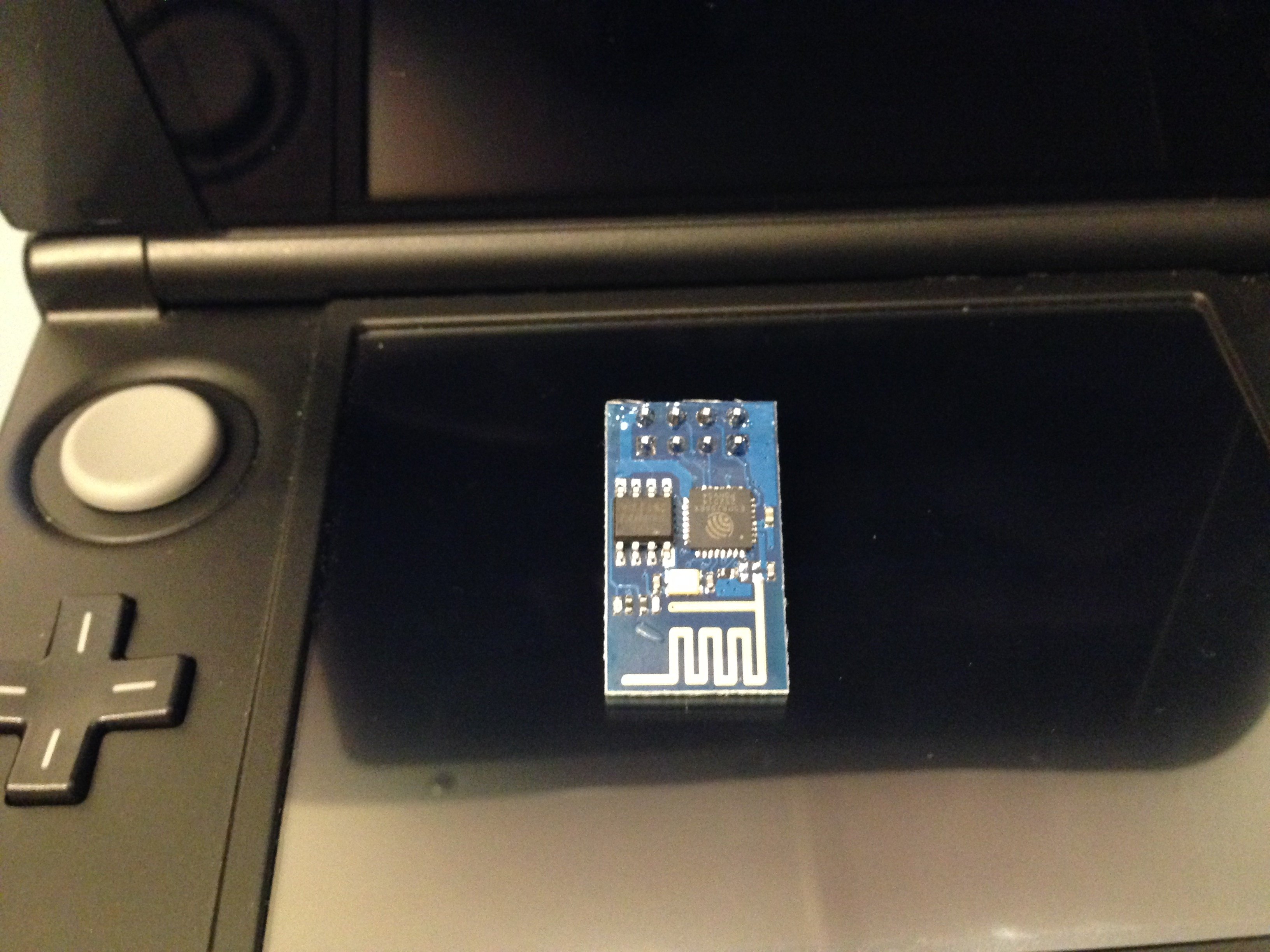

So there are currently two ways to get into Gateway stuff, downgrading to 4.5 and using the profile exploit, or using the webbrowser exploit that requires an accesspoint.
Now i'm thinking about if I want to live with the savegame crypto (and maybe other?) problems and go with the downgrade, or do a kinda easy hardware mod.
Idea is to build an esp8266 module (image attached) into my 3DS-XL. There should be more than enough room, and the only thing I need would be a 3.3V point that can deliver up to 50mA (100mA bursts) for a short time (module would go to sleep after a while, so it doesn't drain the 3DS battery).
The esp8266 basically is a super cheap and tiny wifi module with integrated microcontroller, and I already got an http server with accesspoint working on it, and already got gateway launched that way. So the only thing I need to do this is basically some information on where I can get enough power (@3.3V) inside the 3DS-XL (ideally always on, even in standby, but not if device is powered off completely).
Also i'd be interested if you think this is a nice idea, so I created a little poll for you to vote ;)
And please don't ask why I don't use $app, or carry something else with me, I kinda want my 3DS to be a dedicated device...
Edit: I've now actually done the hardware mod, see my post with picture here

Not sure if i wasn't clear enough: This device creates an Wireless AccessPoint that hosts something like go.gateway-3ds.com, without any internet connection, and always ready when powering on the 3ds, so you don't need to do anything else than press the Internet Browser icon on the 3ds to access gateway, even if not at home, and no internet anywhere near. Also since there is never a connection to the internet you can't accidently update the 3ds over this connection.

Yea the moment you power on the 3ds it would power on the device, and it will instantly start broadcasting it's SSID, and stop after a few minutes or the moment the last file for the exploit is loaded from the webserver. Is really like "Power on -> press internet browser icon -> gateway" and that everywhere. If you accidently leave gateway mode you'd just need to power off the 3ds and power it on again, and it would be ready again. No actual connection to anything than power on the 3ds itself.
Well, I don't know if the "BUT" is that big, it's a very easy mod, and easy to remove, as it just needs two wires for power, not even a connection to the outside, even the nand mod is a lot more complicated, and I've done that without any problems ;)
I don't want to sell it, the chip itself can be bought for around 5$, to program it you need a UART adapter that costs around 2$, and the software is free (I'm using esp-httpd).

...So the only thing I need to do this is basically some information on where I can get enough power (@3.3V) inside the 3DS-XL (ideally always on, even in standby, but not if device is powered off completely)...
Check out this: http://3dbrew.org/wiki/Gamecards
The cartridge slot on any DS/DSi/3DS/etc has 3.3v VCC on Pin 8.
Considering how sleep mode works mid-game I assume pin 8 is always powered as long as system isn't fully powered off.
The real question is, can a retail cart and/or gateway share power with your esp8266 and cause a malfunction or damage anything.
I would be VERY interested in the results of your testing.

mh, guess i'll look at the pins of the sdcard slot too, they are kinda hard to get to (battery connector next to it) but if it provides enough power for the wifi sdcards my little wifi module should work too.
Since the gamecards only contain data and not memory that has to be kept active I don't think they really need to be powered in sleepmode, but i'll take a look at that! thanks for the idea.
