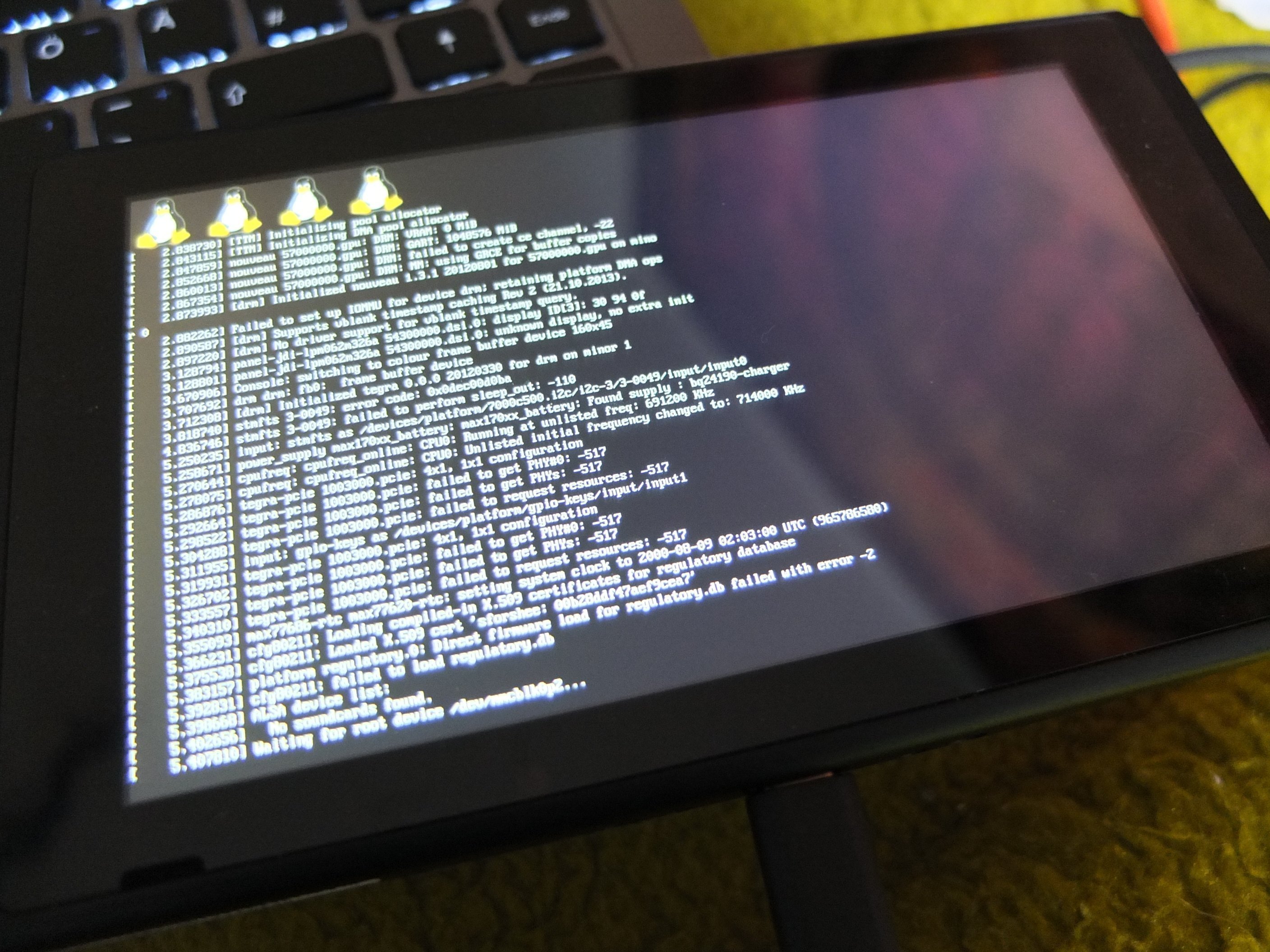

Thanks nold, this is a very helpful repo and I've booted the Linux kernel successfully. What isn't currently working is the SD card - I'm using a 64GB SanDisk and the kernel panics with "mmc0 timeout waiting for hardware interrupt". I'd expect the card to work, I took it from my action camera and reformatted it, but it seems to not like something about it.
Do you formated it with two partitions? You need two, one first in fat32 and other in ext4.
Yep, although it occurs to me that I didn't actually format the fat32 partition. I'll give that a try.
Edit: Yup, looks like that was it. Userland is booting now. Thanks!
