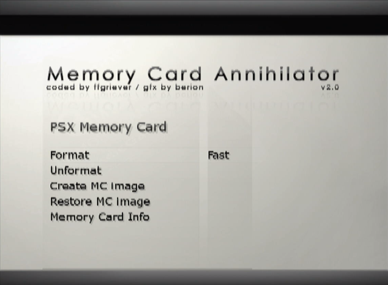

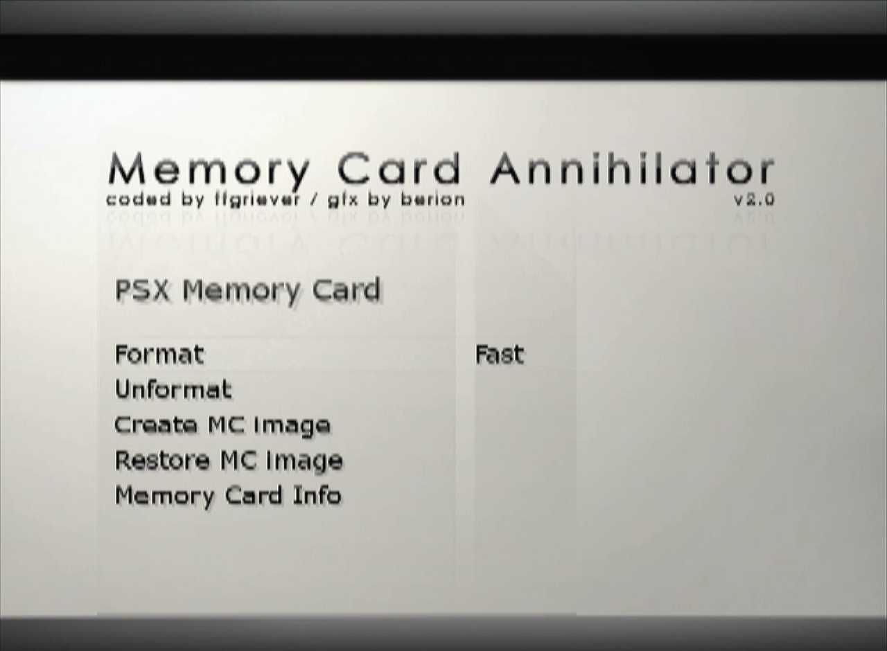

Does anyone know if there is a homebrew application for PS2 that I can use to prep a PlayStation memory card for this exploit? Using an Arduino to program the memory card seems excessive so I'm curious if there's an easier way.
To answer my own question, the README for Freepsxboot was updated to explain that the app "Memory Card Annihilator v2.0" can do this.
After testing it, I can say it works. You must change the file extension of the .mcd file to .mcr, then Memory Card Annihilator will recognize it and you can restore it to the memory card.

How did it show up in annihiltor as my mem card does not show up just freezes the program when mem card inserted
I opened the homebrew and i connected the memory card after the program opened and it got recognized.

Mine doesn't recognise just freezes out the app
Always read the README, it clearly states this can be an issue.
  • Once installed, it may become difficult to uninstall, as the normal software to re-format a memory card won't work, due to the exploit itself. You could end up with no means to recover the memory card; if for example your installation method was Memory Card Annihilator v2, as it will also crash. If you happen to own a game that shows the memory card's content before creating a save file like Cool Boarders 4, chances are you can recover your card's normal functionality by overwriting the exploit with the game's save.

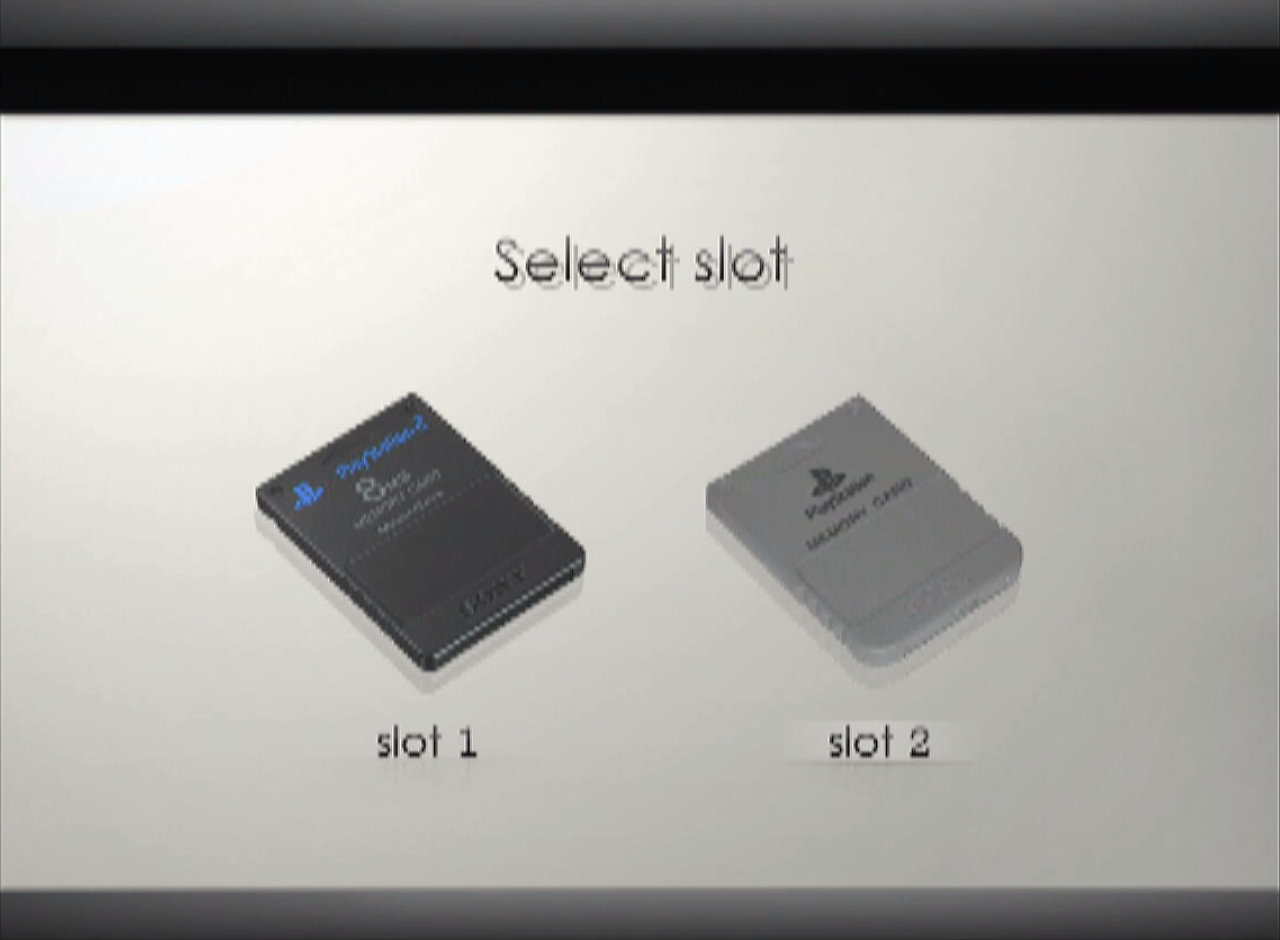

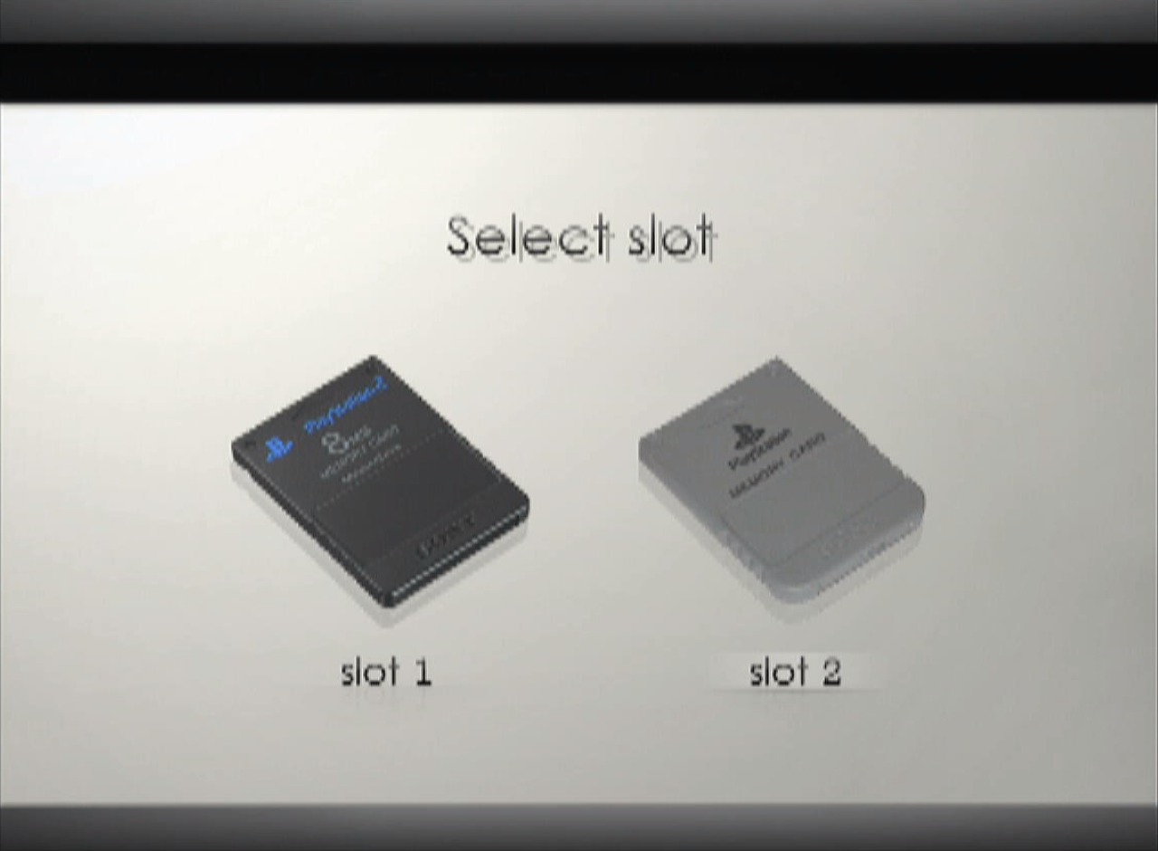

Edit: It may also be worth nothing that on my card using using the
"freepsxboot-unirom-20210412-7001-7002-7500-7501-7502-7503-9001-9002-9003.mcd"
version of FreePSXBoot, I have absolutely no problems reformatting the card via MCA, slot 2 in my screenshot below:

I just tested this, I was able to reformat the card with MCAv2 on my 500x PAL PS2.
First time I inserted the card in slot 1 it crashed, so I rebooted the console and tried slot 2 and was able to reformat.
Tried again with a different third party card and I was able to reformat using slot 1.
Tried copying a save from my PS2's HDD and it copied over fine and it SEEMS ok when loading from the PS1 both MCM and in game, but be cautious until others can verify.
