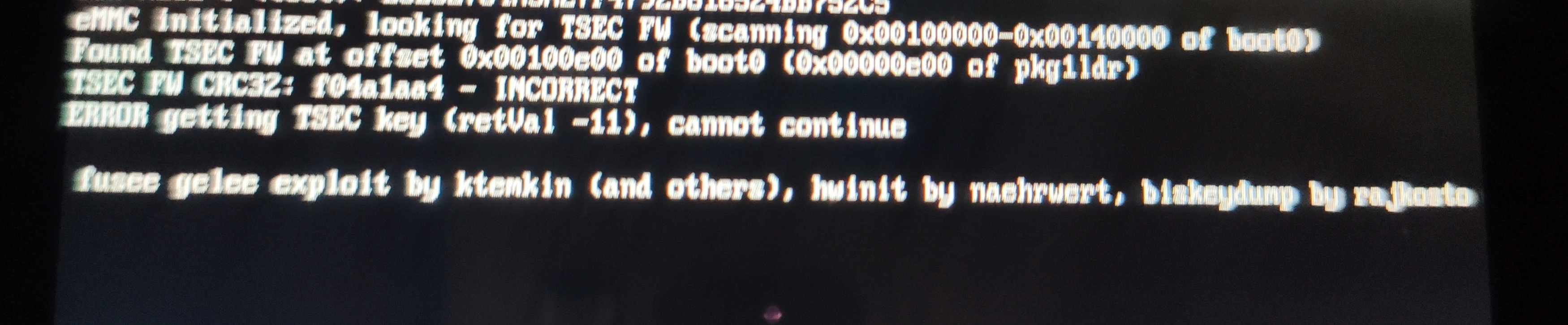

right now im seeing this on the screen when running the payload from the guide i shared
the switch gave an error about the sd not being mounted, pressed any key and the hekate menu appered, i dissabled one option that said autorcm mode and not the switch finally turn on nomally, thank you all so much for you help.
