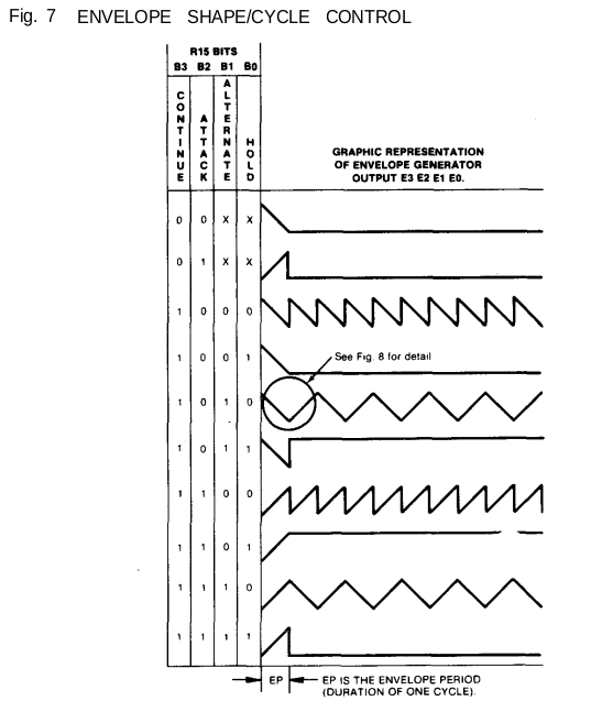

For those that are curious... Sound Envelopes are supported by the AY sound chip (but not the Colecovision SN sound chip). This allows a programmer to set a pattern and the chip will automatically change the volume over time to produce sound effects. This can be a rising tone, falling tone, oscillating tone, etc. Here is the AY envelop shape chart direct from the datasheet for the chip. I'm emulating all this now - but I don't have the timing quite right so the sounds might end a little sooner or extend a bit longer due to the way I'm clocking the envelope counter. I think I can fix this.
