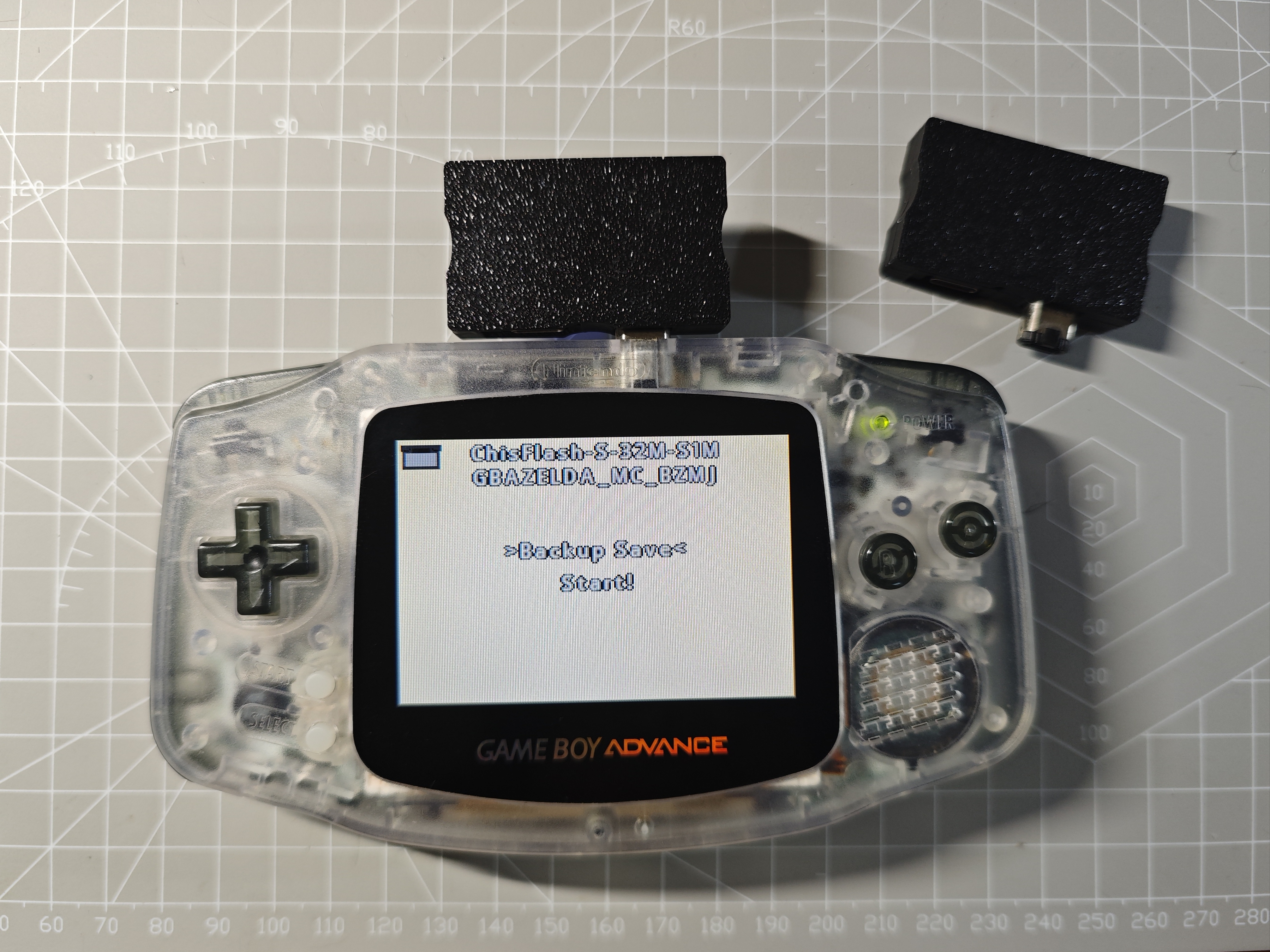

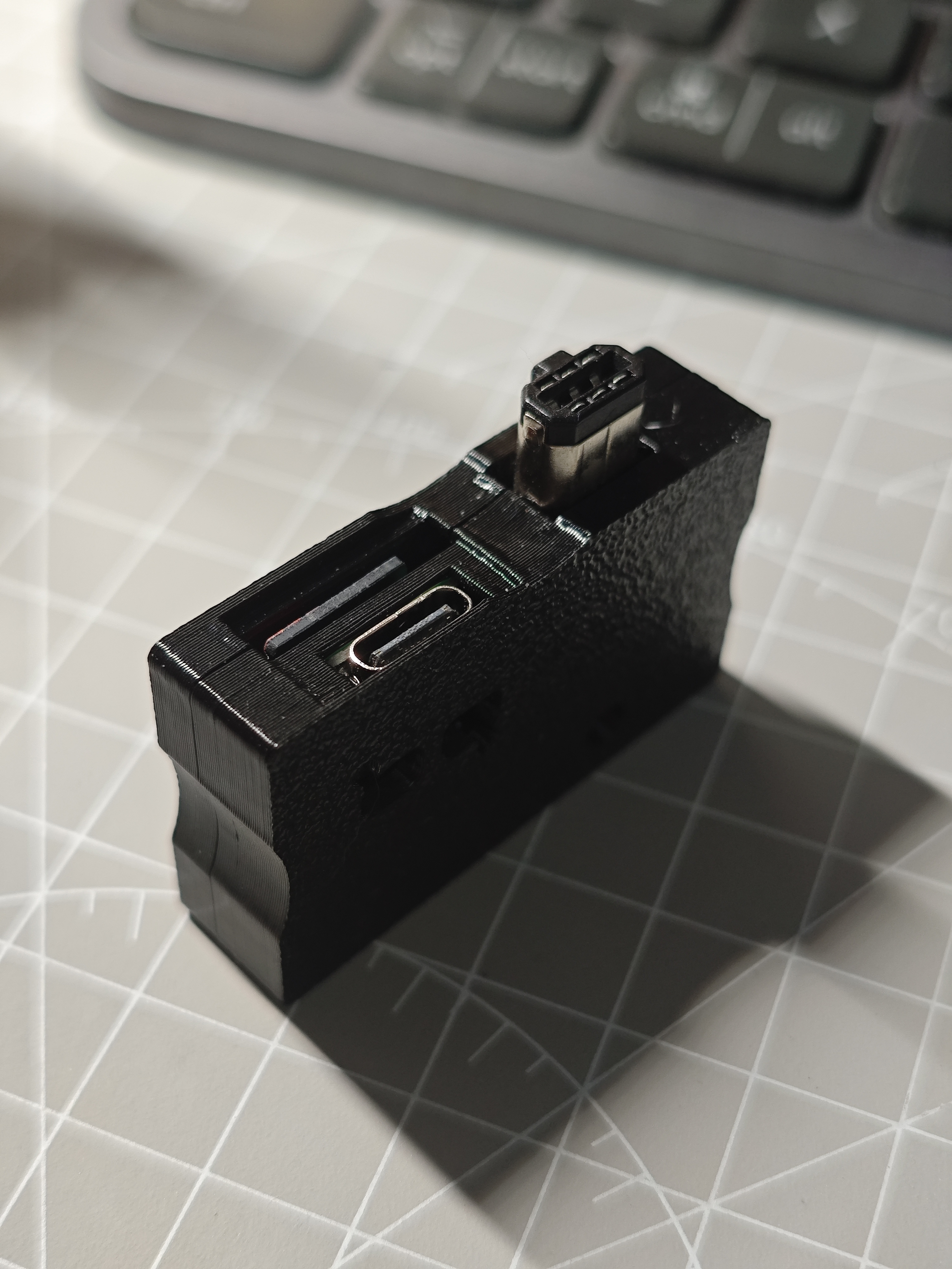

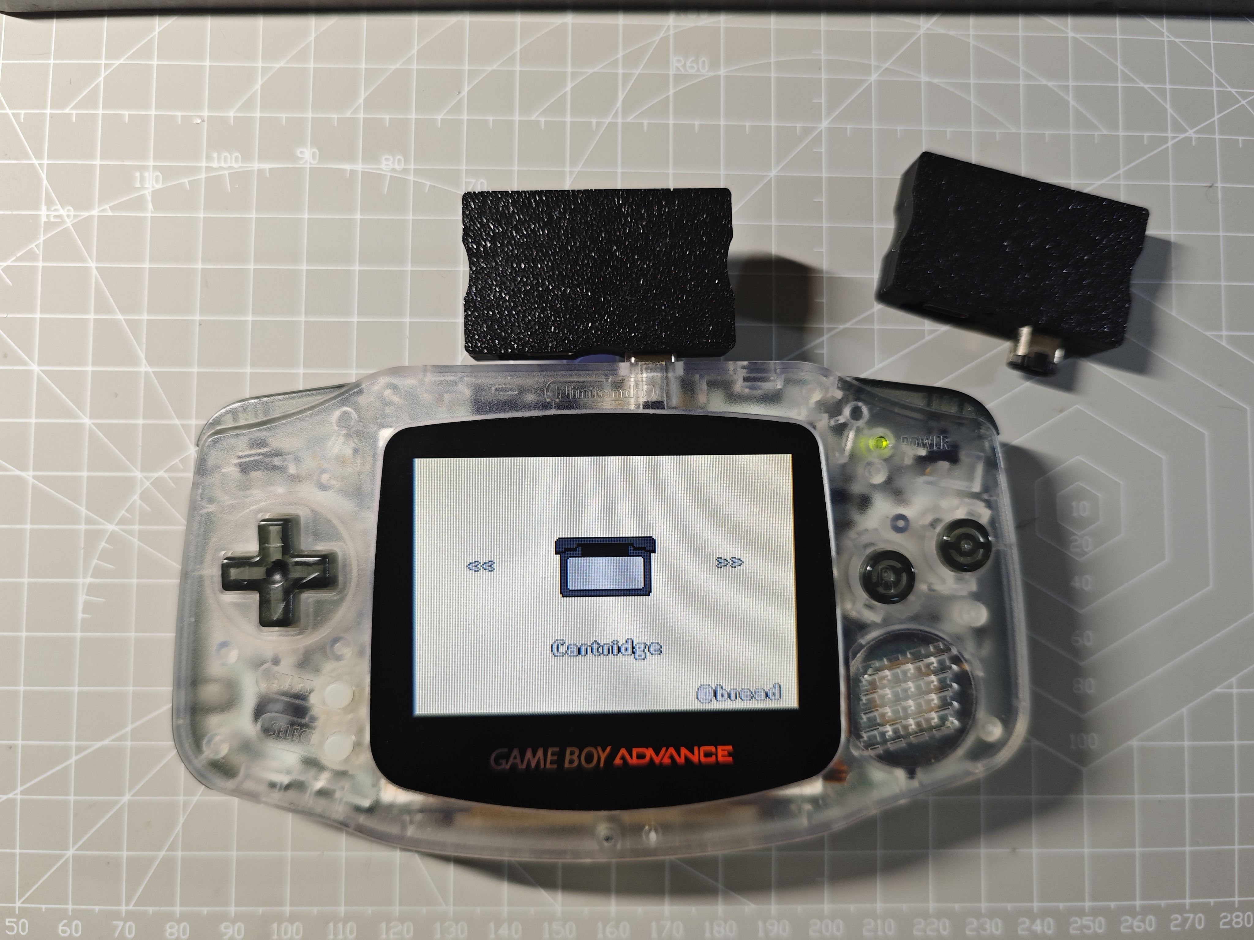

In the past two months, I have been working hard for ChisLink, hoping to get rid of my dependence on burners and NDS.
Fortunately, ChisLink exceeded my expectations.

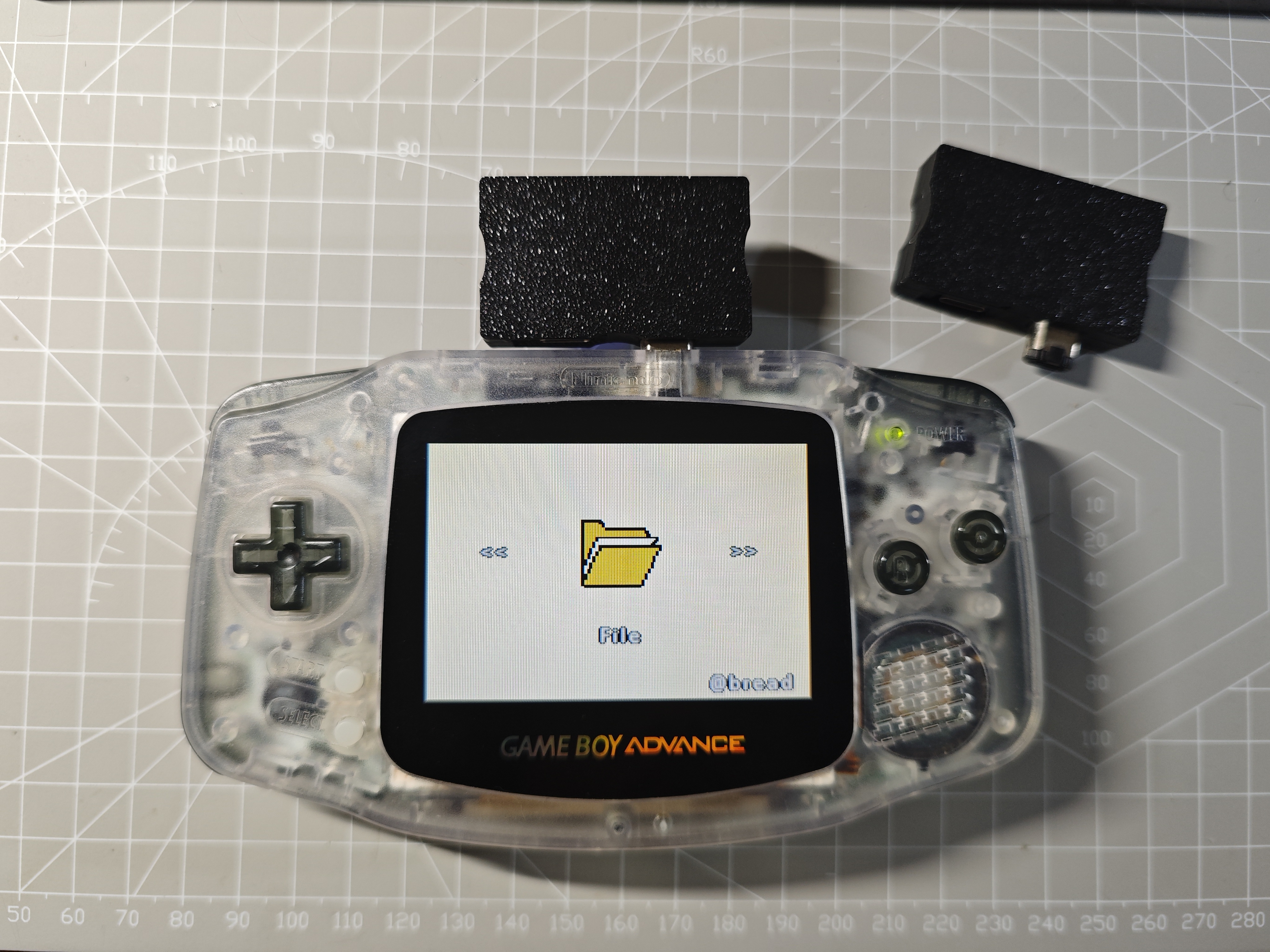

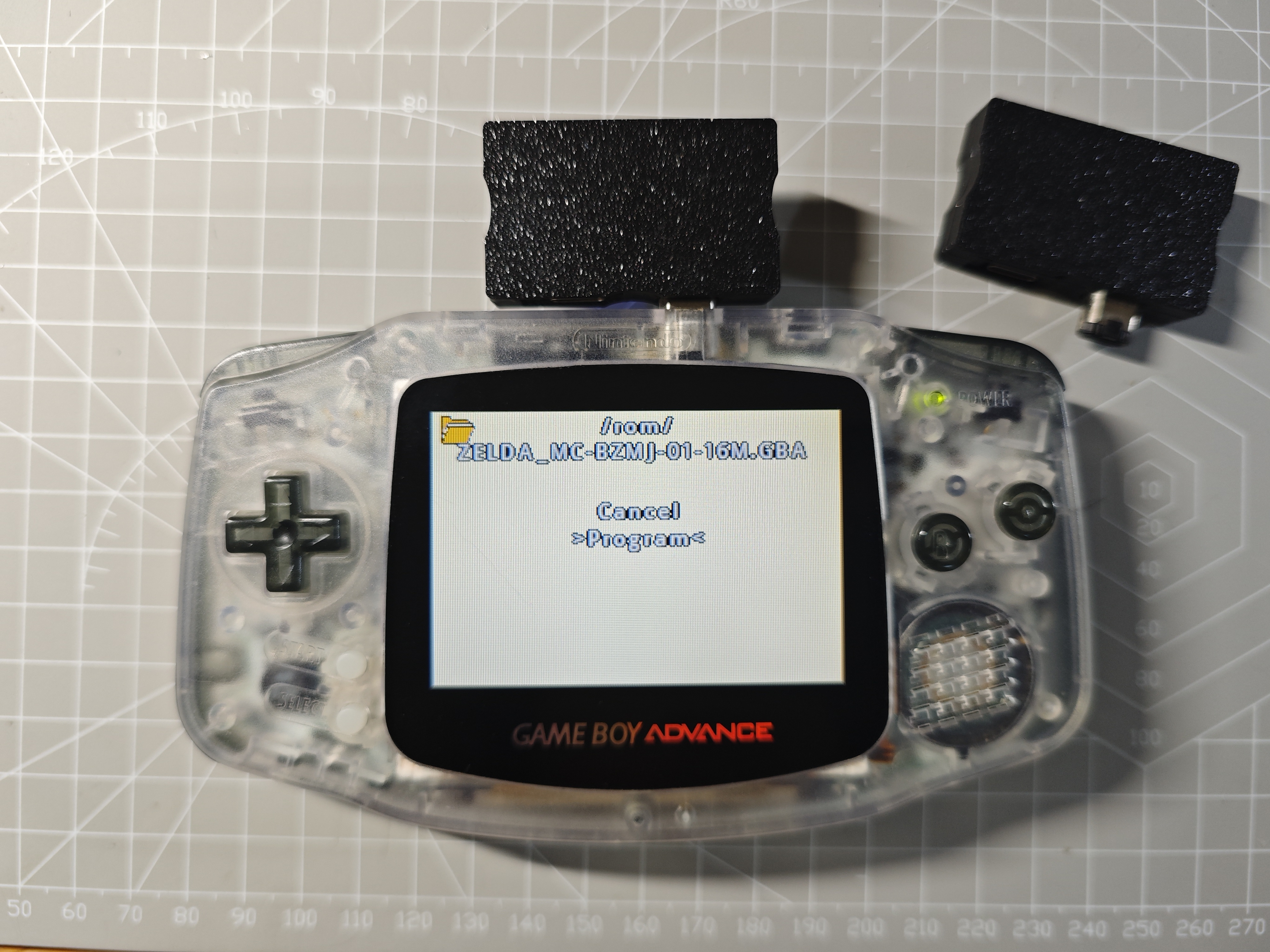

1. With only GBA and ChisLink, I can replace the games in Flashcart anytime and anywhere. Even a 32MB ROM only takes about 10 minutes.
2. EEPROM, SRAM, Flash and even Batteryless SRAM can use ChisLink to backup and restore saves.

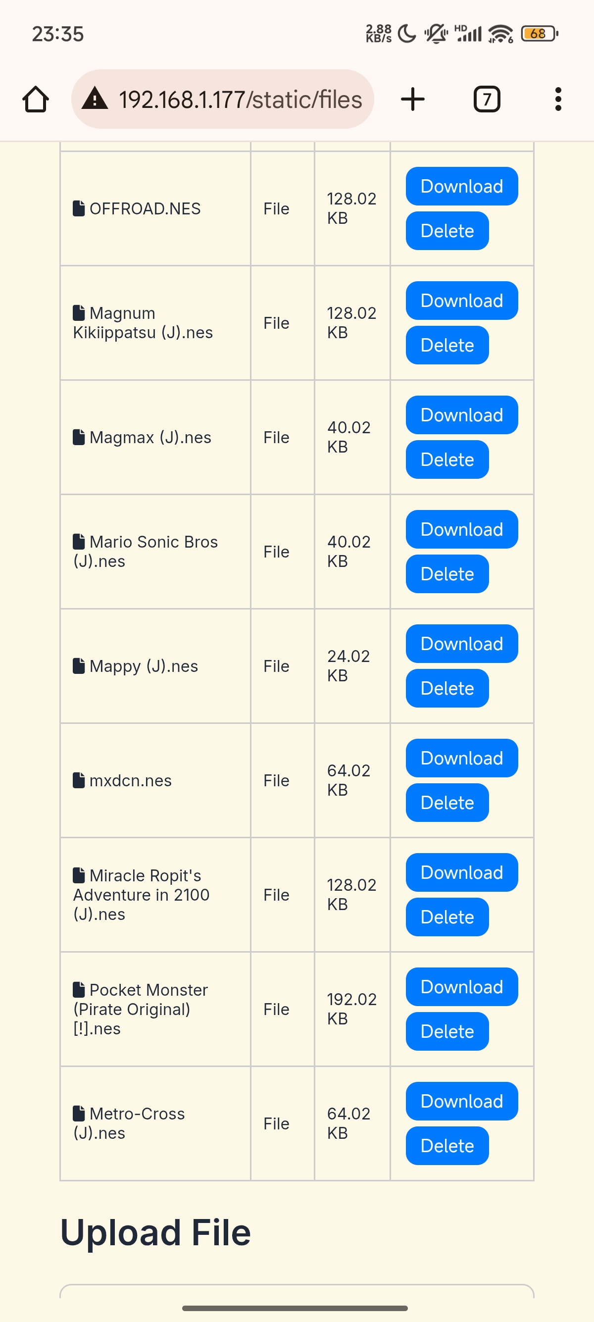

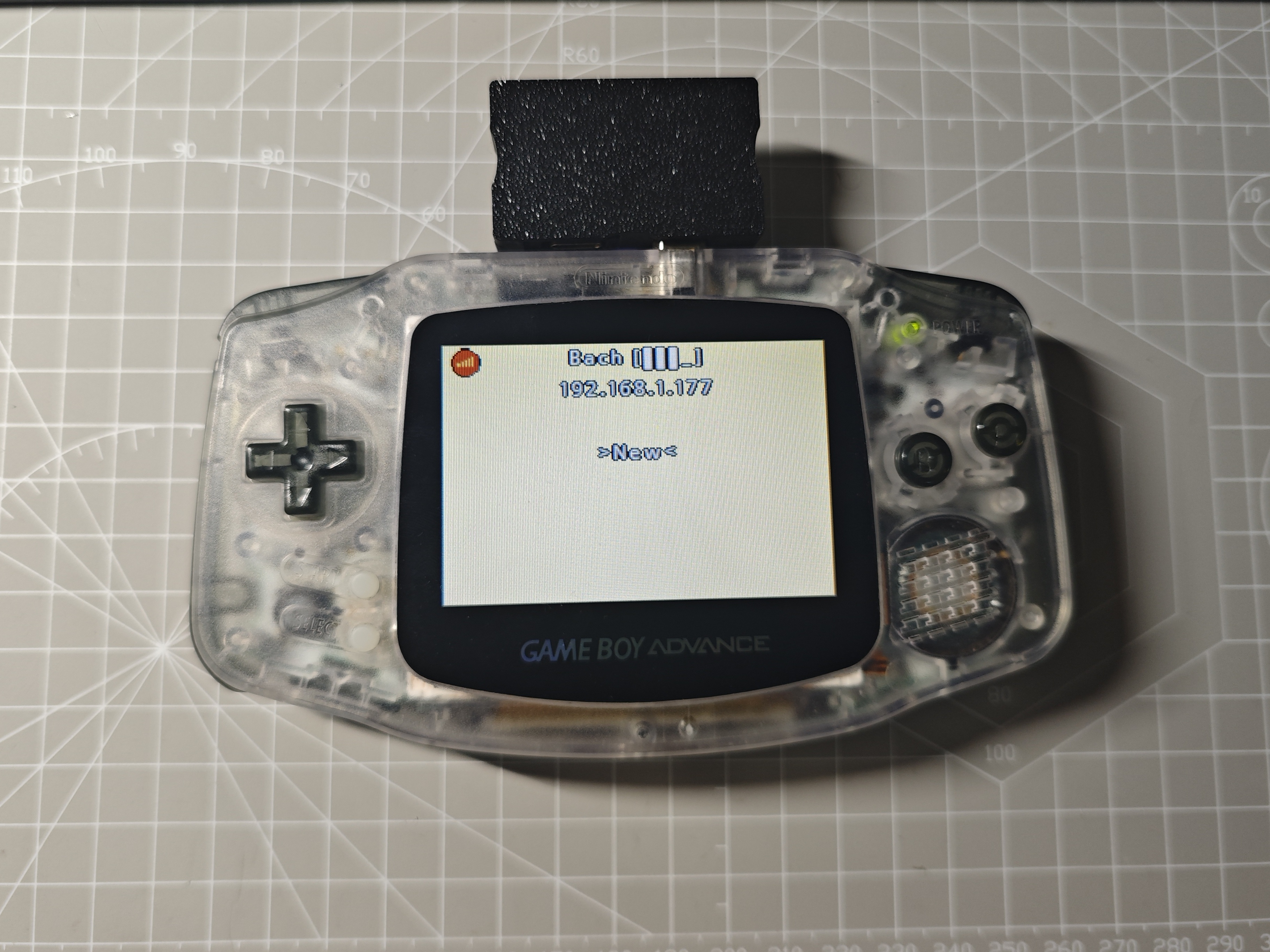

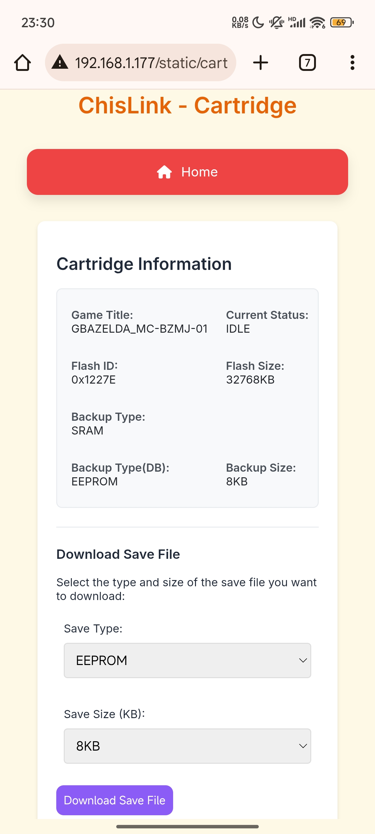

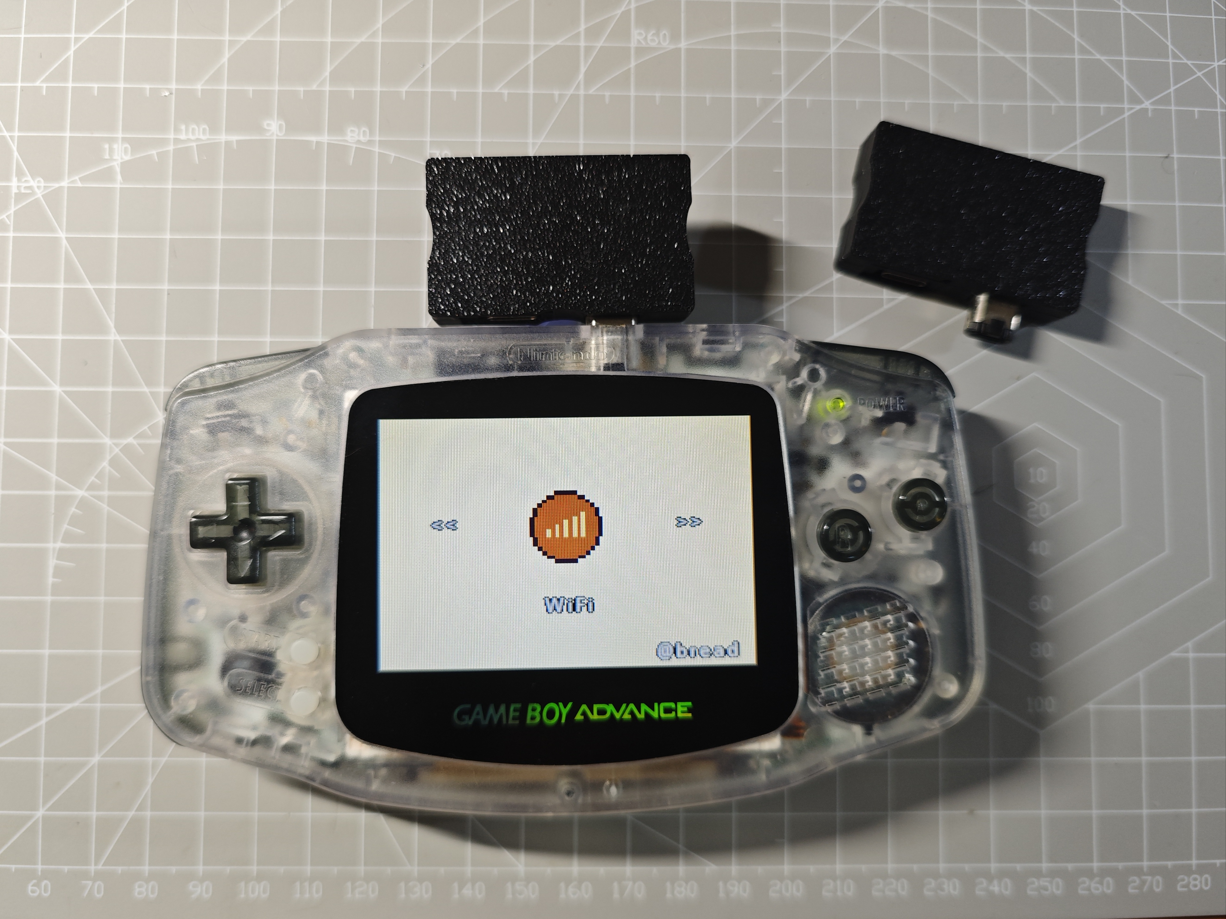

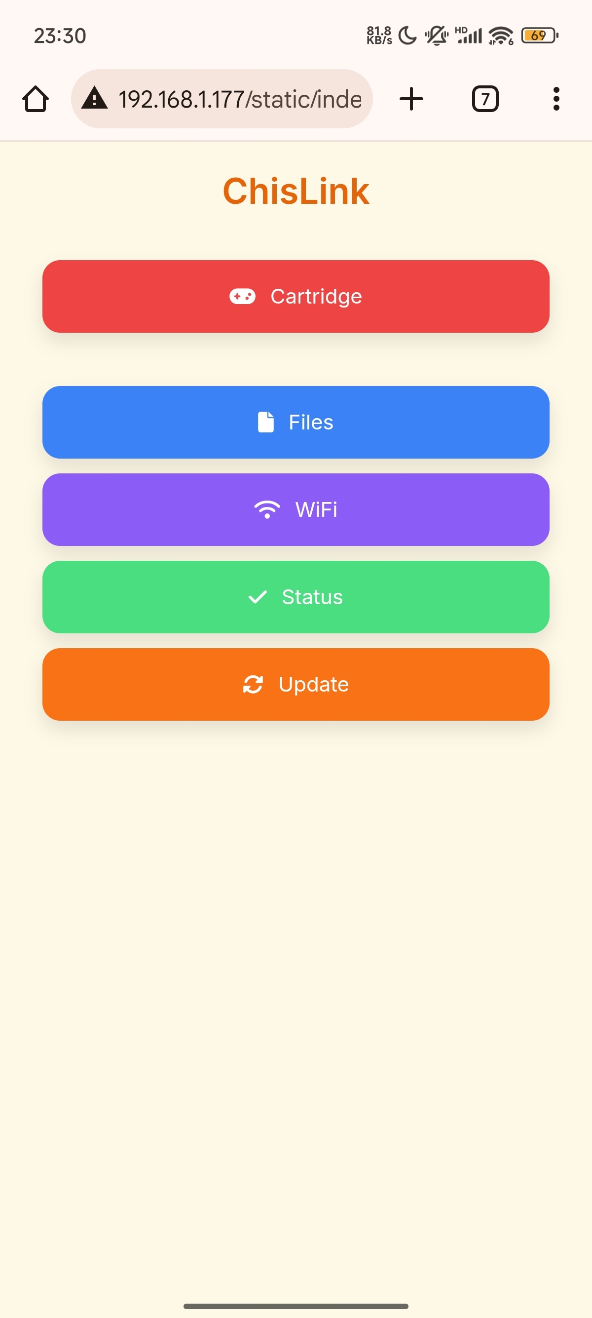

3. Support 2.4G WiFi, you can access ChisLink and GBA via the Web.

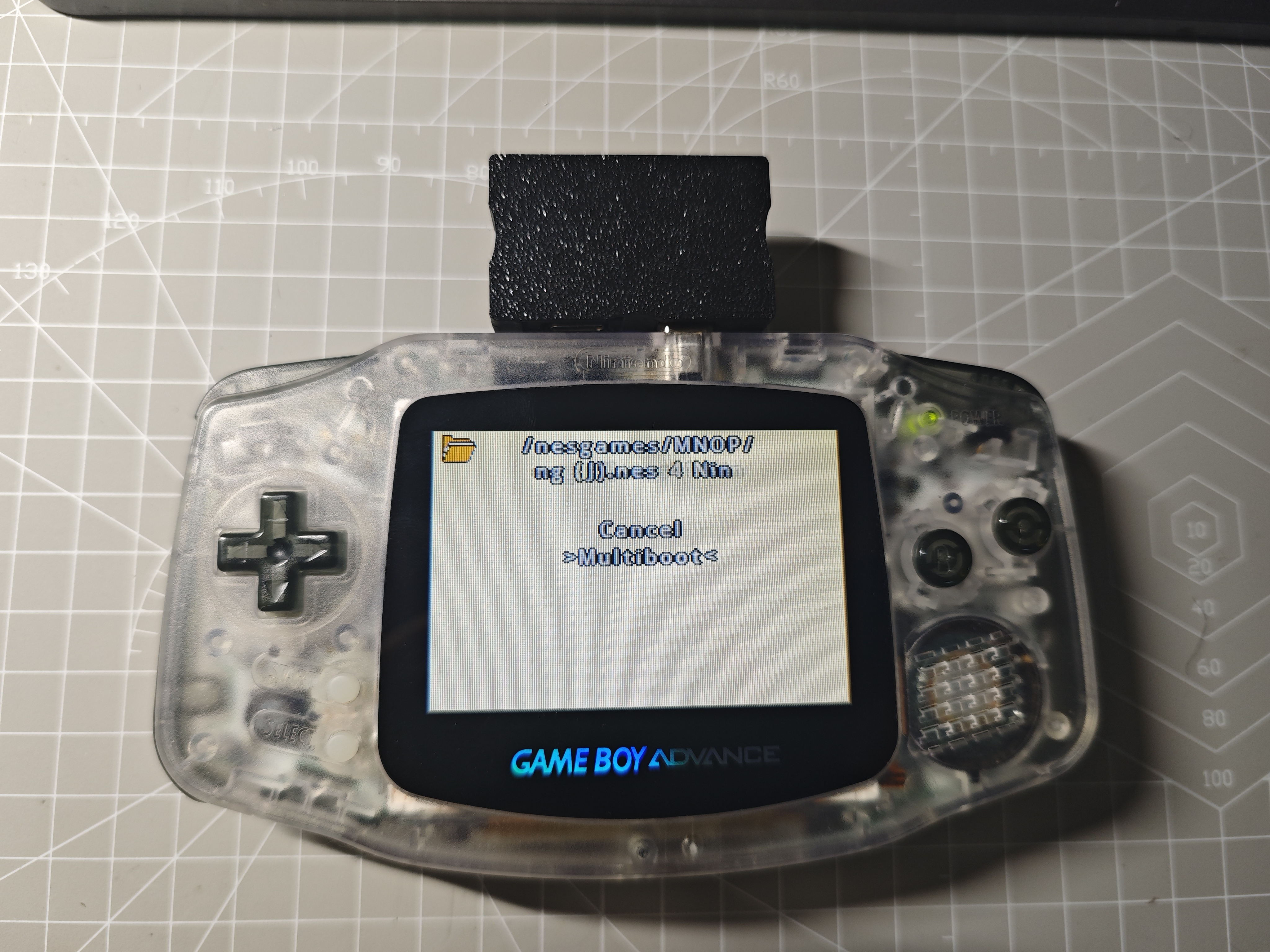

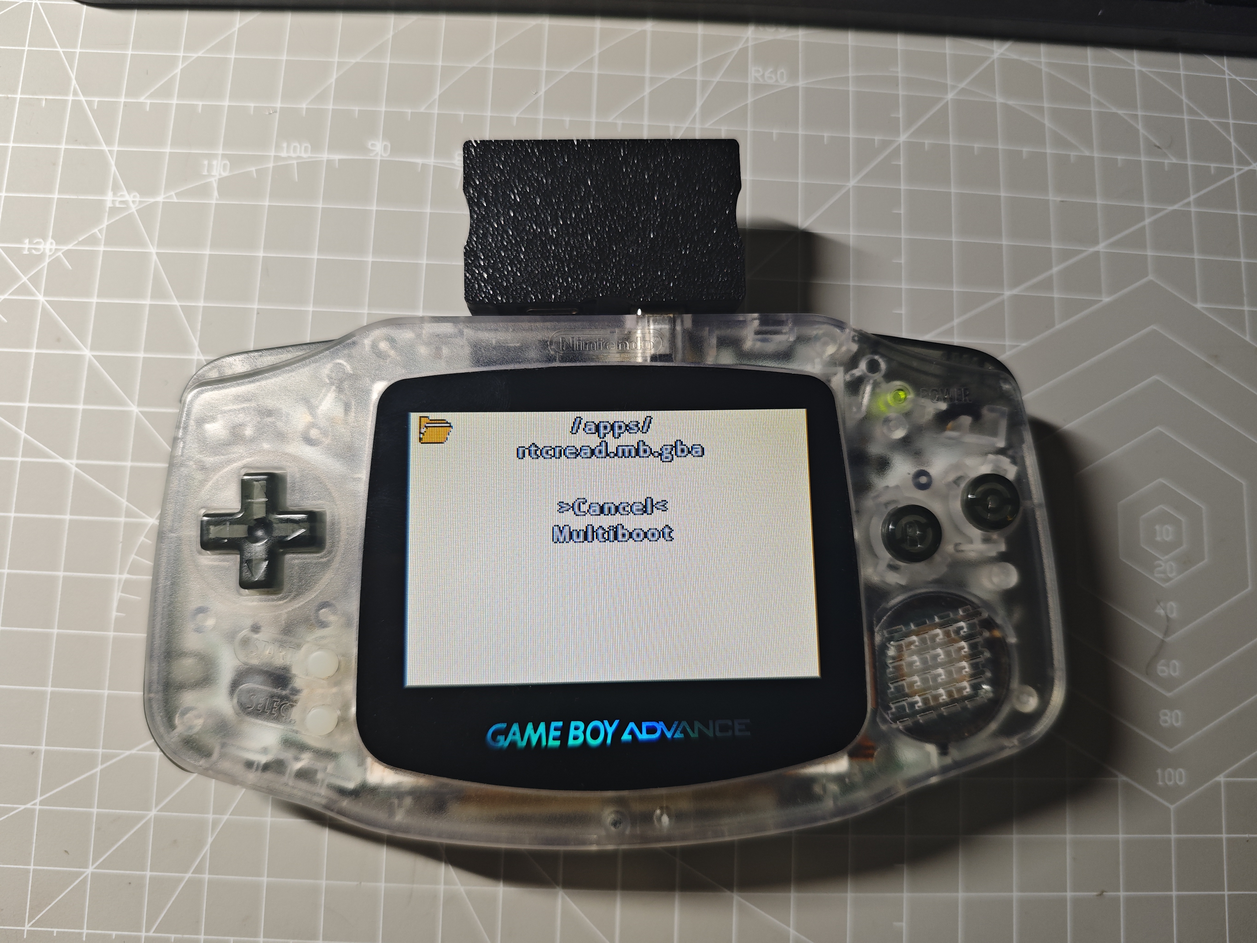

4. ChisLink also supports custom Multiboot, which means you can directly boot RTCRead, Poké Transporter, PocketNES, etc.
(I haven't tested it with a TF card larger than 32GB, but I think it's enough)
I love ChisLink so much that I can't wait to share it with you :D
I am considering making the ChisLink communication protocol public, allowing games to access TF card, WiFi, Bluetooth through the ChisLink protocol, or developing some libraries, such as sockets, etc.
Maybe we can meet in GBA's MMORPG in the future!
https://github.com/ChisBread/ChisLink
Note: Currently, only EPICJOY has obtained the English version of ChisLink authorization, and other stores on Aliexpress sell the Chinese version. I'll update the store on github with my confirmation.
ChisLink
Menu
Backup&Program
Multiboot
WiFI&Web
