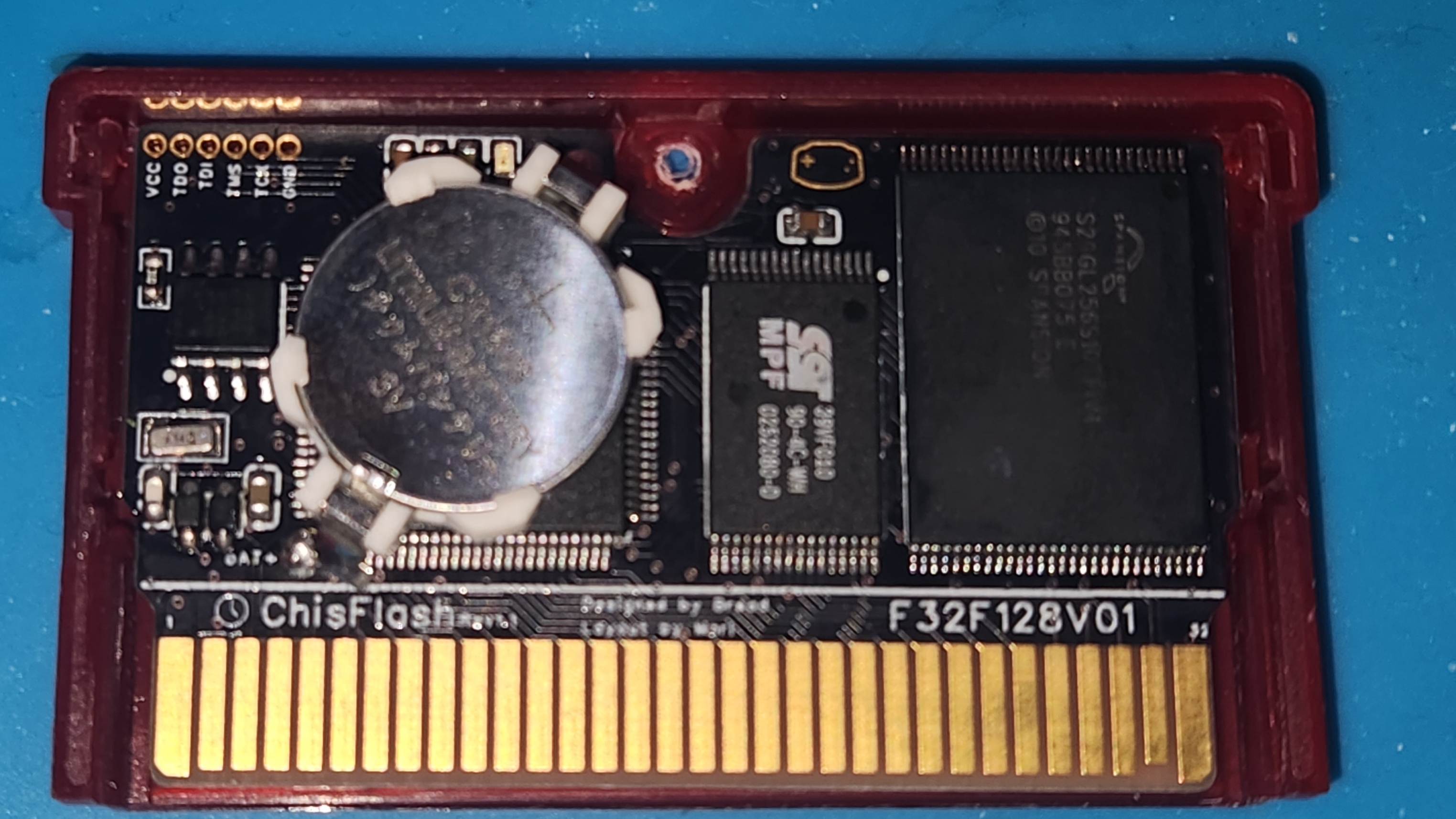

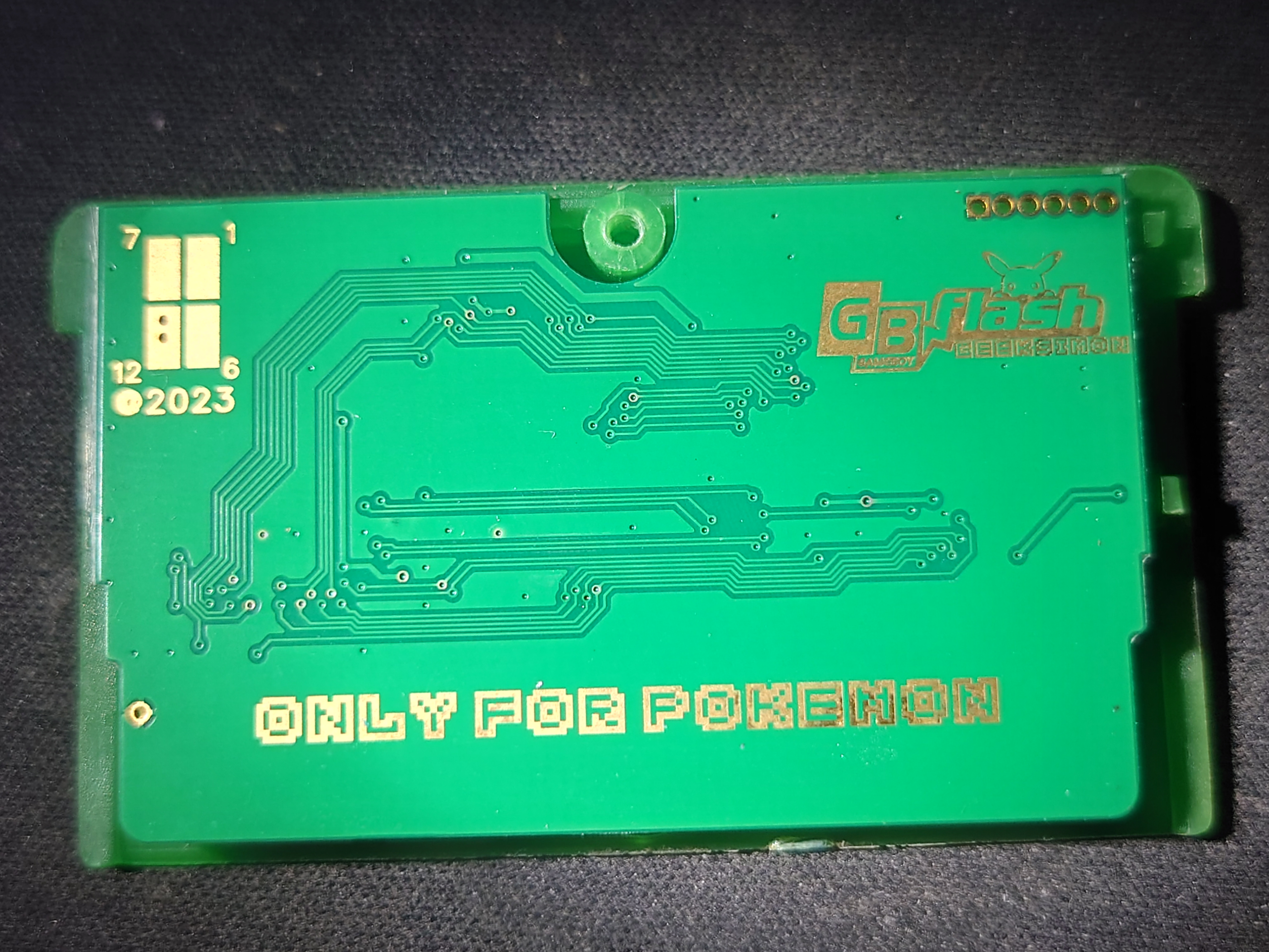

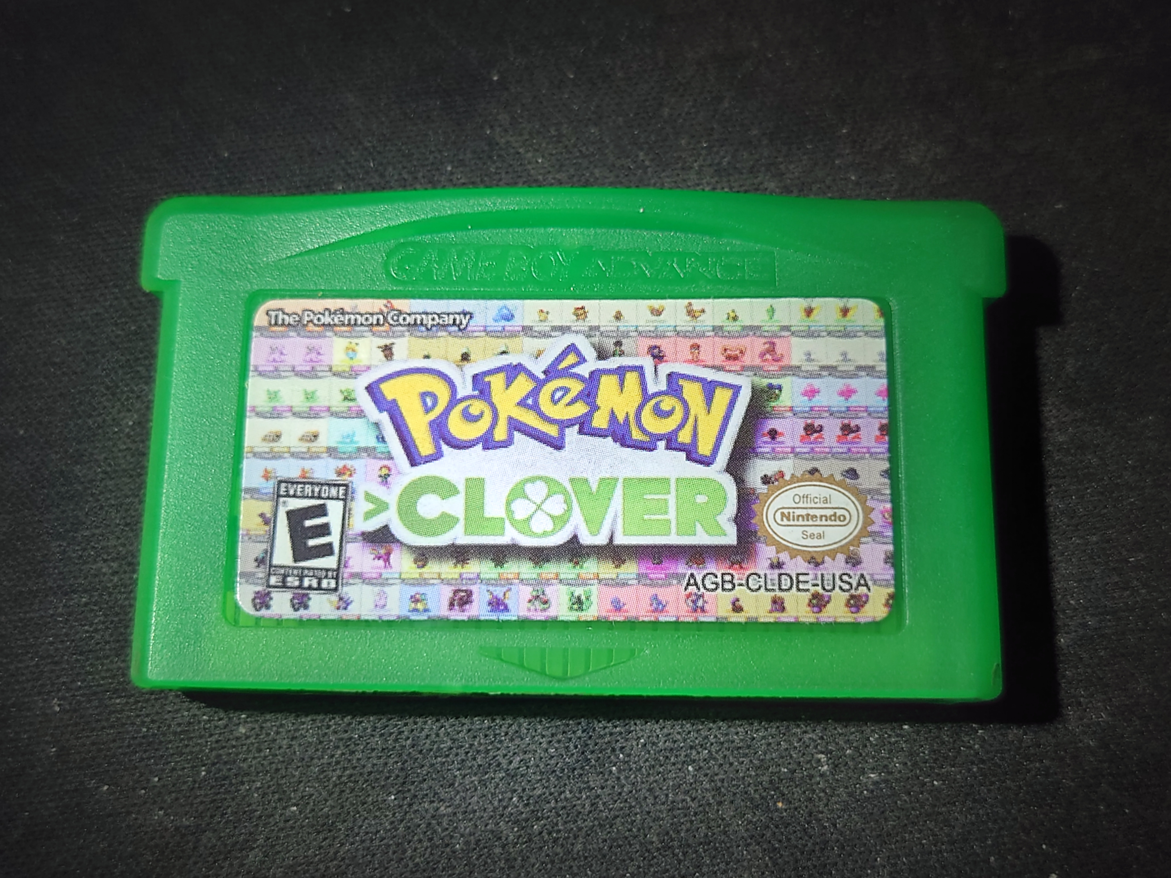

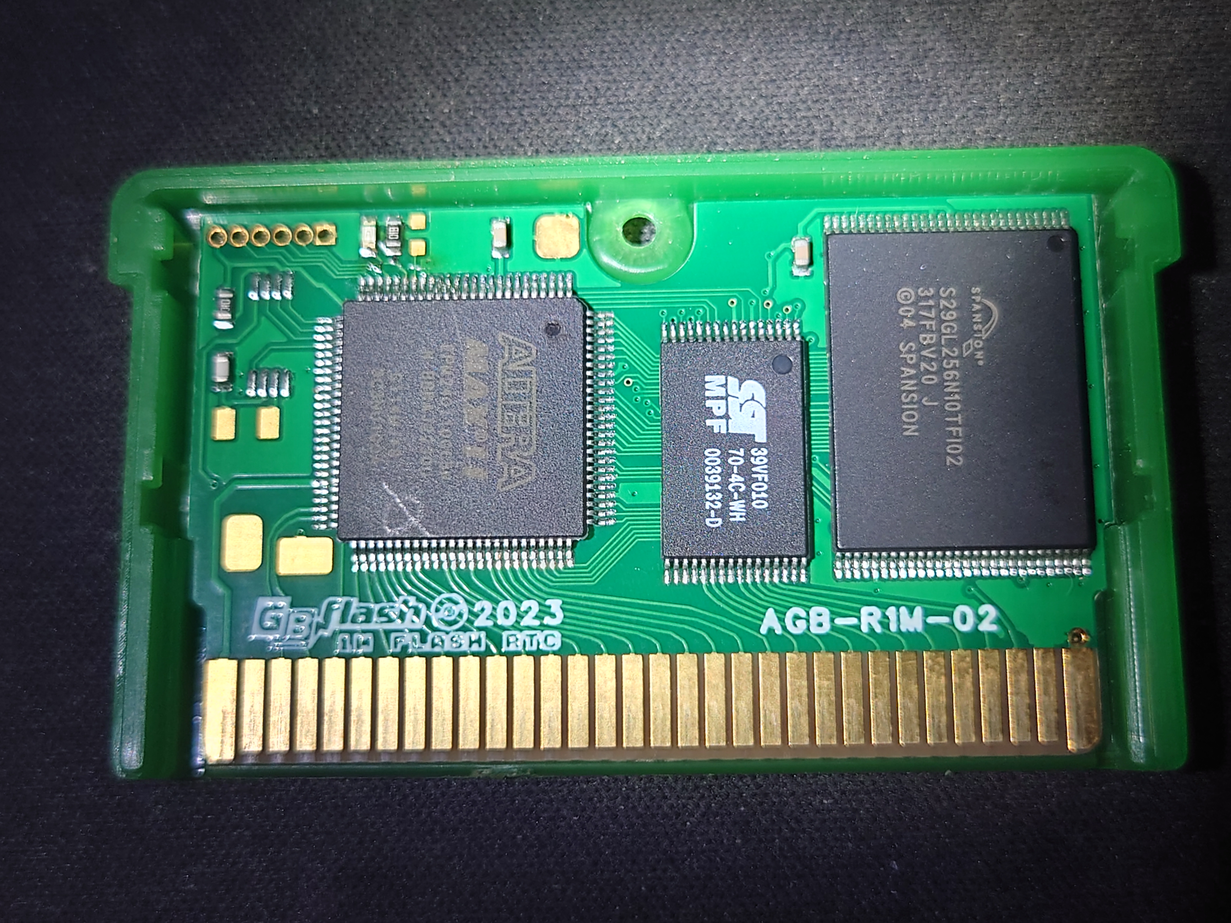

i bought one that is made with that exact design. you can easily tell by the board layout.
it came on a transparent shell, i put it into this green one from another cart that was one of those batteryless save patched trash and of an older romhack version to begin with.
this one has 128kb flash and no clock, that is fine as pokemon clover doesn't use it.
it works perfectly fine and flashing it with my joey jr. was as easy as always.

And they're picked up by the DS games if you want to migrate the Pokémons over in order to bring them over to Home at the end?
they work in the pal park on the DS

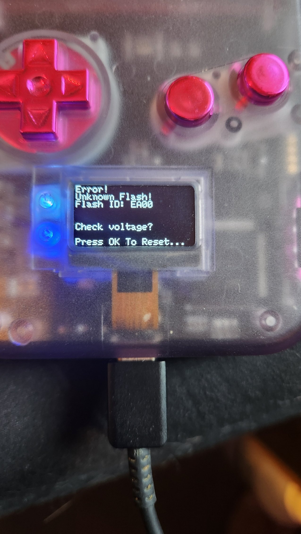

does not work on the BurnMaster
if i know we can do it with a NDS Lite ill buy one too.
I will test this also

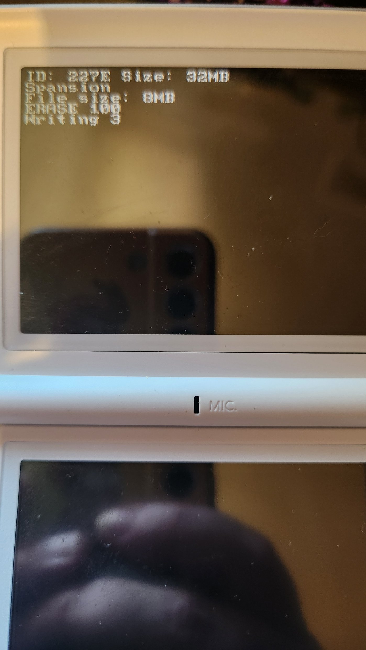

burn2slot works on this cartridge

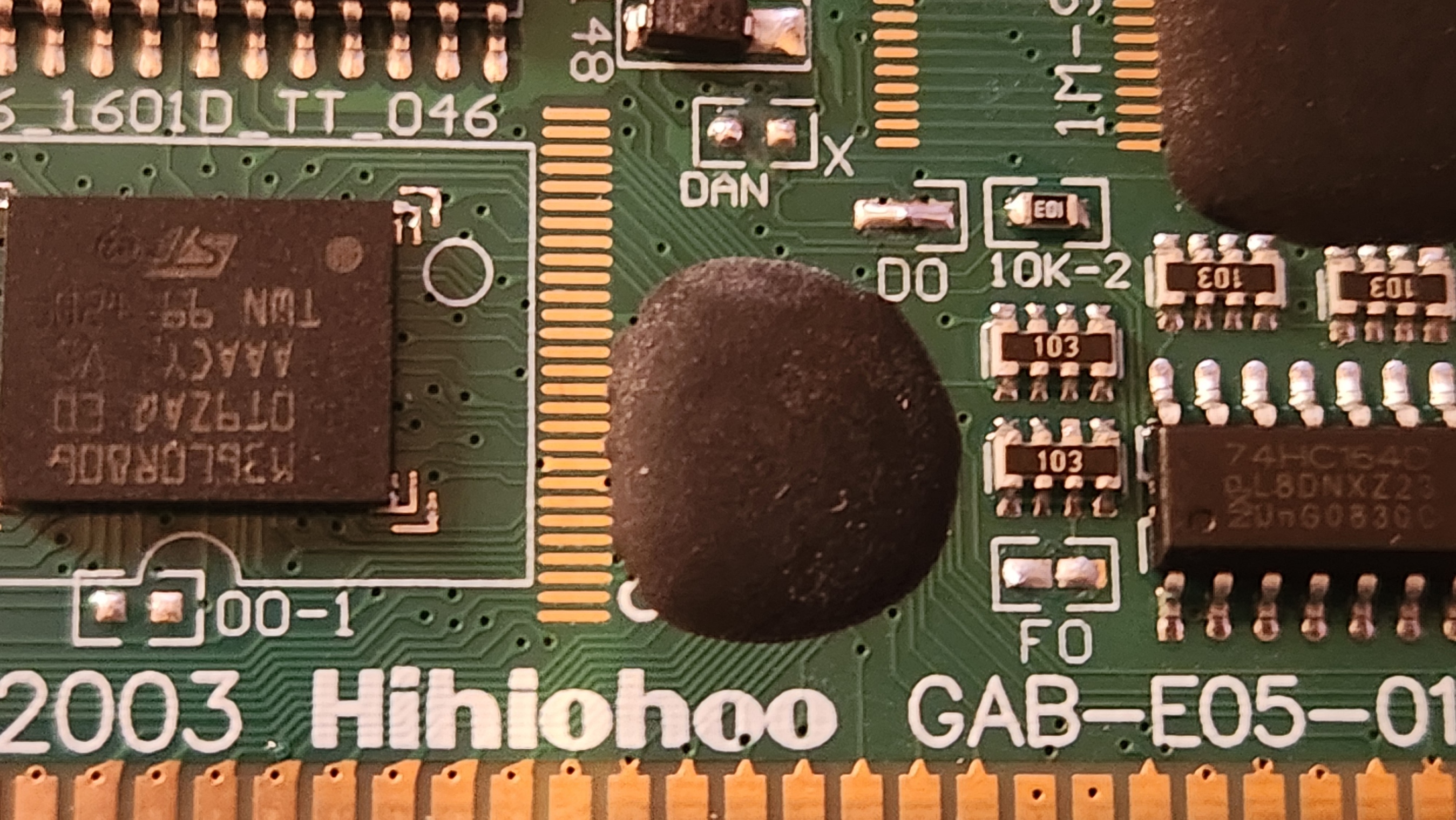

if you want a flash card for non-rtc pokemon, get this cartridge choose the Unbound one, you need to remove the solder joint from the pads at F0 and join the pads at D0 to make it a writable cartridge again (this is a 1Mb Flash save, not SRAM)
this works on the BurnMaster and Burn2Slot also

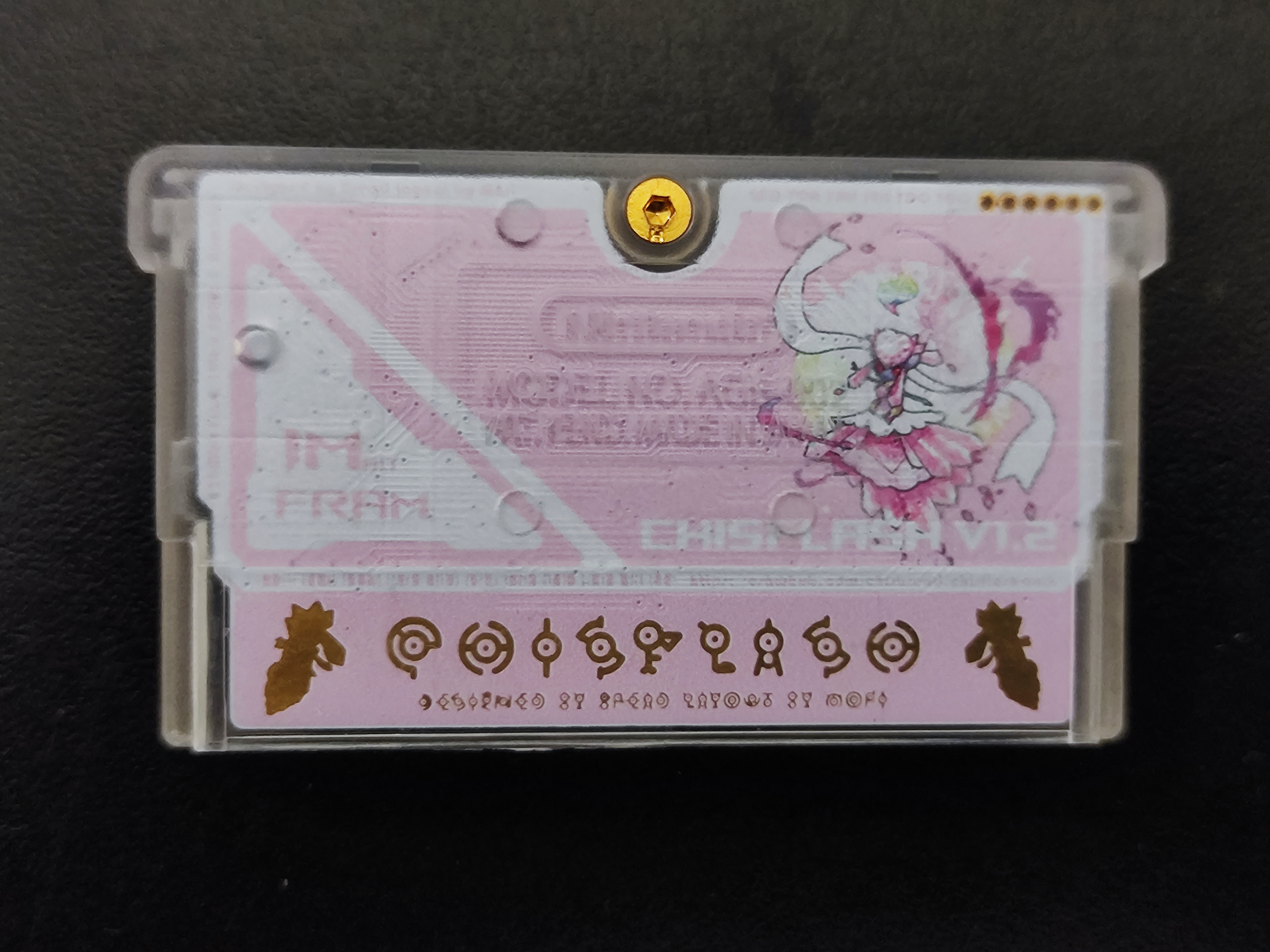

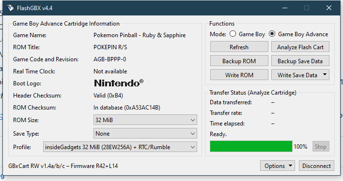

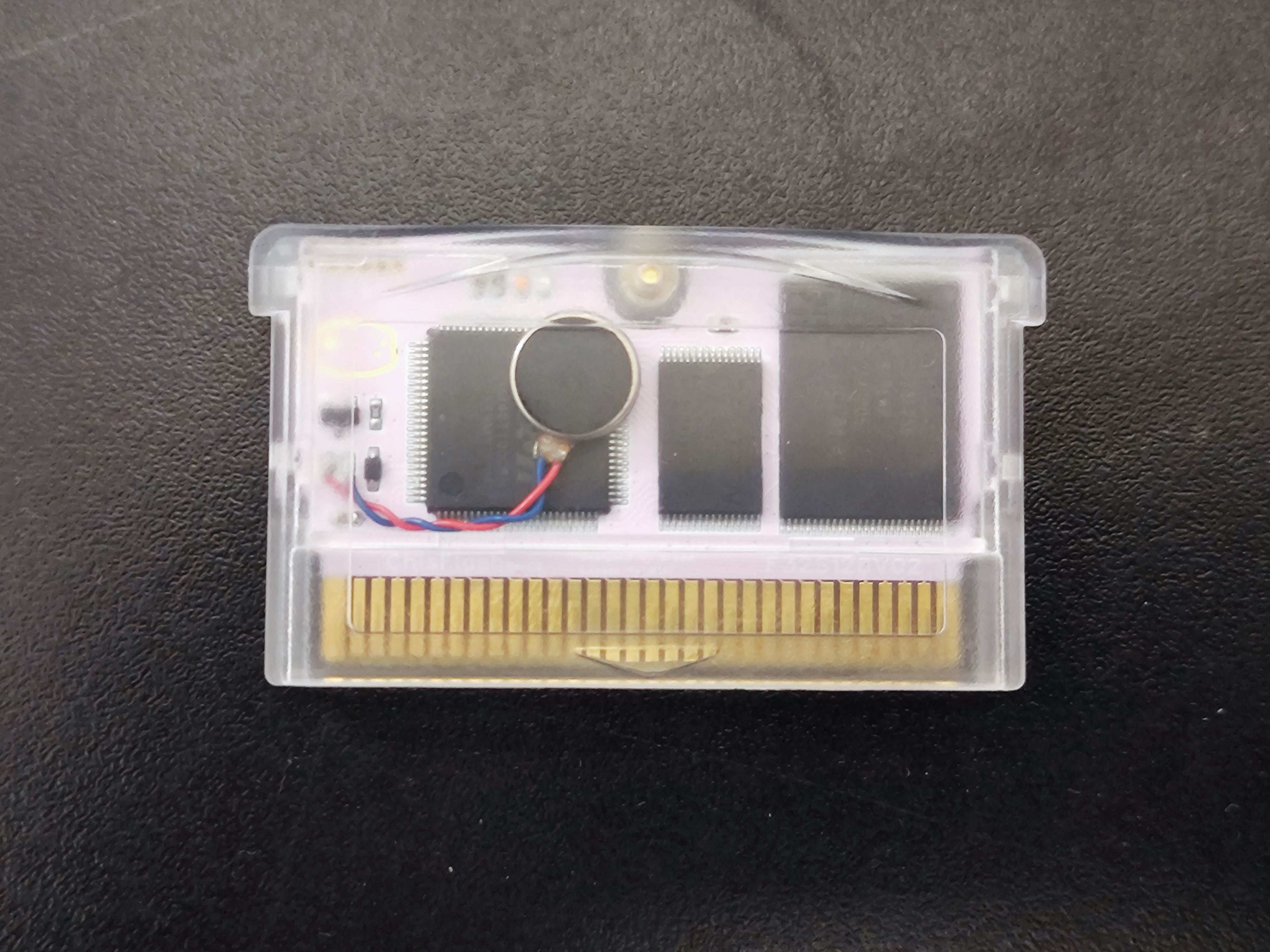

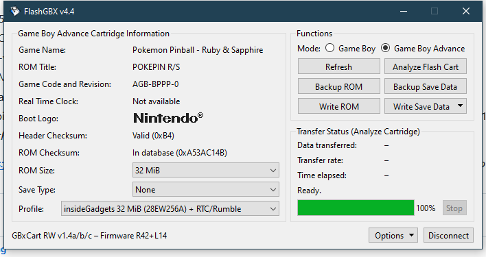

Hi everyone,
I recently bought a ChisFlash v1.2 cartridge with rumble support, and it came preloaded with Goodboy Galaxy, which works perfectly. The rumble feature is working fine, and the game boots with no issues.
However, when I tried to flash a different game, like Pokémon Pinball GBA, I couldn't get it to work.
Does anyone know the correct configuration for flashing with GBxCart RW using FlashGBX?
Any particular reason you are using that insidegadgets profile rather than the one above in this thread that was confirmed working?

Hi everyone,
View attachment 525776View attachment 525777View attachment 525778
Have you enabled the vibration setting in the game? Some games require manually turning on the vibration switch. Games with native vibration support will work, while for non-native vibration games, please check the website.
https://github.com/ChisBread/ChisFlashGBARumbleCollect

if you are looking for an unassuming, no rtc 1m flash save cart like mine, you are out of luck.
the one i bought is out of production. and most of the normal looking ones have fram save.
this is the best i could find. it has rtc, but if the game doesn't use rtc it ignores it and you can safely desolder the battery.
https://a.aliexpress.com/_mPuv6Il
keep and eye on inside gadgets to see if they restock their no rtc 1m flash save carts.
