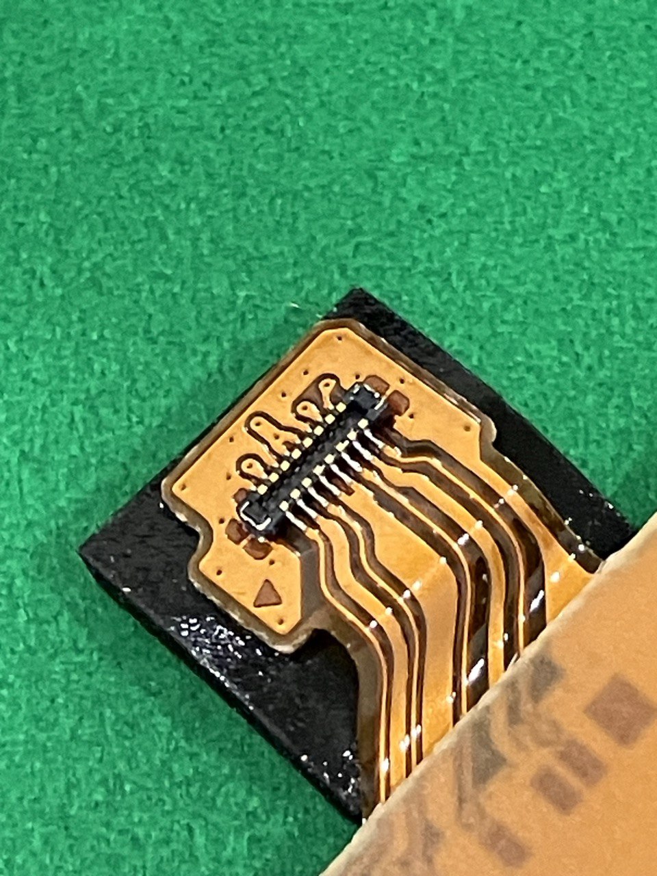

Any advice on how I could determine if it's the reader or bad pins? I rarely take the card out and the Switch has never been dropped or damaged. Hopefully, a new reader would do it.
Thanks!
Open it up. Get a tri wing screwdriver and take a look yourself. Only way to tell what's going on.
The ribbon cable could be loose and might just need fastened correctly (unlikely). Taking the reader off you'll be able to get a good look at the motherboard to see if any pins are missing.
When my switch was doing exactly what yours is I opened it up, took the connector off and there were pins lodged right in the cable ripped out of the motherboard.
Reactions: grooster
Thanks. I'll see what I can figure out!
I opened up the Switch and I don't see any damage to the connections.
I guess the next step is to try re-seating it or to replace the reader.
I don't know how you're supposed to line this thing up but I tried. I plugged the card reader back in. It booted and I could load games with no issues.
