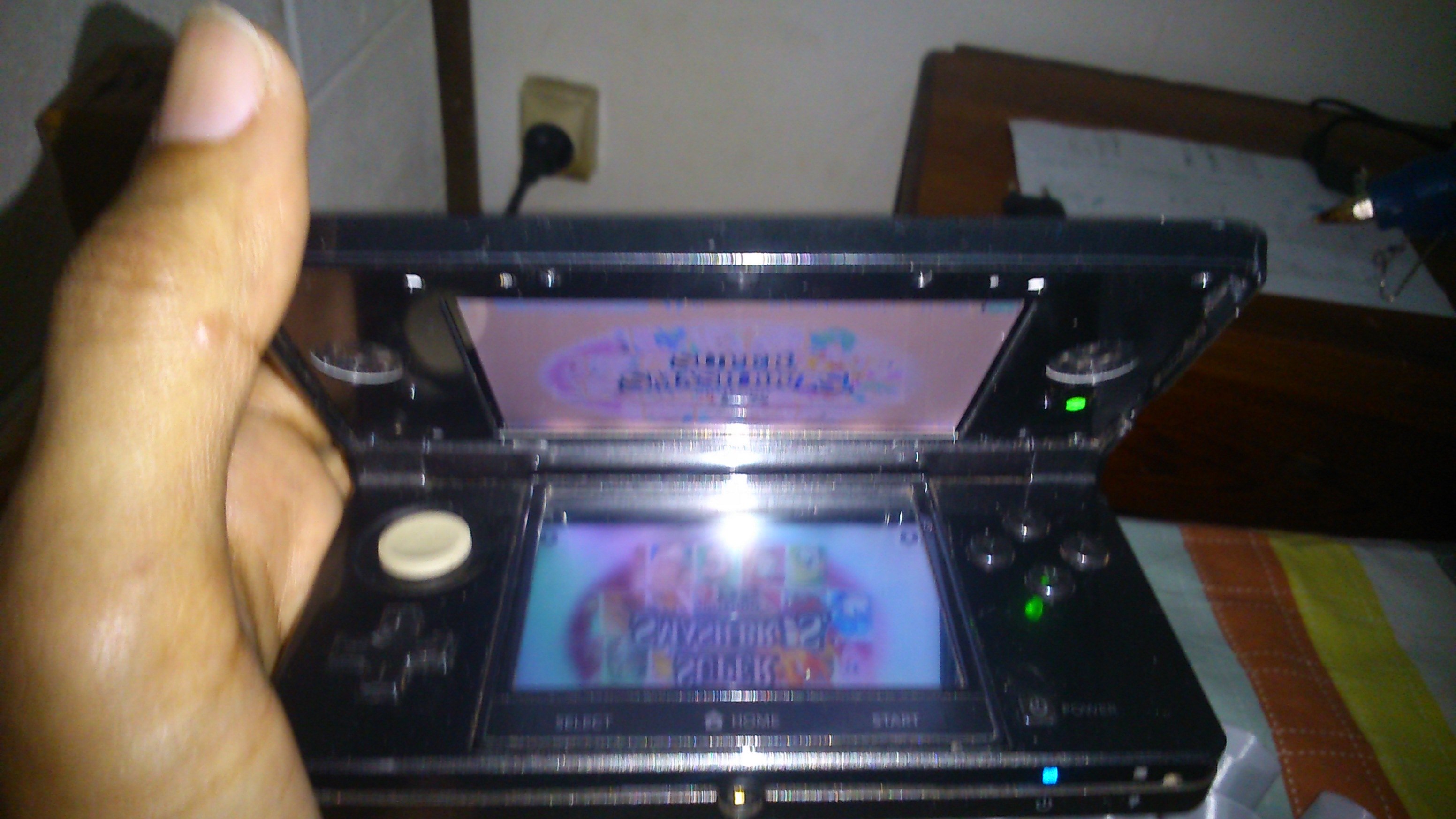

Hi, sorry for my bad english i'm french.
A friend gave me a 3DS where the bottom LCD is broken (easy to repair) but i have problem with 3D button.
Doesn't work and when you slide(turn on/off) that turn off the 3DS as when you fully open it, you can only turn on the console normaly half-opened. If i full open it flash and turn off when i try turn on. DSC_0007.JPG
I read somewhere i must change the 3D ribbon cable but that really not easy, ribbon cable stick on printed circuit how i'm supposed to change 3D ribbon cable ?
I tried to disconnect some ribbon cable to try work the console without 3D connected but nothing happen, seems it's more harder to fix than just disconnect any ribbon cable.
Or ! I read that can be the top LCD, but it work very well (better than the bottom one) may it ribbon cable ? but how i'm supposed to change that ? hell, some help pls

If it's a broken flex cable, you'll need to reaplce the top screen and doing that on a O3DS is a lot of work.
It's cheaperr if you just buy another 3DS.

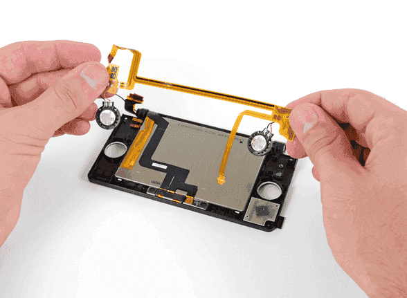

It's not the top screen. It's the speaker/3D slider cable. A 3DS will run fine even if the upper LCD ribbon cable is torn. It just won't display anything. You could even run the 3DS with the cable for the upper LCD unplugged and it would still work.
The flashing and turning off problem is due to either backlight being disconnected. The reason it turns off when you open the console all the way is because the cable has a very small tear in it that goes through only one or two conductors. When you open the hinge you stress the cable and the connection, which was tenuous to begin with due to the tear, is fully broken.
It is indeed a difficult repair. But the parts are dirt cheap, so you don't have much to lose if you want to try it. Just don't use a third-party reproduction cable. Those are trash and will fail quickly.

Hey, sorry for the late. Thanks for feedback, yeah it's the speaker/3D slider cable.. I already ordered it, it should deliver in this week !
I already dismount overall the 3DS, i just wait to repair :D. The only thing is really boring is the resolder the Highspeaker because unfortunatelly i saw your post later after my order... Anyways, thanks that helpfull ! i didn't know it selled include solder HS. i got another 3DS to repair, i'll take the link you gave me !
Thanks thanks thanks ^^
