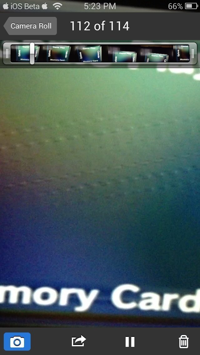

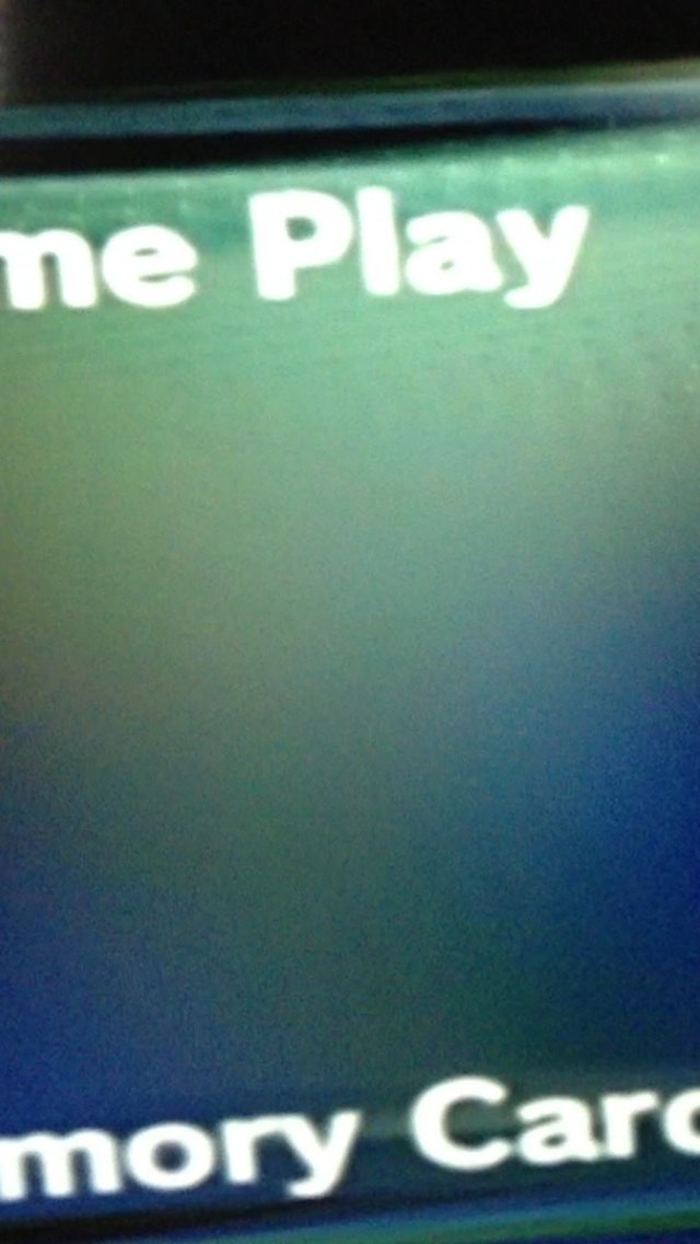

I'm getting horizontal lines going Upward slowly on my TV on any screen.
What is causing this? Defective AV cable or is the rattling inside the GameCube upon shaking related?
Tested on two TVs, same result.

Those pics aren't very good, so I can't say for sure what your video problem may be. It may just be a crap A/V cable.

Your problem with the rolling video lines/picture quality is because of the cheap noisy power supply you are using. If you have a 1st party A/V cord which is better shielded along with the 3rd party power supply your should see a improvement in your video quality.

The vertical lines are caused by noise from a crappy AC Power Adaptor http://www.amazon.com/Power-Adapter-Cable-BRAND-Nintendo-Gamecube/dp/B000N1IZOO/ref=pd_cp_vg_1 < being the culprit.
