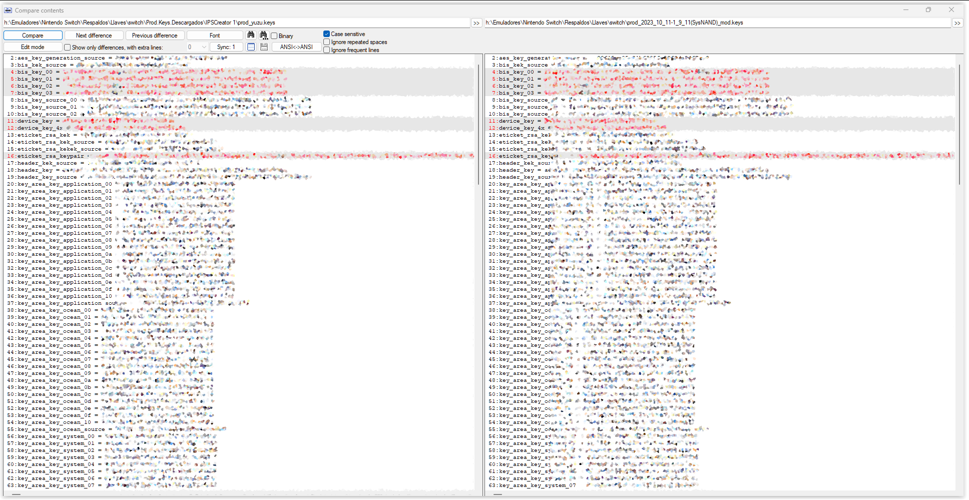

Ok, this is part of a comparision between the Yuzu Prod.keys file you can get using a web search engine and my personal prod.key just dumped from my 17.0.1 (rebootless) console:
as you can see only few keys are different between them.
In my case the keys with different value are:
bis_key_00 =
bis_key_01 =
bis_key_02 =
bis_key_03 =
device_key =
device_key_4x =
eticket_rsa_keypair =
keyblob_key_00 =
keyblob_key_01 =
keyblob_key_02 =
keyblob_key_03 =
keyblob_key_04 =
keyblob_key_05 =
keyblob_mac_key_00 =
keyblob_mac_key_01 =
keyblob_mac_key_02 =
keyblob_mac_key_03 =
keyblob_mac_key_04 =
keyblob_mac_key_05 =
save_mac_key =
sd_seed =
secure_boot_key =
ssl_rsa_key =
tsec_key =
At least you need the above keys in order to create a working file.
In order to do so, you need to create a file with a content like:
bis_key_00 =
bis_key_01 =
bis_key_02 =
bis_key_03 =
device_key =
device_key_4x =
keyblob_key_00 =
keyblob_key_01 =
keyblob_key_02 =
keyblob_key_03 =
keyblob_key_04 =
keyblob_key_05 =
save_mac_key =
sd_seed =
secure_boot_key =
ssl_rsa_key =
tsec_key =

But what can I do if my own prod.keys don't have keys that are different for all consoles?
Then you don't have your unique console keys and you have a big trouble, as adviced by @Jayro take a new SD Card, format it FAT32, inject a recently downloaded Picklock_RCM_1_9_11 from https://gbatemp.net/threads/lockpick_rcm-payload-official-thread.532916/post-10266016 and try to get your keys again.
also prepare your SD Card with LATEST Atmosphère and Hekate files and try to get into NYX (Vol- pressed while injecting payload)
Ok, I'll try when I get home. But what if the keys will be the same corrupted?
