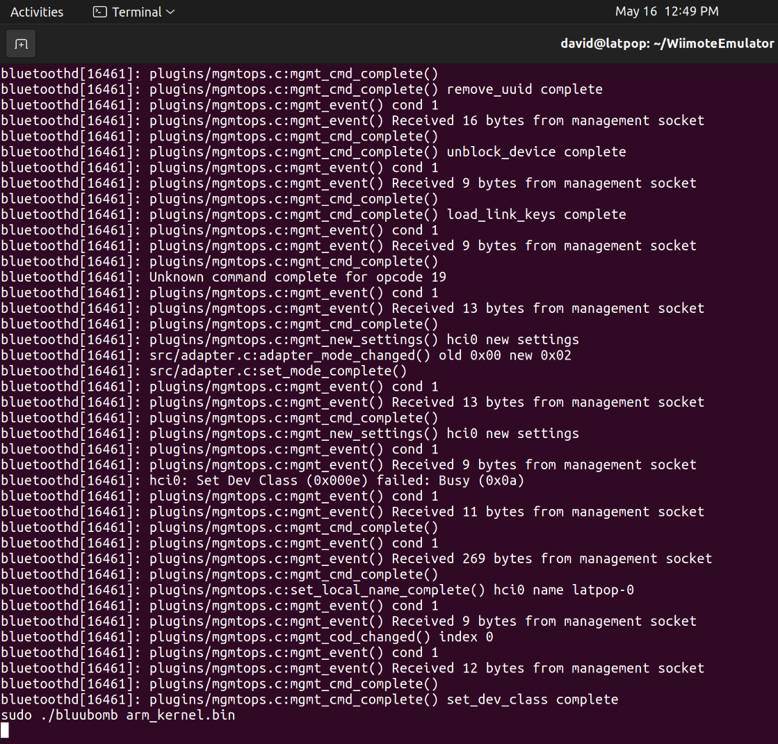

This means you can get IOSU code execution by only pairing an emulated Wii Remote to the system.

The BluUBomb repository contains a few different kernel binaries for different purposes:
loadrpx.bin
Launches a launch.rpx from the root of your SD card on the next application launch.
regionfree.bin
Applies IOSU patches to temporarily remove region restrictions.
This should be helpful if you've locked yourself out of your applications due to permanent region modifications.
wupserver.bin
Launches a wupserver instance directly after using bluubomb.
This gets you full system access remotely via wupclient (replace the IP in line 29 with the one of your Wii U).
This works without having to leave the controller pairing screen.
