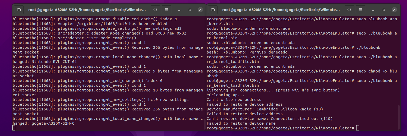

chmod is a privileges command, right? I seem to remember it, but I'm kinda a noob at linux.
Are you using virtual box?
You need to pass through your bluetooth adapter in the usb settings.
I am on a real computer with Ubuntu 21.04
Basically not compatible manufacturer, like I said before, maybe we can install this .bin into the Wiimotes instead.
Press the sync button on the console first then run the program, after that just wait for a few minutes. Shouldn't take more than 1 or 2.
Did it the first time, didn't work. Tried running the program, then pressing the Sync button, and didn't work. Tried again as you say in the guide, it doesn't work.
If I use an USB bluetooth adapter, does the port where the adapter is connected should matter? For example, if I connect it to a USB 1.0, or USB 2.0, would it make something different?
__
EDIT: It worked, after the 6th try. So... yeah.
