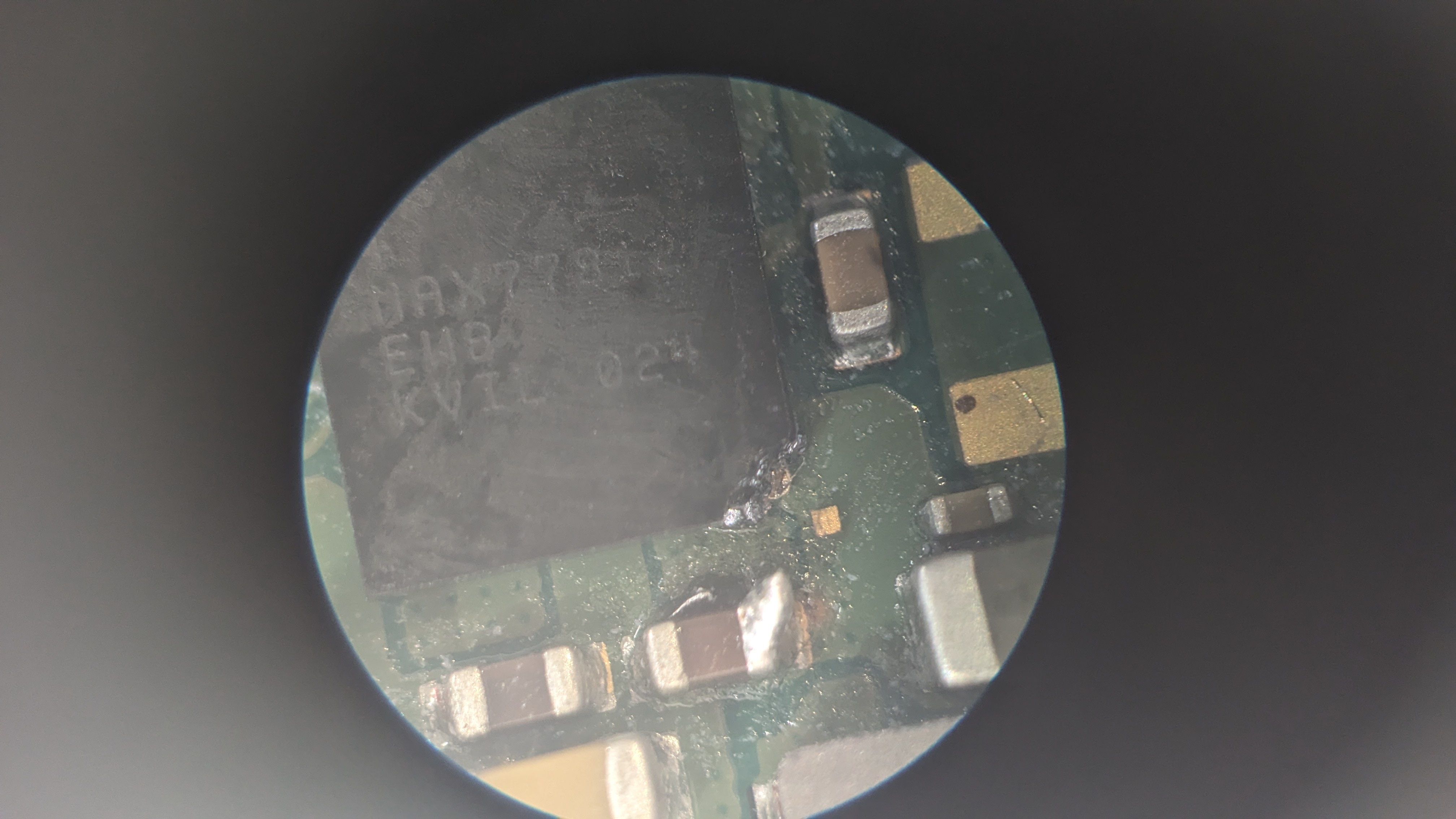

I have exactly the same defect, will it work again if I change the ic max?
I change the chip with my hot air station, works as expected, thx for your help!
I have exactly the same defect, will it work again if I change the max77812?
