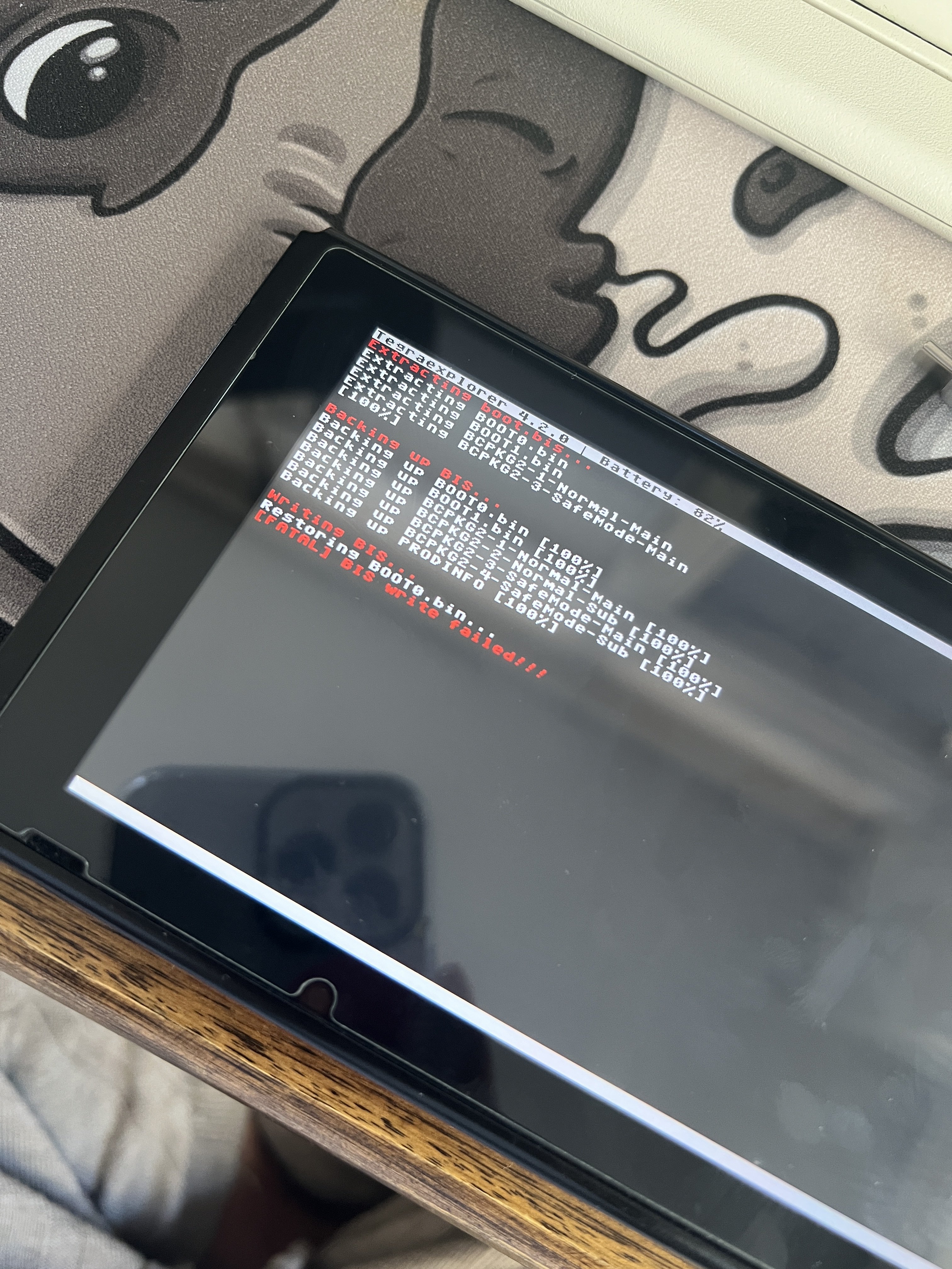

Hi, my switches EMMC is cooked. I can’t get into my stock or emunand (can’t created emummc as my Emmc is borked).
The GPP partition table was completely empty, after following a guide to rebuilding my EMMC from scratch (with a donor Emmc) my Emmc now has a partition table but doesn’t boot past Nintendo screen (better then before as it was just a purple screen).

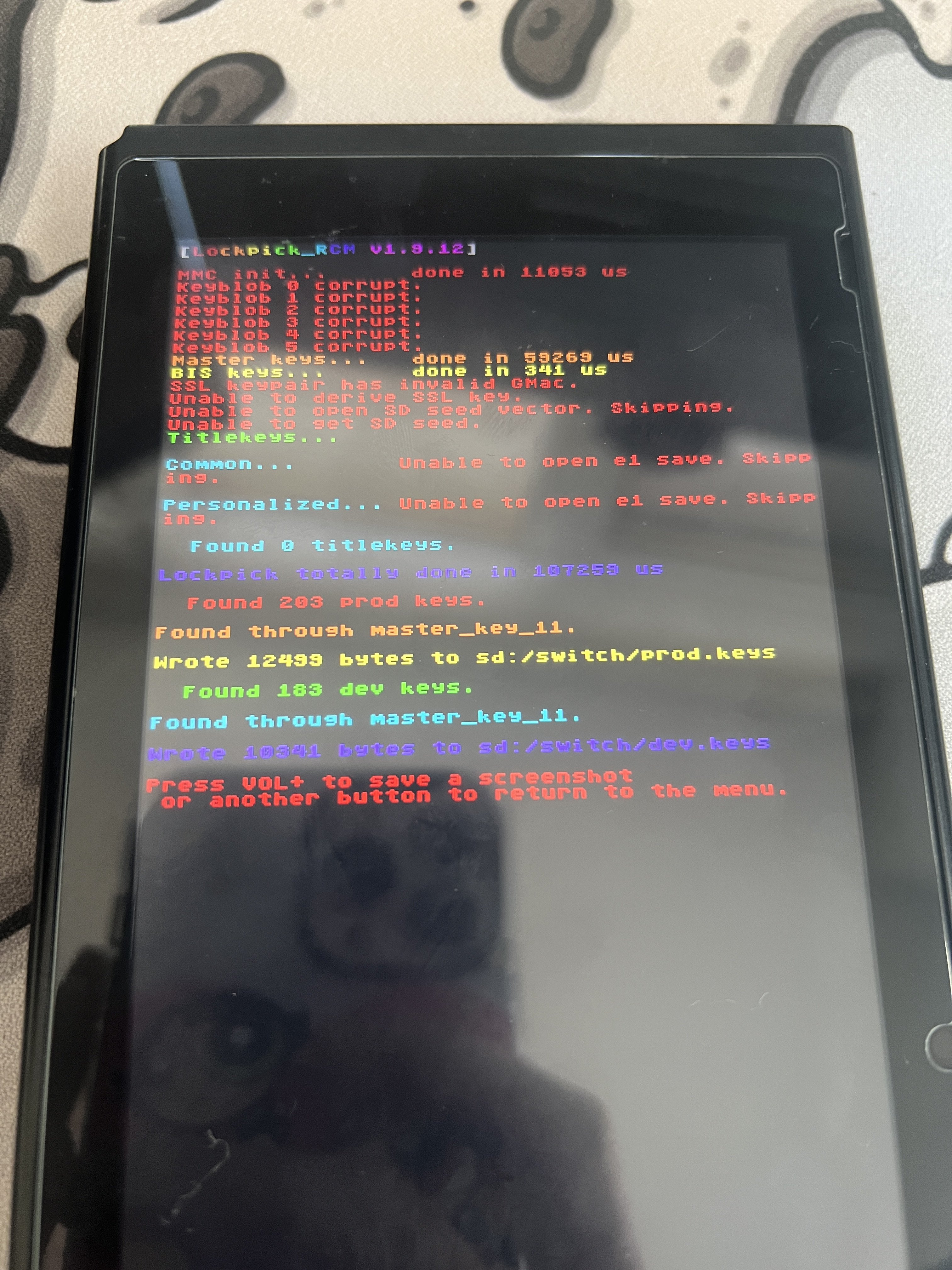

When I try system restore using my prod.keys, I get this error of a bis write fail on my boot.0. Also this is the screen I see when getting my keys from lock pick.
  1. I’m assuming my prod.keys are fucked too, anyway to fix this? :/ I’m well aware I cant go online anymore but I just want it to work.

Seem like you are out of luck you need your own keys to rebuild, since you don't have a original (non rebuild) boot0/boot1 and rawnand to restore to seem like that you are out of options.

Well if you have a boot0/boot1 and rawnand you can try to get a new emmc to restore see if it would boot, the thing is partitioning the SD card shouldn't mess up the internal emmc so obviously you did something else to break it.
