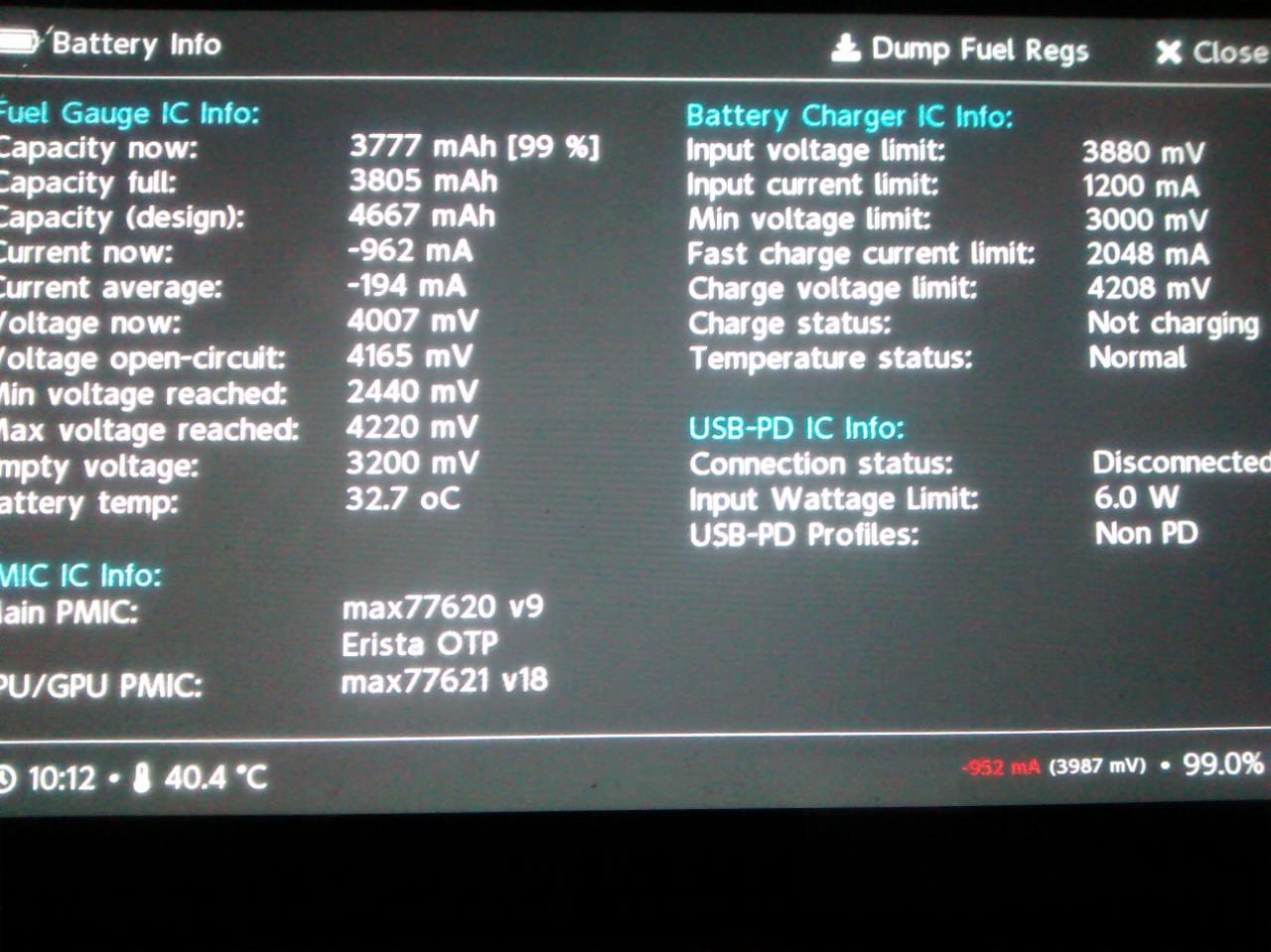

I've recently hacked my switch and I've been using an emmc to use atmosphere but I've noticed that it warms up and the battery drains a lot while in sleep mode.
The battery goes from 100 to about 50 in 4 hours.
My console:
Atmosphere 1.5.4
Firmware version: 16.0.3
I don't have Auto-RCM on or any sys modules.
Does anyone know how to fix this?
EDIT:
After some time I discovered that I had the pins required to enter RCM still shorted, after Removing that the battery life came back to normal. Thanks everyone for the help.

i have same issue with yours.. it wams up when it sleeps.. and it drains a lot while sleep. airplane mode doesnt do any good at all..still same issue. and it wont wake up if it sleep, it just freeze.. i need to hard reset to boot it back again. it wont freeze when i'm in hekate..

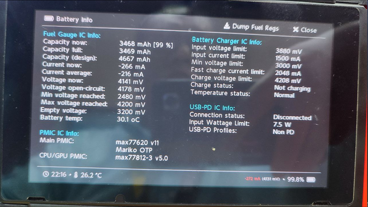

I have exactly the same issues, never found a solution.
Did you let the battery die often?
No.
As a matter of fact the console is always plugged at the side of my bed.
I had it fixed a couple of years ago when a fake dock bricked it and would charge at all.
Now it charges and works normally, only wierd effect i have is the same reported by people who didnt have the console fixed: heating and battery drainning while in sleep mode.
