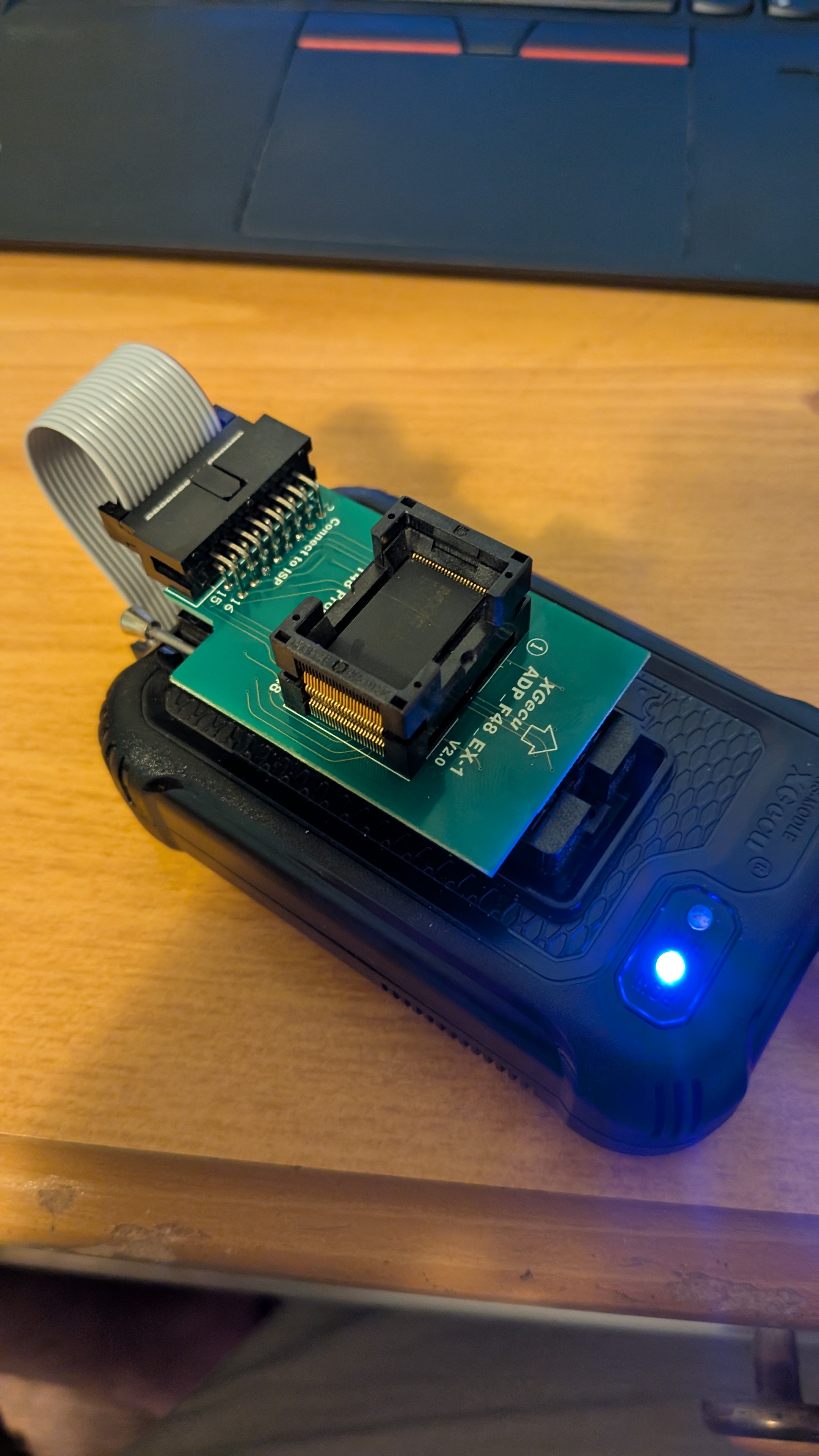

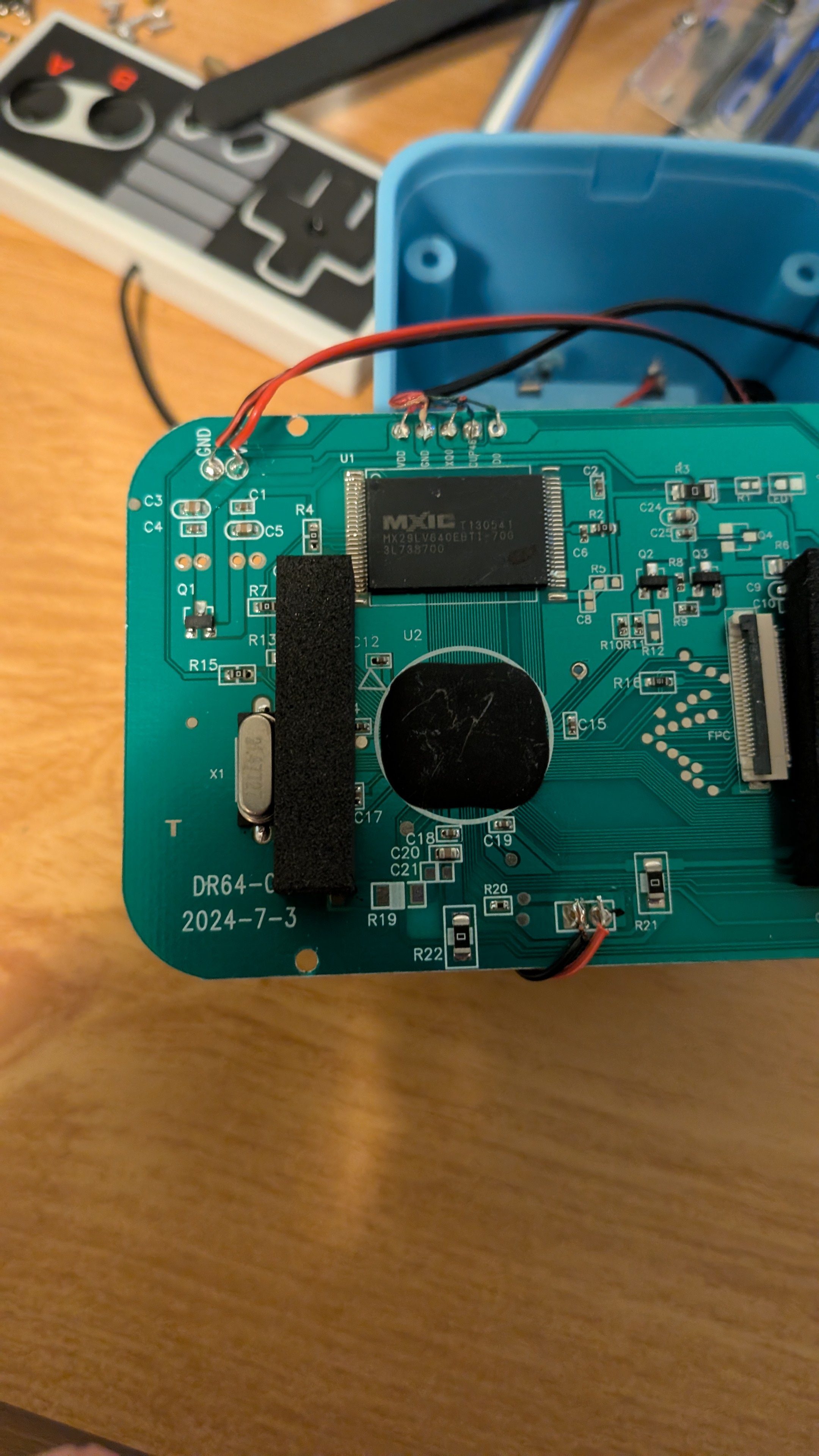

I just dumped the flash off one I found at FiveBelow.
I'll upload the .bin when I have enough xp lol
View attachment 562108View attachment 562109
I wouldn't because the flash will contain games, and uploading them here would be against site rules. Maybe bank addresses or other technical information about it could be helpful into adding games onto the console.
They are all bottom of the bin unlicensed shovel games, I'm not sure if that would make a difference.
Do you have any tips tricks or tools for analyzing or parsing the flash? 8mb is a lot to go through by hand lol.
Edit:
I think it's laid out as follows -
0x000000 – 0x001FFF: Core firmware + LUTs
0x002000 – 0x077FFF: Menu code + UI data
0x078000 – 0x7FFFFF: Banked game region @ 32kB/each
