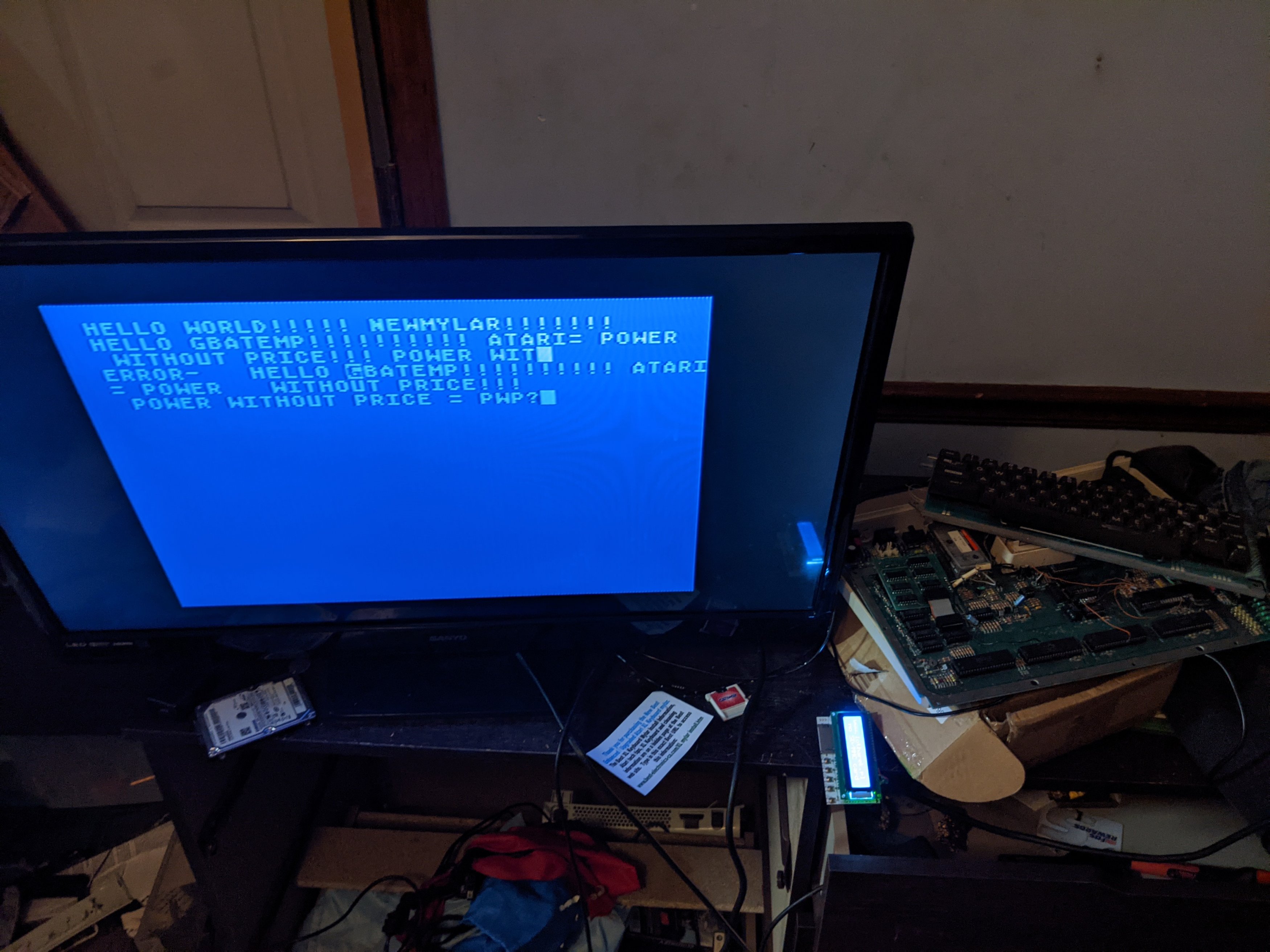

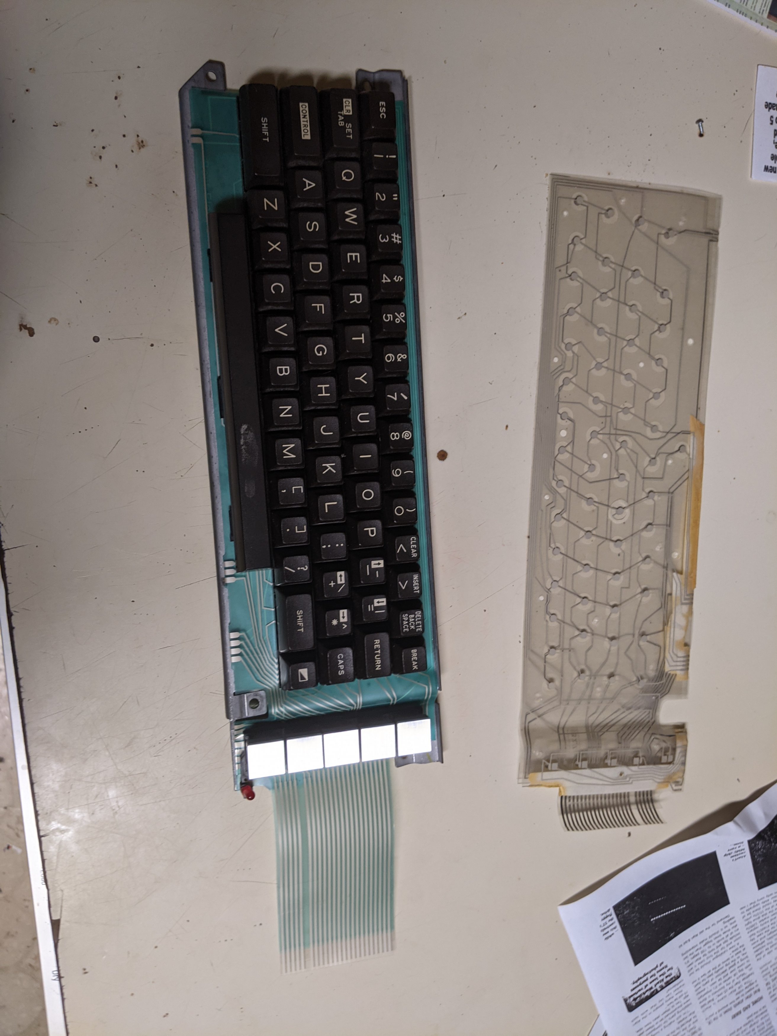

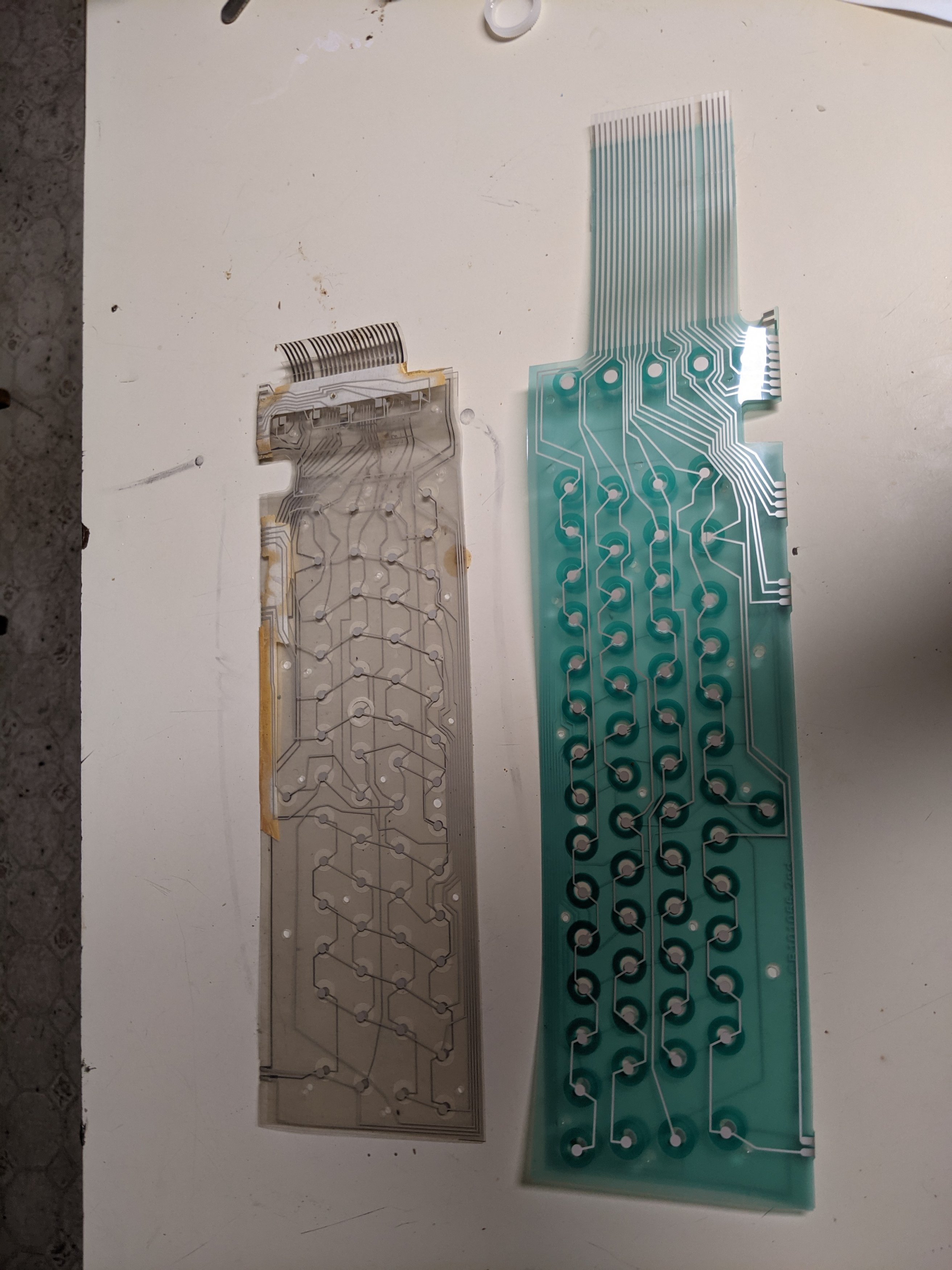

Took about 3 days to ship:

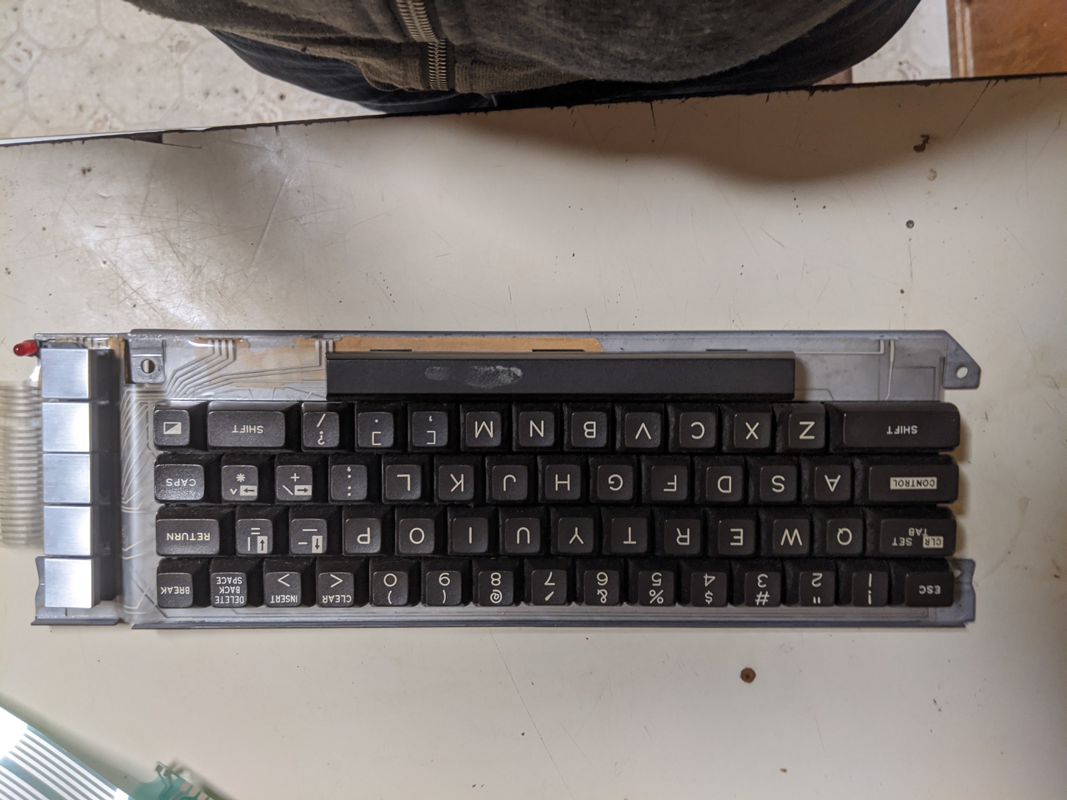

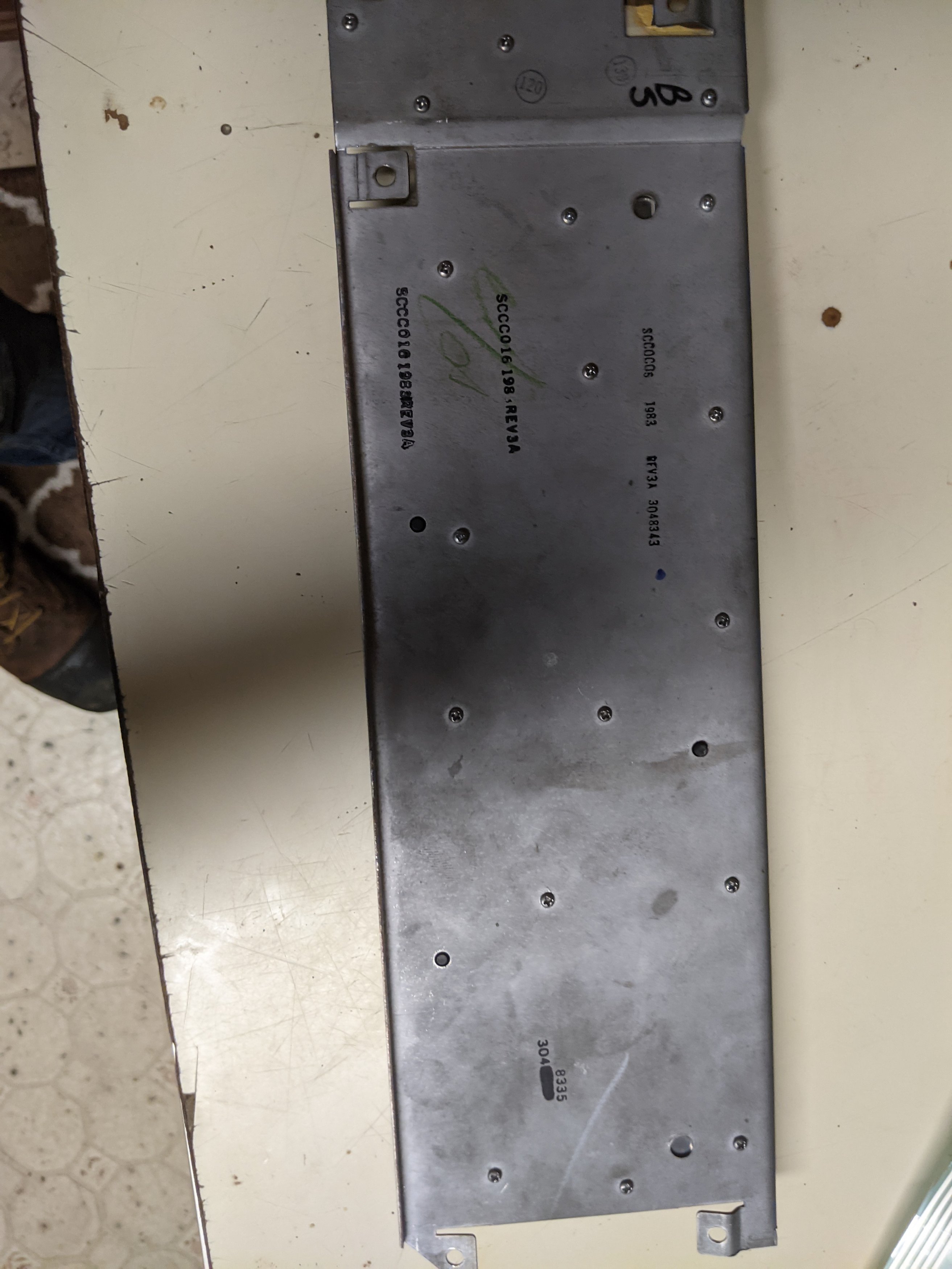

Replacement is simple remove keyboard, and remove backplate, DO NOT FLIP KEY ASSEMBLIES AFTER REMOVING PLATE, ALL KEYS HAVE SPRINGS THAT MAKE CONTACT WITH MYLAR, THEY WILL FALL OUT IF DO NOT KEEP THE KEYBOARD FACING DOWN!!
Swap mylar, and reassemble and done!
