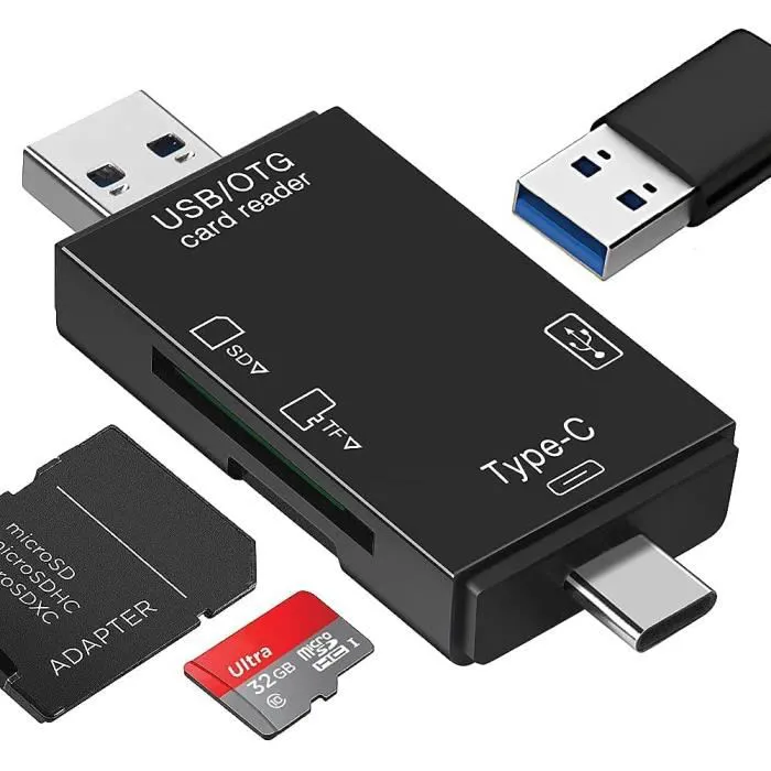

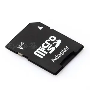

So you can't delete files.. you can't copy files too?I try to my sd card into an usb adaptater but still nothing, i try to delete a random file but when i unplug and replug the usb the file are still there. ( my sd card is really new i buy it like 1~2 month ago )

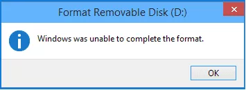

Don't do the test until you've copied your stuff, and formatted the sd card (as fat32 32kb clusters) after doing that, only then check it with h2testw. You need to redo it.The h2testw is running i will share to you once it's finished
