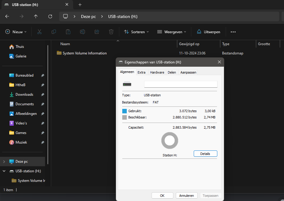

I found out that holding down the 3 buttons (Back, Notification and the Big dial) while inserting the USB into a PC, it will enable a flash drive mode.
It is formatted as FAT and has 2,75MB of free space.
I wonder what it is for. Maybe a recovery mode? Maybe it can be used for something else?

2.75MB isn't much considering you will presumably be able to download additional sounds in the future. Does Windows Disk Management recognize other partitions that the explorer doesn't show?
I assume that it will be saved into another memory that we cannot access it by regular ways.
Windows Disk Management (and any other partition managers) just show this 1 partition of 3MB.
Reactions: Axido
You're right alarms and the system are on a different chip USB Storage Mode is for firmware upgrades via USB (or possibly put doom...)
