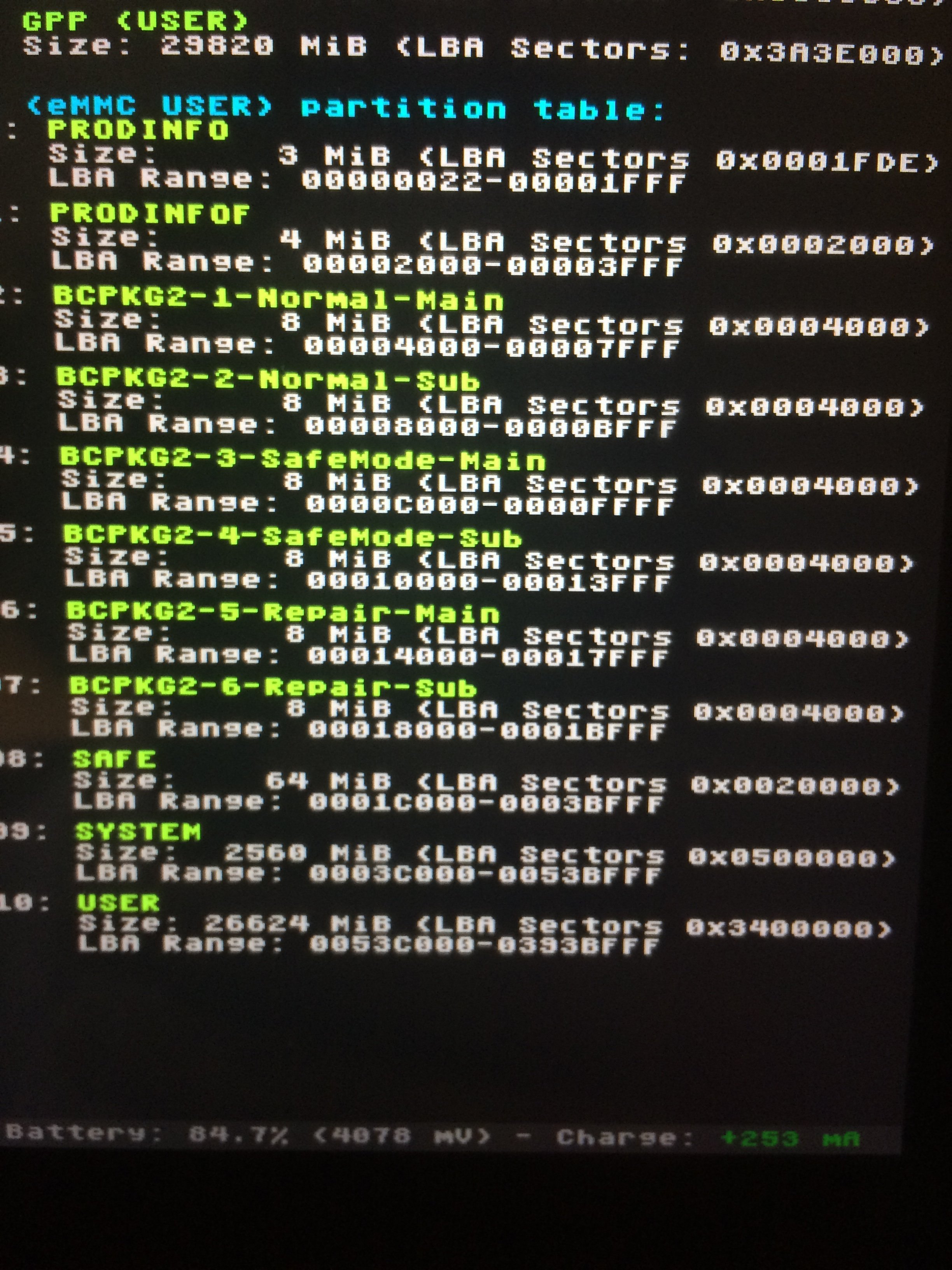

delete the USER on #10? this was a info dump from hekate.
