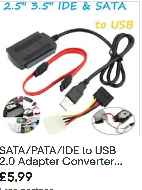

OP if its only the one HDD you want to grab stuff from the attached pic is probably the cheapest route, it does IDE + sata. used these a few times without issue.
This one is almost exactly the same one I have bought almost a decade ago. It served me really up to this day.
yeah, you do need to be careful with this one, because I once bought something like this for an old hdd, and I could smell something burning after it had been plugged in for a short time.
Since youself and VinsCool have suggested this I think I'll take a look into it. but I've got so many questions :rofl:
I'm unfamiliar with connections on these older HDDs and I've never built or looked into cabling or building a PC, so it looks terrifying how many cables are there.
What's the red cable for, SATA?
I gather The HDD plugs into the black box and USB's to the PC, then where does the power for the drive come from? I see there's a 4 pin power connector, but will I need to use that for the HDD to get enough power to 'turn on'? If so, where do I get that power from? I'm only connecting to a Laptop so don't have a 4 pin power output to plug into...
Sorry for all the questions, it's embarrassing knowing this little about how to connect a bloody hard drive ahaha
that hdd is a ide, so you plug that in for data, then molex (the four pin part of the drive) for power. I think that's correct as I can't even remember the last time I messed with an internal hdd that old. :P
thats correct buddy

the black box is for data, the short molex cable (white one end and black at the other) will connect to a wall plug power supply to give power to the HDD. whenever you order make sure it comes with a power supply as USB cannot power a 3.5" drive on its own.
