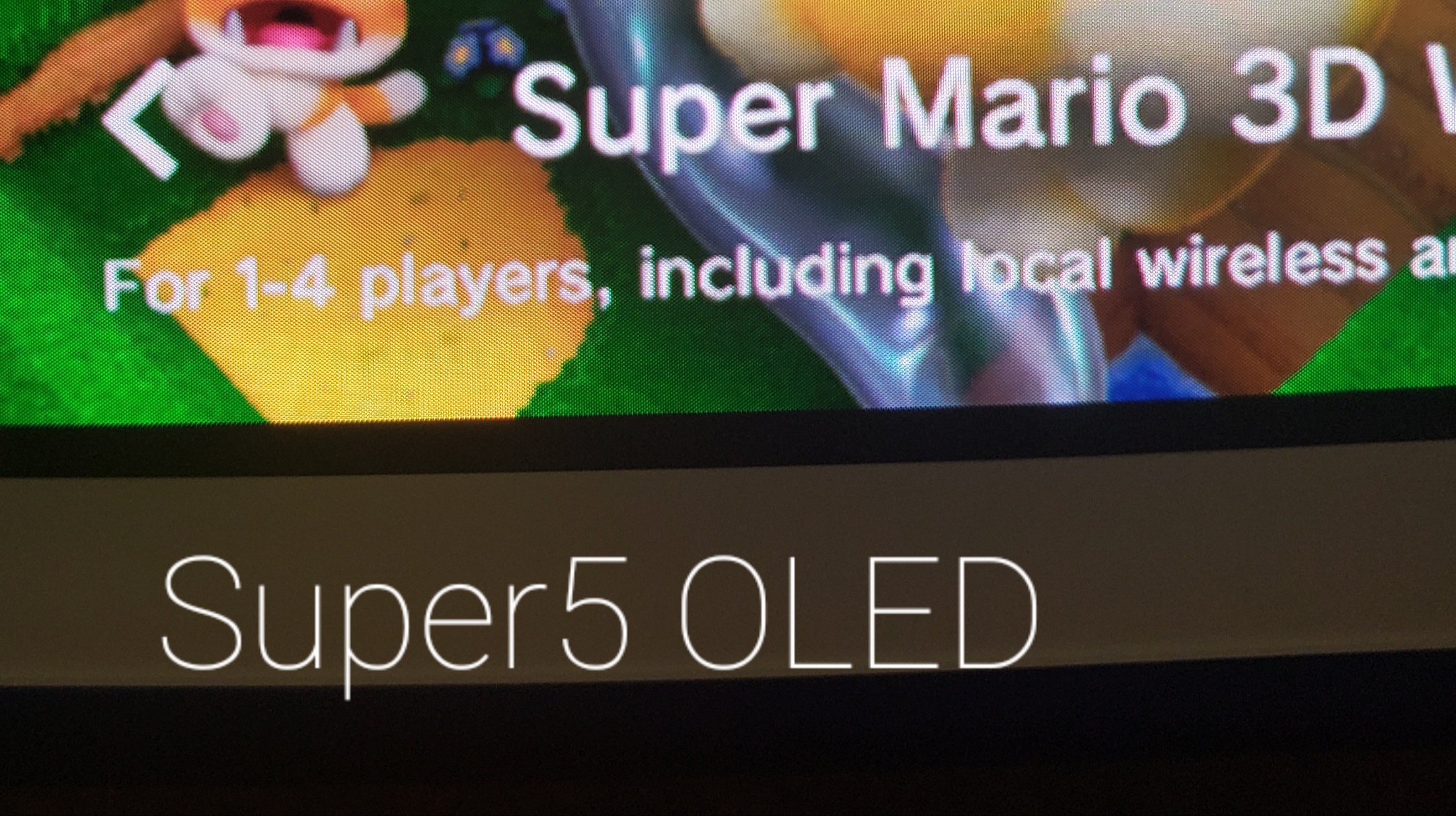

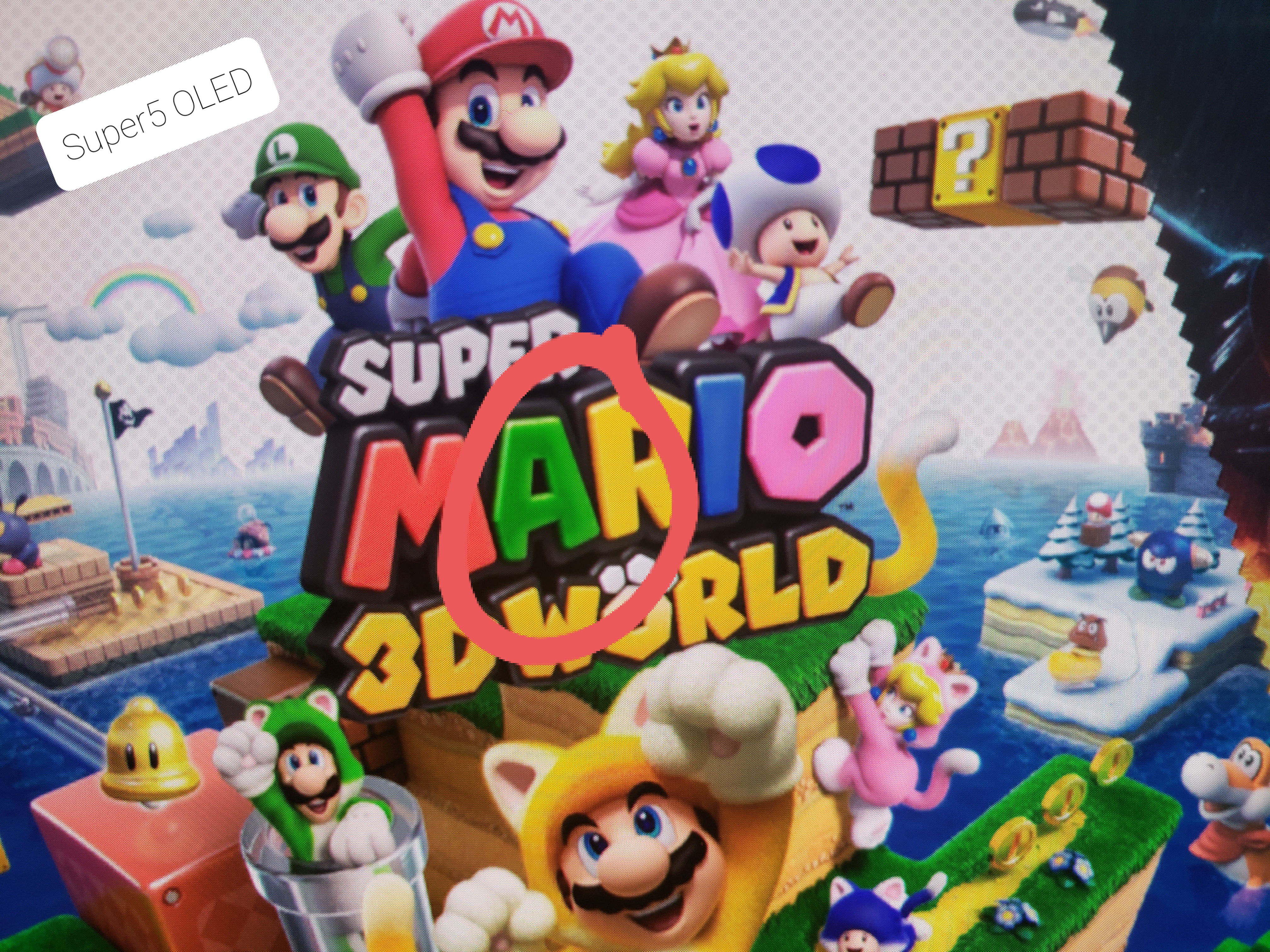

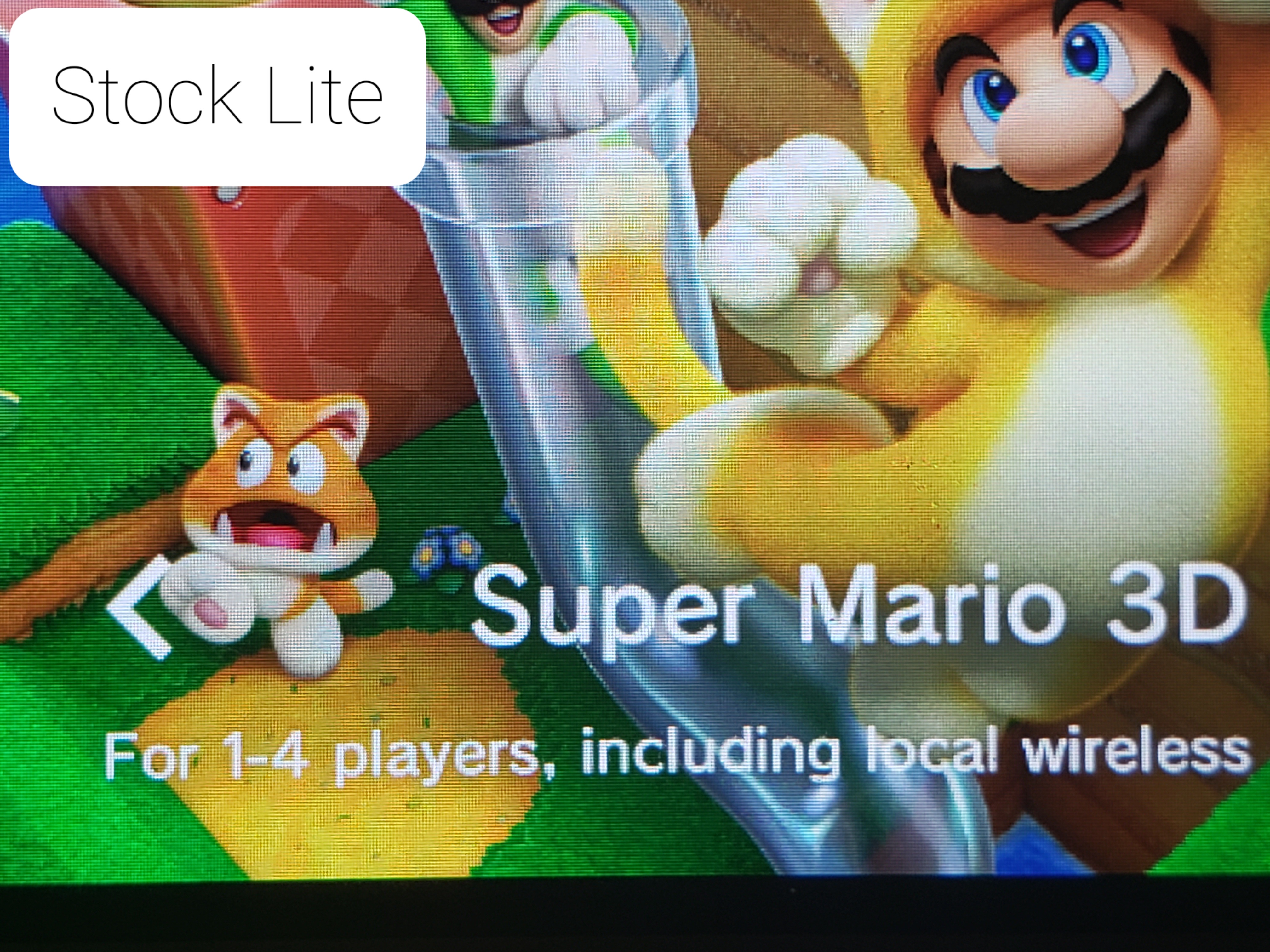

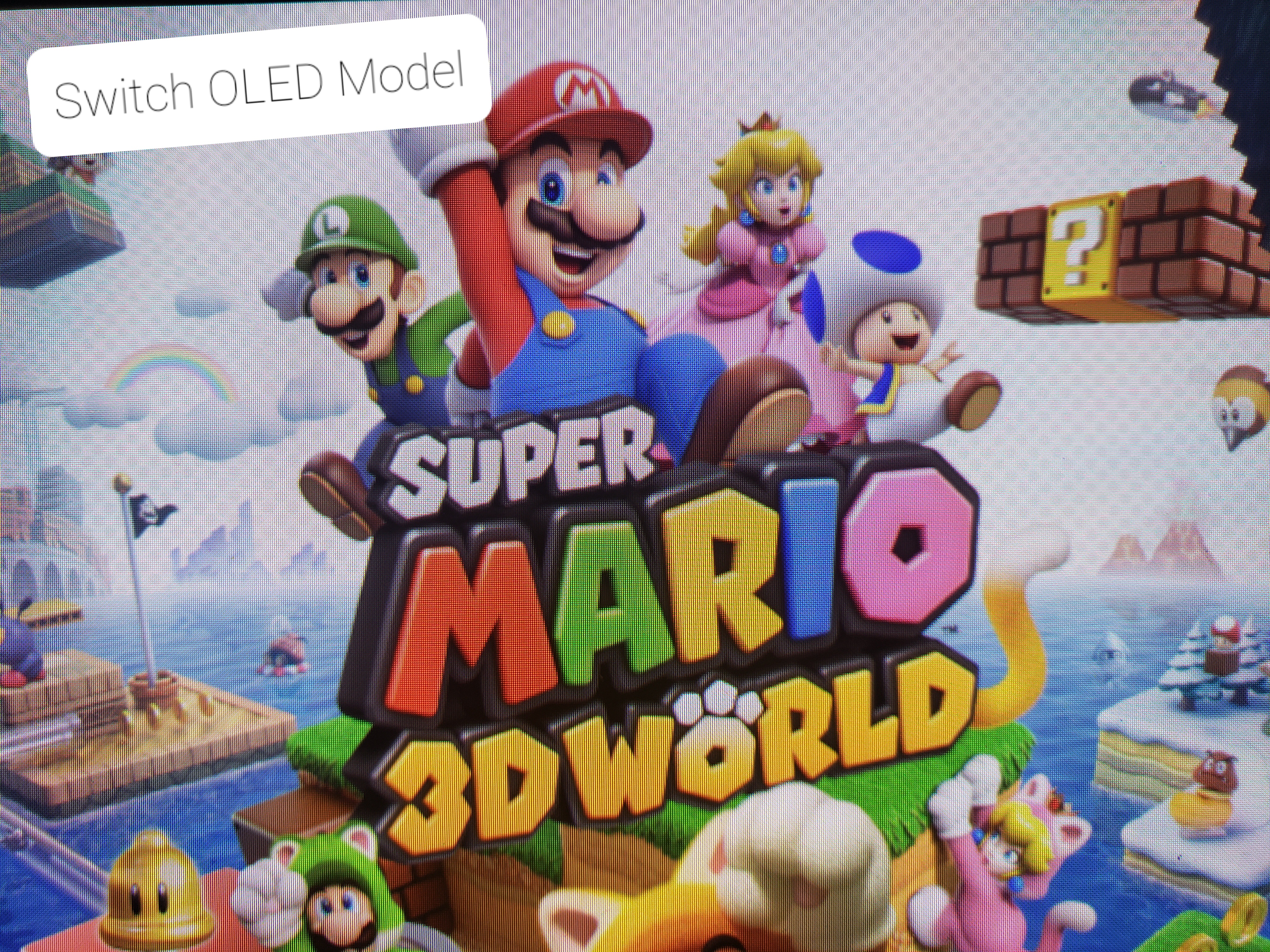

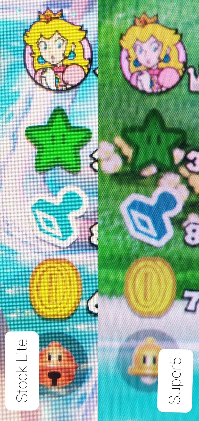

Long post with good news at the end:
It is pretty visible to my eyes, and is one of the first things I noticed after installing. It has been annoying me more each day. That and the strange colors even in sRGB on the Super5. I have two Switch Lites, one I put the standalone Super5 screen on and one that's a little beat up that I plan to put the Mega Kit with HDMI on.
It may be hard to notice or make you think you're just misremembering, but playing the stock screen for a couple hours and then going to the Super5 is shocking. It is blurry and it takes away from the image especially in native 720p stuff like first party games that normally look razor sharp.
I've attached a few pictures to give you a rough idea. Zoom in to see.
It looks like the Super5 pictures are out of focus, but I assure you they are in focus if you zoom in!! Check out the hud comparison above and the weird artifacting on the "A" below.
Text Comparison:
The colors look.. nice, the contrast is of course fantastic, the extra bightness is welcome, but it still looks off. I use sRGB mode on the Super5 and Standard mode (not Vivid) on my Switch OLED, and the Super5 doesn't hold up against the stock OLED at all except for being brighter. Much blurrier and less accurate colors. At a normal viewing distance it looks okay, but small details get garbled.
This being a 1080p panel wasn't noted anywhere on the site, in videos, or anywhere else. I asked on Twitter about this before seeing this thread, and was ignored likely because they don't want people to find out. Yet another thing that has really annoyed me about this whole project. The lack of communication and specifics is frustrating when this is by design a niche product for enthusiasts who will notice this sort of thing. I honestly prefer the sharper stock screen in some ways.

The difference wasn't obvious from the OP, but boy, that really looks awful. Also, it looks darker sometimes for some reason? (Notice how dark the green star looks on the OLED screen, or the stamp symbol)
I don't think the tradeoff is worth it personally just for better colors. But for HDMI out, maybe.
This can be just a camera auto thing, I wouldn't judge the colors based of them.

@notsu / @The Real Jdbye Please don't use my images to judge colors too much- It's a good rough idea but these are just phone photos and don't do a very good job representing color! The Super5's colors look nice, but inaccurate. They are definitely more vivid/less accurate than a Switch OLED in Standard mode; 'darker' as you stated (note the green grass). There is more color crush. I have heard this is because the Super5 is 150% sRGB which the system wasn't designed for, but that I really don't know anything about and can't confirm and don't want to spread misinfo lol
I moreso wanted to point out the difference in color definition between the Switch OLED and Super5 I guess. It fairly accurately shows that the colors are more saturated on the Super5 in sRGB, but doesn't do a great job comparing the two, since that's hard to do in photos.
Again, take these with a grain of salt since they are just photos, but the garbled-ness of the UI is true to how it looks in person, and I think the text comparison especially shows the issue in an honest way.
