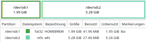

Partitioning the USB disk​
On Windows you can probably use Disk Management with HDDS. If DIsk Management won't work for you or you have Pen drive you can use a third party tool like Minitool Partition Wizard or Easeus, on Linux you can use gparted.
The general rules are: The partition Table needs to be MBR, not GPT. The first Partition (by number, not physical location) is either ignored or used as SD card (depending on which favor of the plugin you use). If you want to use it as SD card, it needs to be primary (not logical) and formatted FAT32. From the other primary partitions only ones with the NTFS (or exFAT) type will be considered. The phsically last one of those will be chosen and used as (wfs) USB storage.
You can either chose from scratch by deleting all partitions and start from scratch or resize an existing partition to make room.
An example setup would be:
two primary partitions on the USB Disk:
  1. FAT32 - (in gparted set lba flag). Here goes the vWii games and homebrew if you use the SD variant of the plugin.
  2. NTFS - This partition will be seen by the Wii U as "USB", you use to store the Wii U games on (don't assign a drive letter)
Instead of NTFS you can also use exFAT. NTFS won't be the file system the Wii U will be using, it is just there to tell the plugin which partition to use. The Wii U will later format it with it's own file system (wfs).

Could someone explain me how I get this to work? I have formated everything like explained.
Used Manjaro partition manager, first partition fat32 primary, second ntfs primary, everything mbr.
Putted the wafel_partition_sd to /sys/hax/ios_plugins shorted the name.
Copyed everything of my sd card to the fat32 partition. The HDD is pluged to the bottom USB port via a Y Cable.
But there is no loading of the hdd. Just starts without loading my aroma files. Tryed 3 different HDDs with different sizes.
What do I wrong?
You have ISFShax already setup? And you copied it to the SLC and not the SD?
